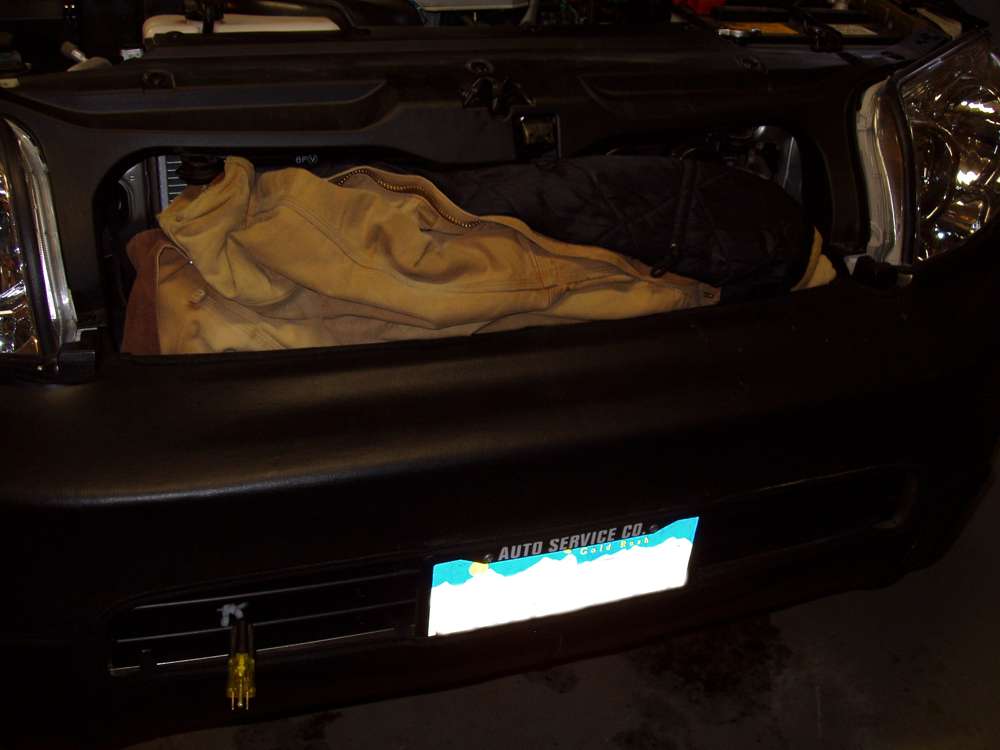

The first pic showing my "emergency" radiator shield. A coat I put under the hood the day my radiator froze.

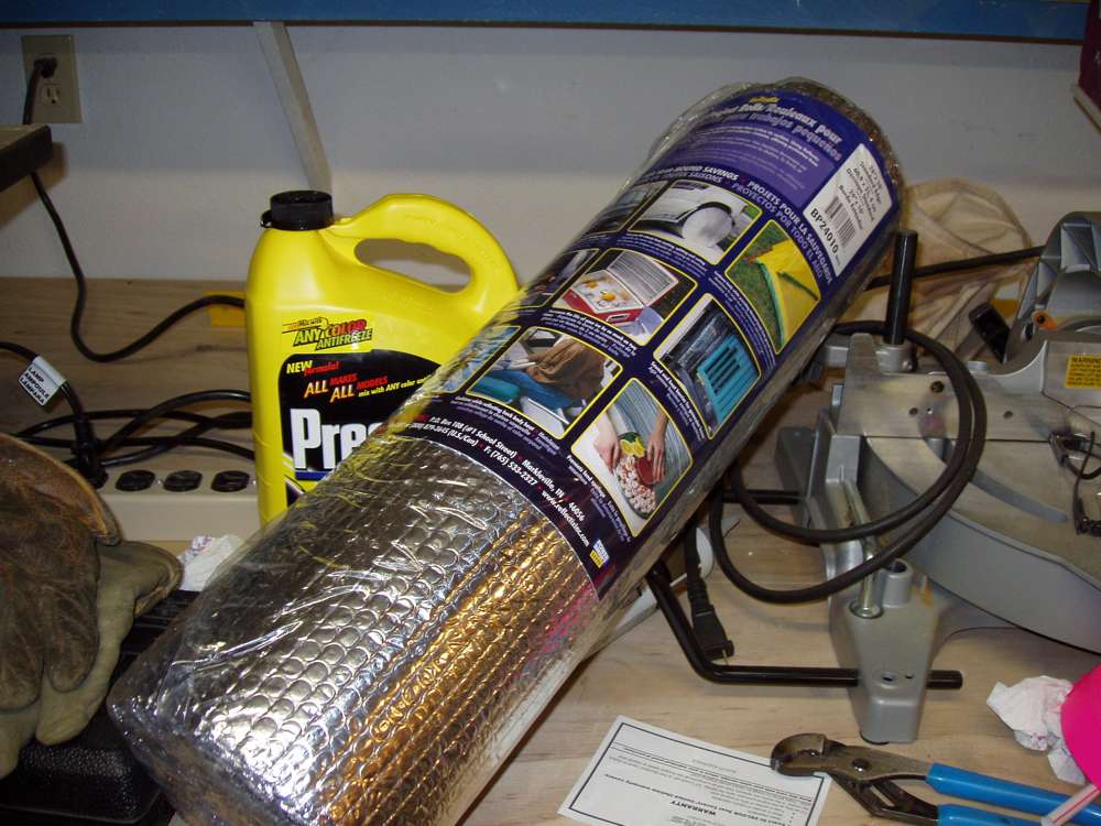

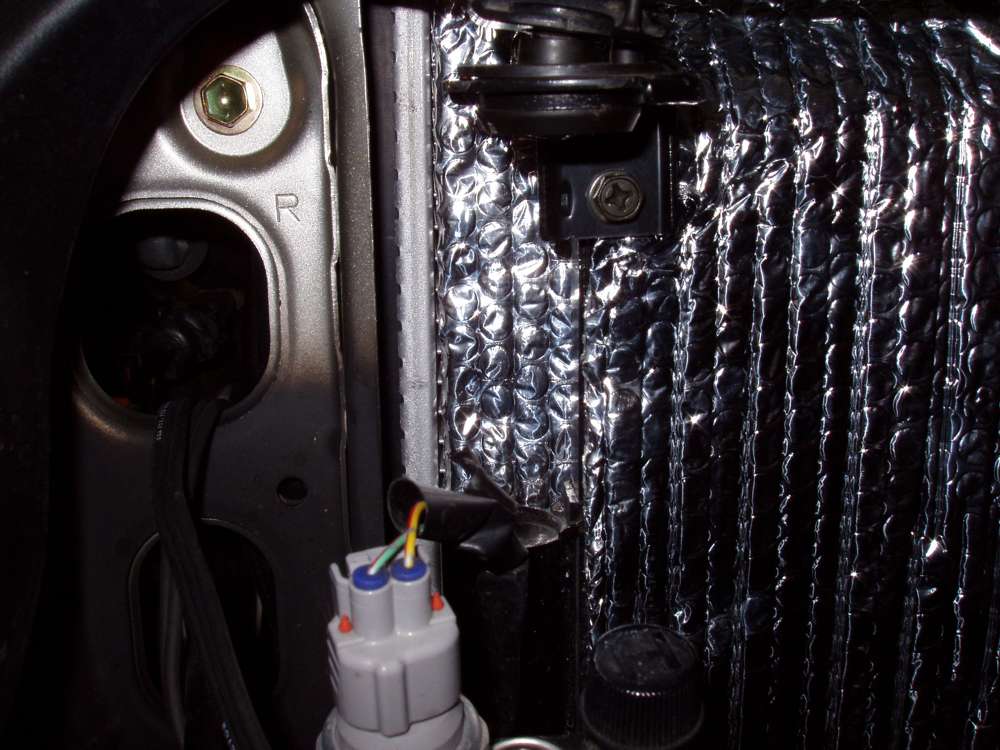

Here is the product I used to shield the radiator. It's called reflectix, bubble wrap with thin aluminum foil bonded on each side.

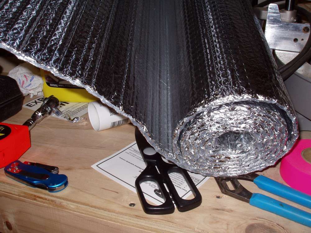

Here's another picture of it. This roll cost me $10 at Home Depot. I only used a 2' wide by 1.5' tall piece, and a little extra for small places.

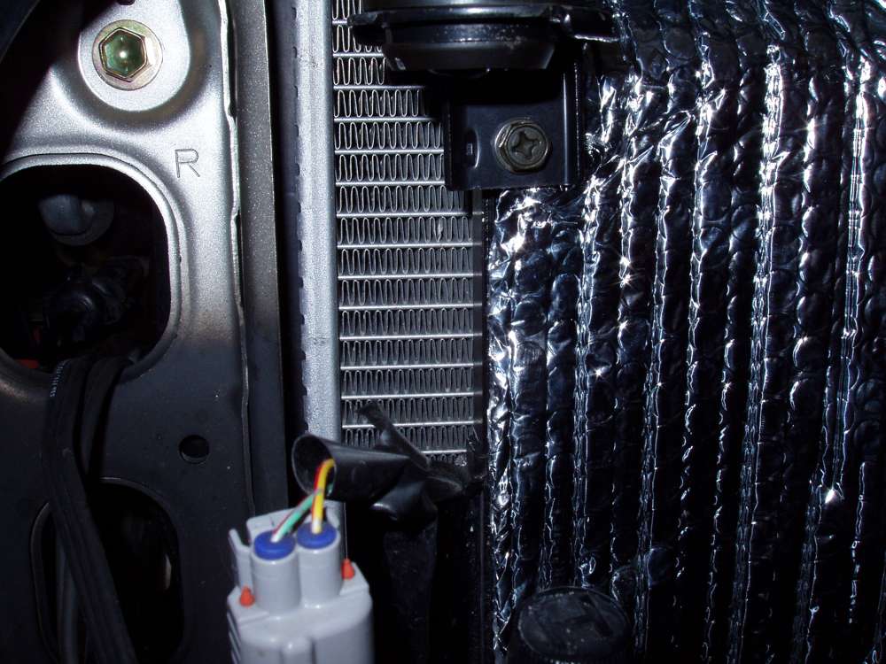

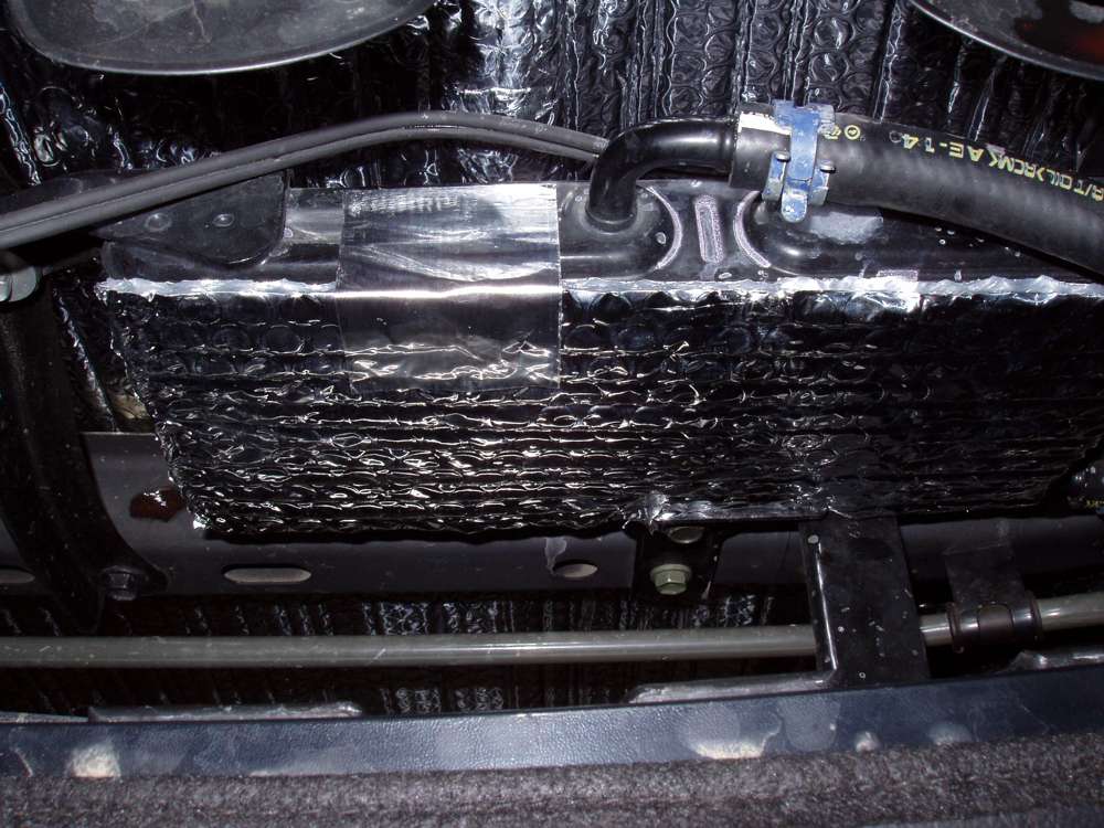

Here's a close up of the left side showing a small, hard to get to place. The main 2'x1.5' piece I slid up from the bottom, right against the radiator.

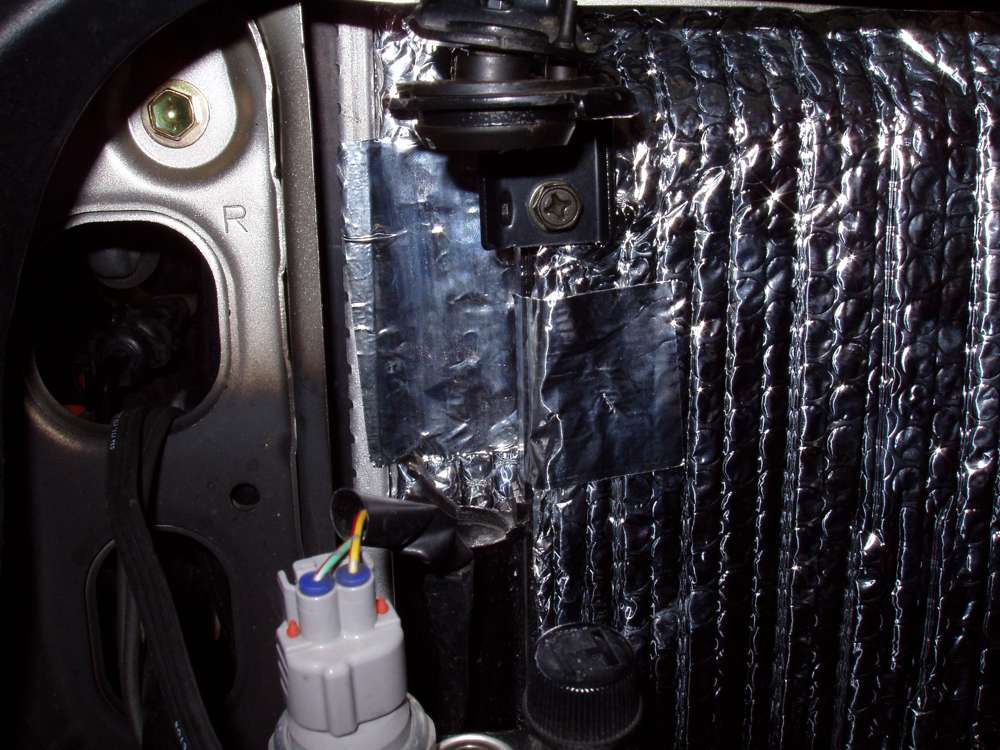

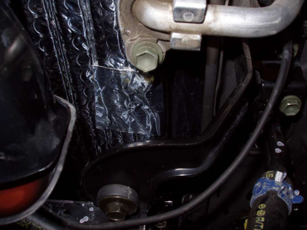

Same area as above but with a 3 inch by 1.5 foot piece in that tough to get to place (far left).
Same area again, but with some foil tape to keep it in place.

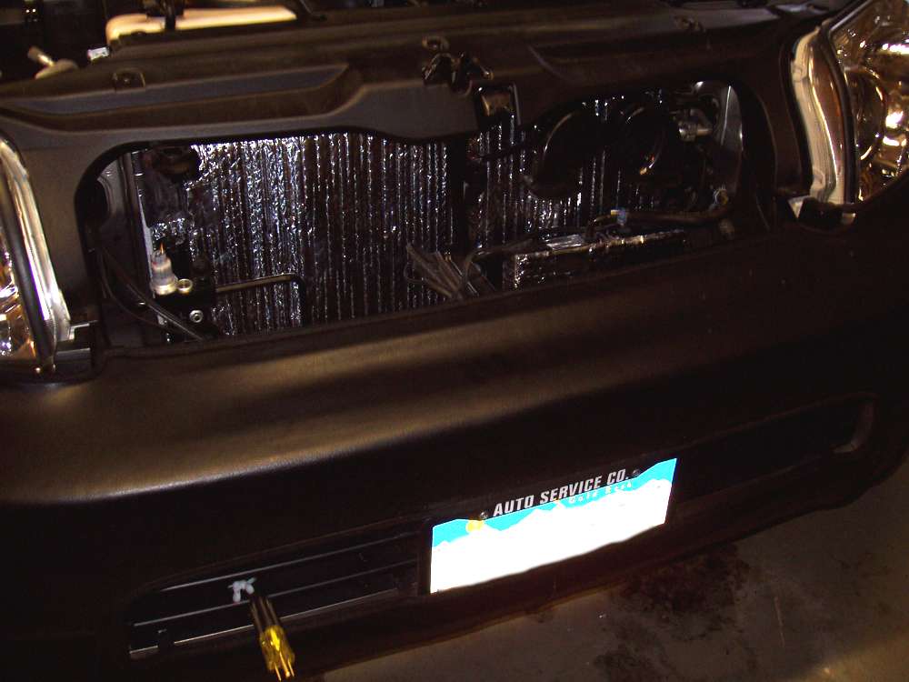

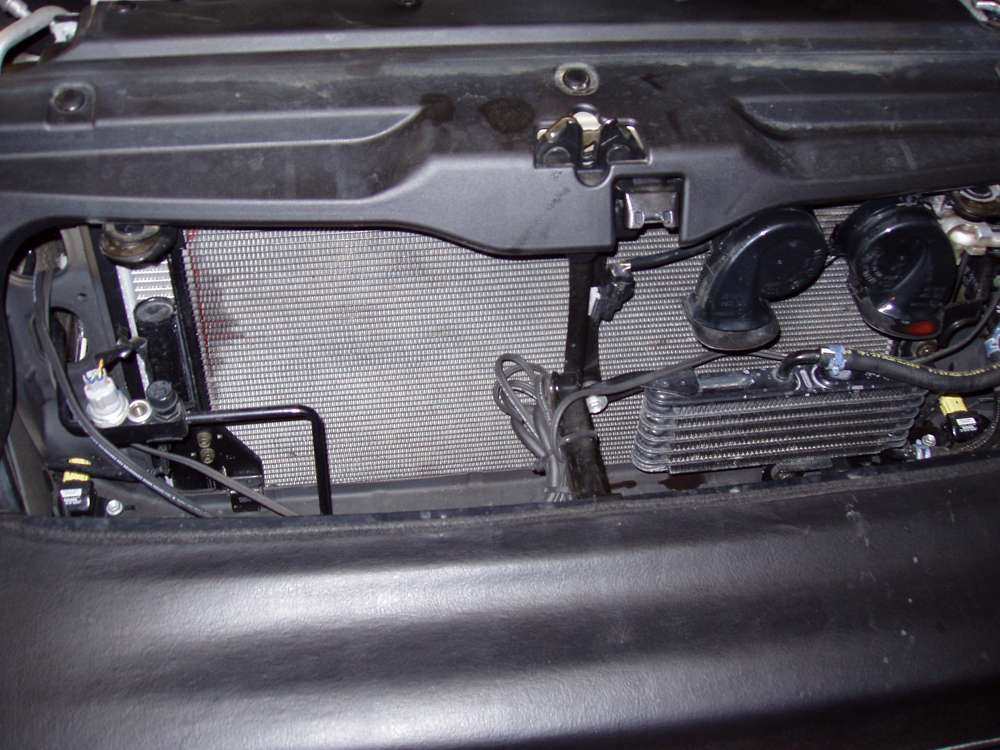

ALL DONE! I did test it at 5F, and the temp gauge was normal (just a little below middle). Note that I left about 6" at the bottom of the radiator exposed, so that I don't overheat.

Very good demonstartion of how to and what to shield your radiator with. Just a quick question, what does that plug hanging out of your fender near the license plate do?
Engine block heater?
Very inventive Carina! You get the Macgyver award of the week! :arrow:
Yeah, Hmmmmm, I don't think I'll be needing one of those anytime soon here in SoCal where it is 75 and sunny on the same day that you applied and tested your heat shield....
Maybe though, I can put that stuff on my roof to keep the CIA and Martians from listening in on my thoughts and trying to control me!:bash:
sharp4runr is right, it goes to my engine block heater. It also goes to my oil pan heater and battery heater. I intend to replace the battery heater with an under-the-hood trickle charger, which I like better.
