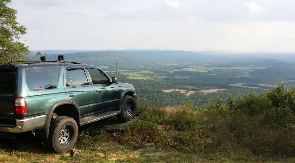

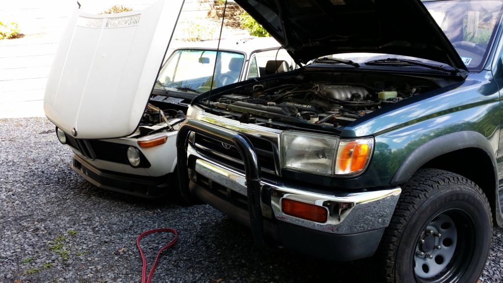

Obligatory picture
The 4runner with my '73 2002
