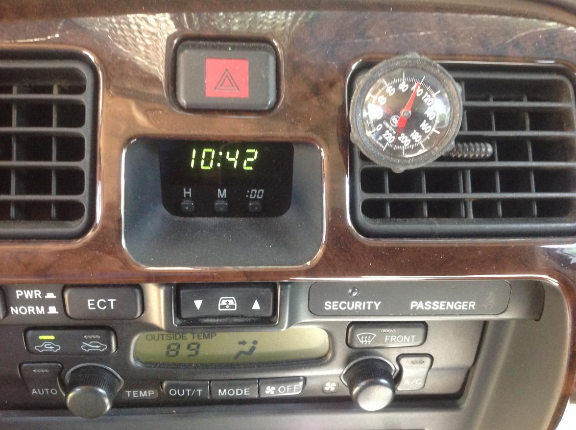

We all know that many (but not all) 3rd gens came from factory without a way to view the outside temperature. This mod will allow you to add a digital thermometer that won't look out of place in the interior.
The result

I think the result is worth the messy fuse box:
