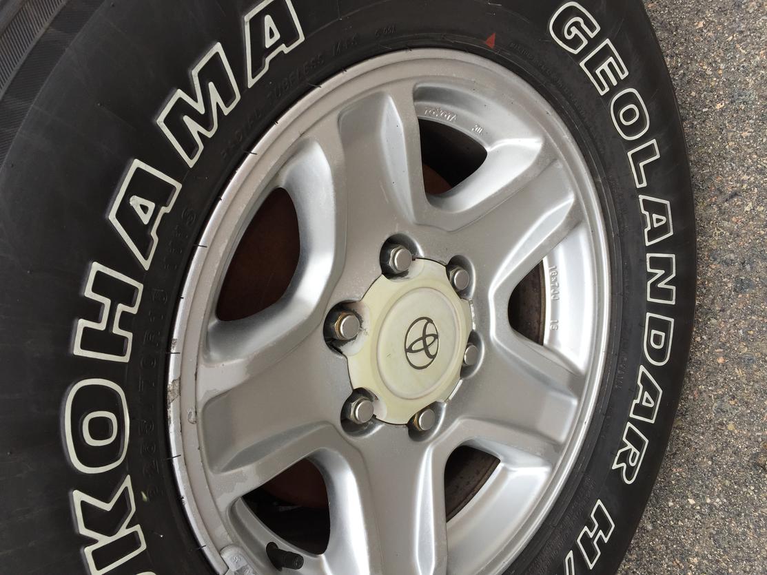

2) The wheels are cool, minus the weird center cap. It looks like they tried to paint it or something? Any ideas? Can I order new ones for cheap? Otherwise I'll paint them.

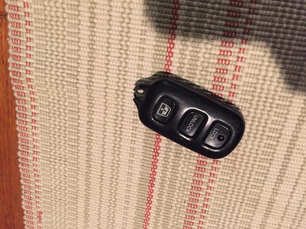

3) Any thoughts on how to fix this?

2. You will get addicted to this so you will most liking get new tires and wheels. So until that time comes, I would just paint them.
3. Should be able to get a new one off eBay and there's a way to program it somewhere on here. Others can point where or search for it.
