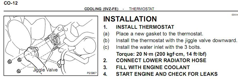

Thanks for all the help guys. Probably gonna try and get it in next weekend. So as far as the tensioner goes, since I am replacing it I should just have to bolt the new one on and pull the pin right? And what exactly is a thermostat jiggle valve? Lastly, Diagram14, your comment confuses me. If I have everything lined up correctly, why wouldn't the belt marks line up after I rotated the crank? Again, I'm completely new to all of this stuff, but it seems to me if you rotate the crank 720° then everything should line up again? Am I completely off on that one?

Jiggle valve...
Here ya go
