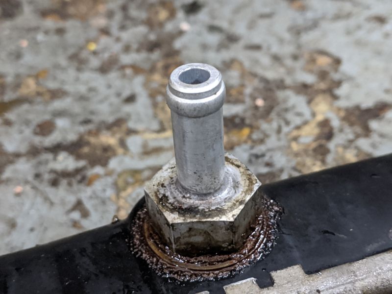

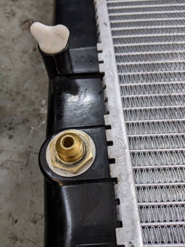

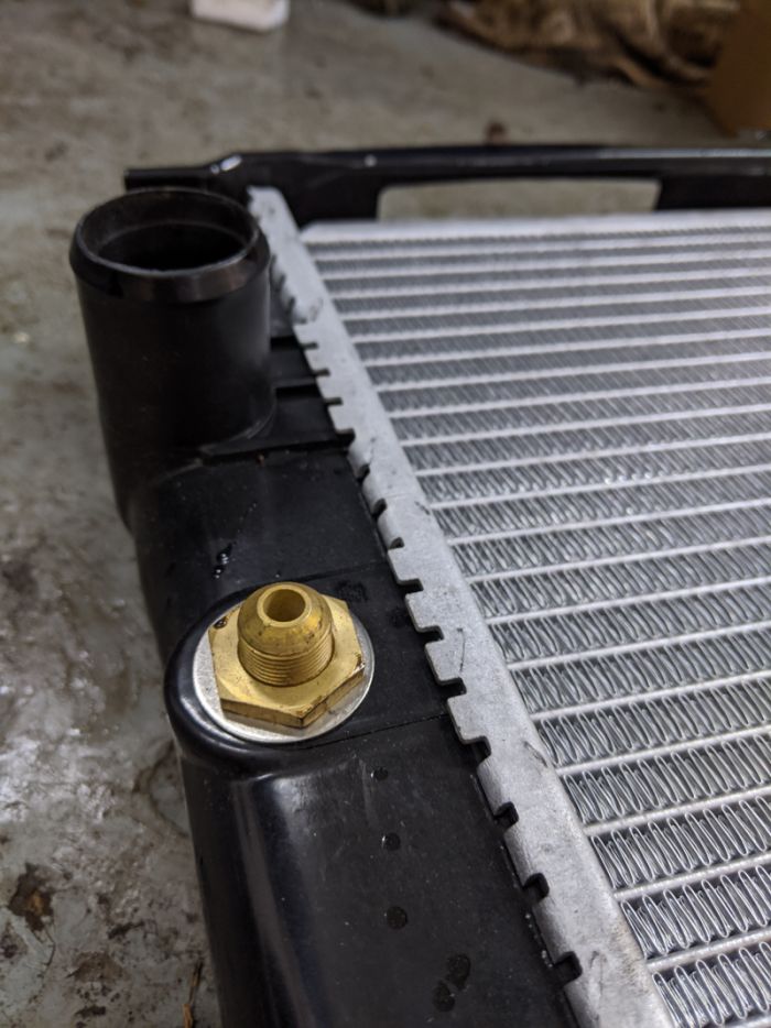

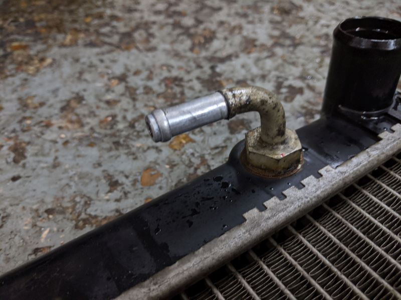

Update: got the Nissen to my garage, and apparently the automatic transmission connection doesn't match... looks like it'll be fun.
Confirmed: the automatic transmission cooler connections won't match mine (see picture below). Is that something I can fix with some sort of adapters or does it need an entirely different model?

If I was you I would install an aftermarket transmission fluid cooler and bypass the radiator
It is quite an ordeal to get a matching part for this car in the UK, and I'm still just trying to figure out if I have a blown head gasket, so I'm not entirely sure I should invest in more parts before even getting there?
Good point. If you are just trying to get it to where you can drive it some (not far or for long) you could use a piece of metal pipe to loop the transmission cooler lines together. Just a thought if you are in a pinch
I'm mainly trying to start a pressure test (short use indeed), but overall it's better not doing the same job twice, so I'll probably just return that part and find another one, hoping for the best.
