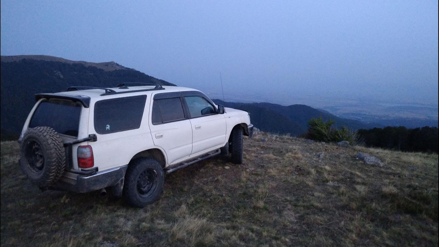

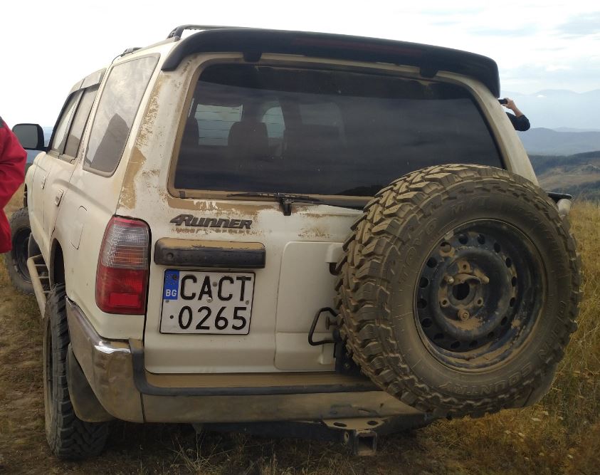

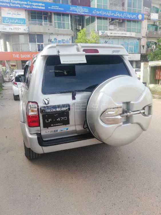

Since I upgraded my back door with one from a Surf because of the tire carrier, and used the same old pistons, I realized that the Surf back door is quite heavier than the 4Runners original back door, due to the spoiler with a reverse mirror at the top (although later I went with the wide LED stop light spoiler instead, see attached pics), a lock plate for the carrier, and a bigger handle garnish and a separate license plate light bezel.
The original pistons can't hold the door up during warm days, talk about cold ones!
I plan on ordering the 35040 pistons with hopes that they will perform way better in the upcoming winter.
If you want new pistons for your US 4Runners, I recommend the 35040s as they will probably hold better and longer than any of the other part numbers when new.

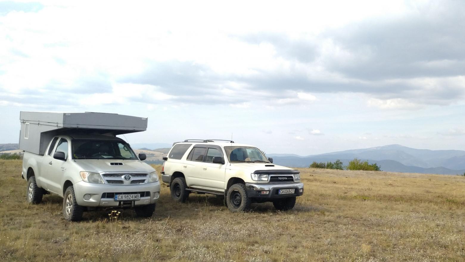

My 4runner is the white one in the pics, with the OEM wide LED stop lamp spoiler. The other is for reference to see the size and imagine the added weight of the reverse mirror spoiler.
Anyway here are some pics of the last trip we did in the Middle Mountains here on the Balkans...
