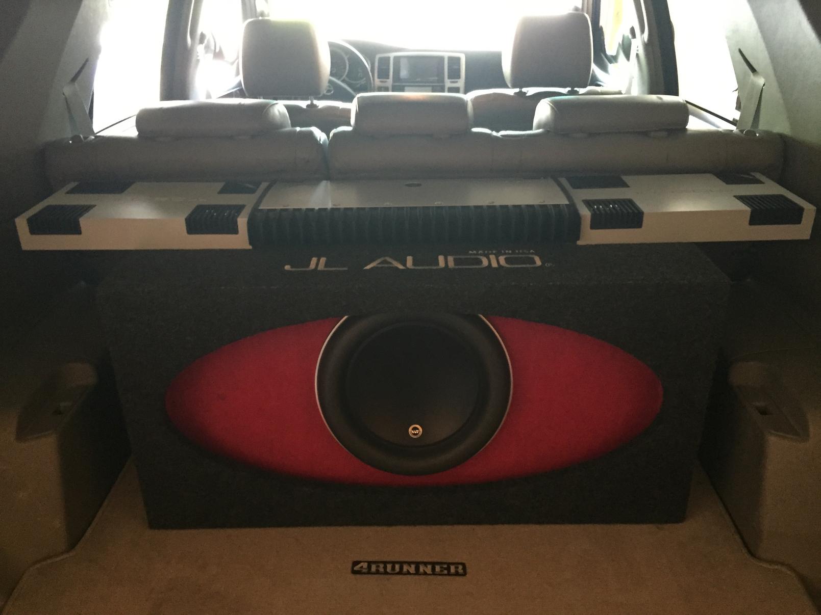

I don't think you could get this much power in a tighter setup than this. The sub box and amps are below the top of the rear seats and there's plenty of room in the trunk for gear. Highly recommend the JL HO box. I've had it for a few years and it's the perfect fit. Also have space on each side of it between the box and wheel wells for jumper cables, ropes, etc.
If you're ok with sacrificing bass, you could go without the sub and box just mount the door speaker amps to the back of the rear seats

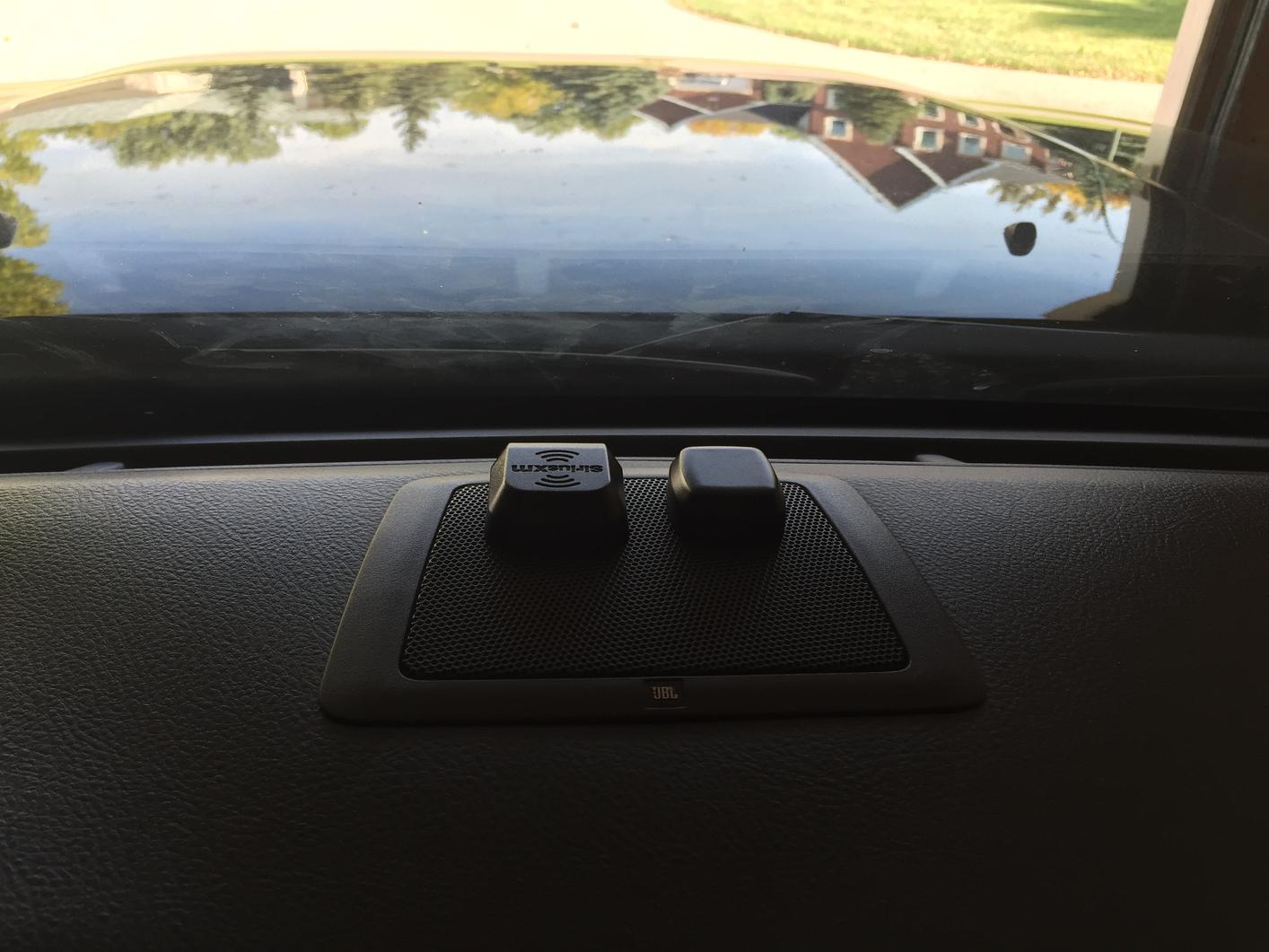

good job on the parts, have you thought about popping out the center speaker and hide the external antenna there? also did you do the big 3 upgrade? time for a mechman high output alternator and a extra battery in the future, i do use the 240a and dual battery in my setup.. do the mosconi amp fit under the front seat? also how well is the metra aswc? i had to scrap that and use idatalink maestro sw, it seems to be better, no more no response when i push some buttons.
Yea the centre speaker has already been pulled out. I don't mind having the antennas there on top. They're magnet and stick to the metal speaker grille well.

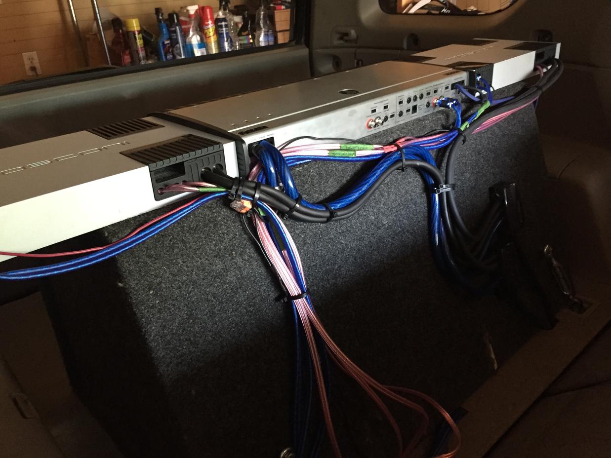

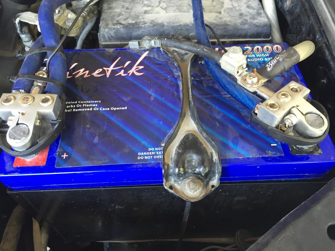

Big 3 upgrade was done a long time ago. I don't think I'll need an extra battery. The numbers even at peak output are ok for the battery size that I have in there.
I imagine a Mosconi 200.2 would fit under the seat, they're compact amps. I didn't want to start introducing power dist blocks half way into my two 1/0 runs that are under the drivers side floor moulding. I prefer to have everything in one place for cleaner wiring.

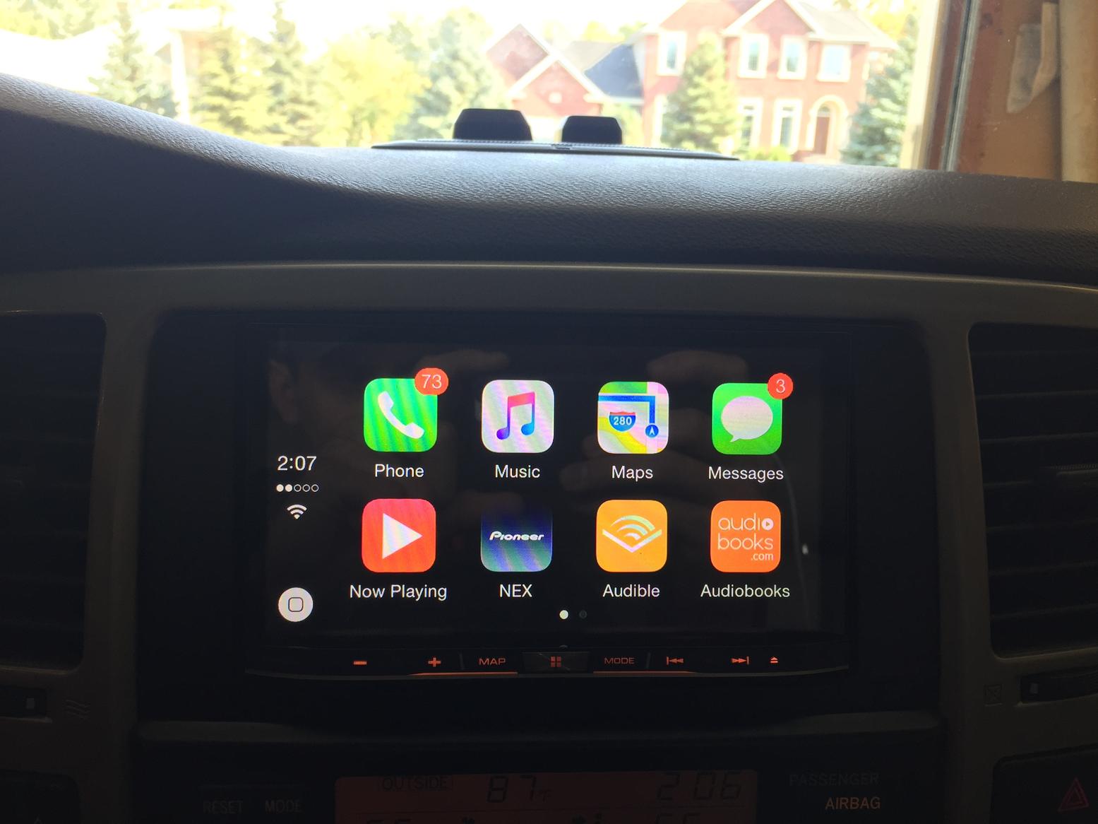

The ASWC is hit and miss actually. You had better results with the idatalink? I thought that one was for vehicles with temp settings etc built into the stock radio.
