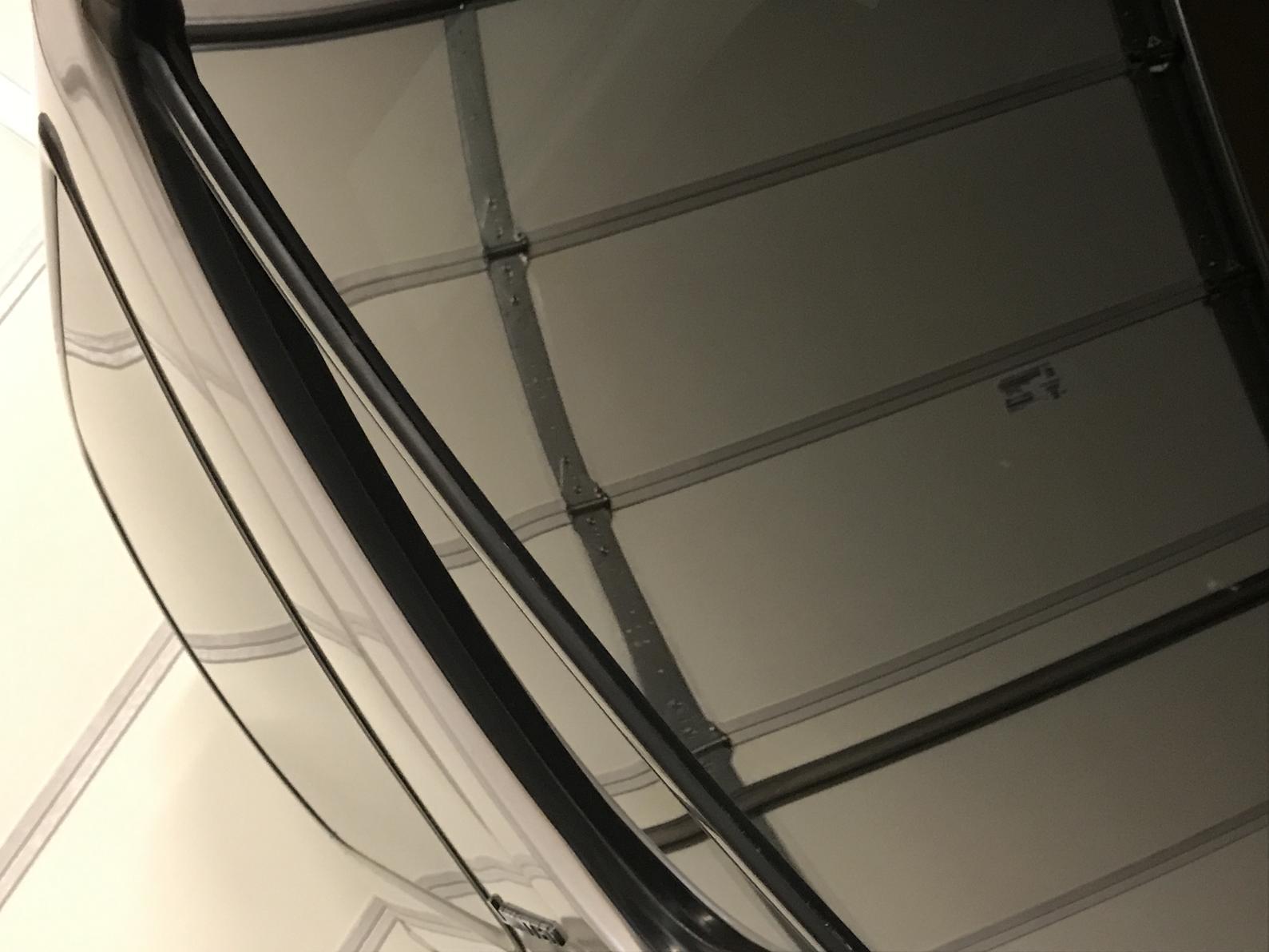

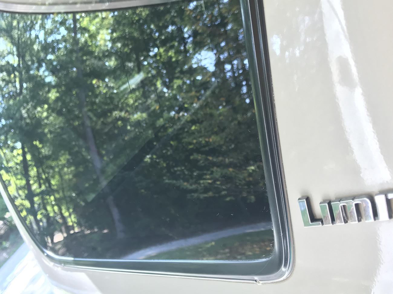

So I've had a rediculous amount of acid rain on all of my glass for as long as Ove had my runner and tried numerous times to get it off with no luck. Today I'm happy to report I got all of it off in about 2 hours. I used 3m compound, orange chemical guys hex pad, and my Harbor Freight orbital buffer. I first used setting 1 to spread the compound and gen setting 6 with a good amount of pressure and got it all off. Got the corners with some 0000 steel wool and the same compound and it came out great! I just need to find some sealant to keep it looking this good and I'll be set! Here's the final product:

Man that looks awesome! I just spent an ungodly amount of time running a clay bar (2.5 hours for rear hatch alone) and now all I see is how bad my glass is.

Thanks! Yeah, I've done all that with no luck. I started yesterday with just the compound and steel wool which worked but took forever. On a whim this morning I whipped out the buffer. It really did all the work. I wasn't going to try it because several months ago I tried the same compound with a drill attachment buffing pad that didn't even make a noticeable difference. I think the key to it working his time was the orange pad and a higher speed buffer. I just ordered the Griots sealant and will try that out to keep the spots away for good.
