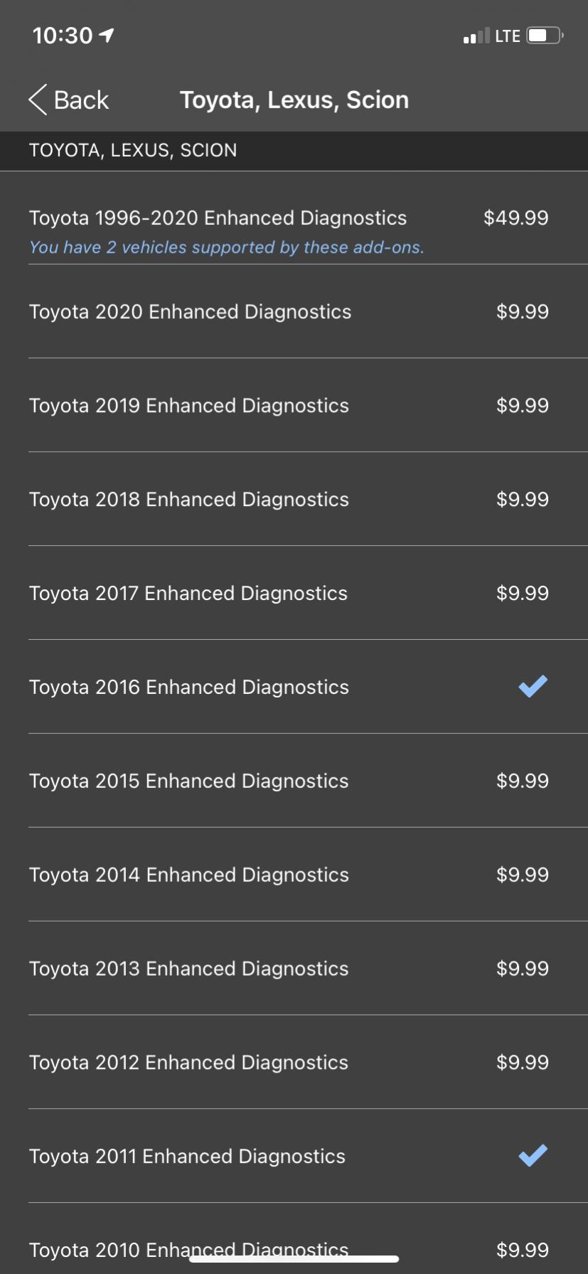

Your setup looked way easier than using my old laptop with TechStream but that Toyota enhancement is an $80 add-on. Is that what is needed on top of the OBD Fusion app ($10) and Carista Dongle ($27) to pull Transmission temps?

The enhanced diagnostics is an OBD Fusion in app purchase for $10, I bought it for my 2011 4Runner and my 2016 Highlander.
