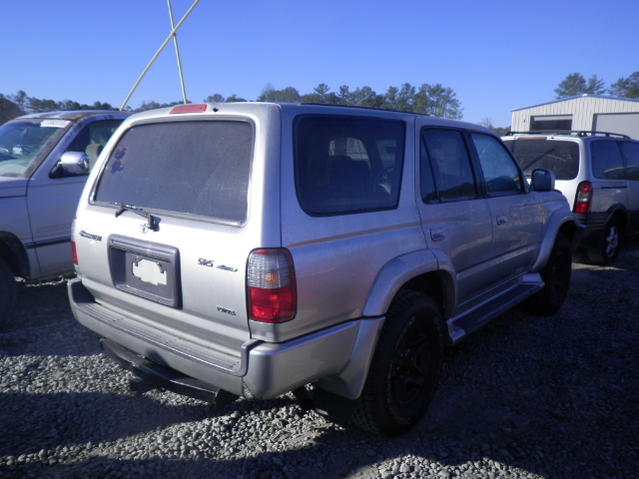

?3.Doe’s this T4R appear to be a Toyota trailer hitch(see attached image)?
If yes what class is it?
None of the 3rd gen 4runners came with a factory installed hitch. They were dealer installed. The one pictured looks to be a REESE hitch. This is what is on mine. It will handle the tow capacity of the 4runner just fine.

The hitch pictured is a class III hitch, with a 2" square opening for the ball mount. They are generally rated for 5 or 6 thousand pounds, far more than Toyota intended for a Gen 3.

couple more ?s for right now
1.could this 2000 silver 4x4 possiabley be a 4runner sport (first highlander)?
2. notice the gap inbetween the back bumper and the back fender should this gap be this size it appears to be a tad big, I'm thinking there should be no gap at all?
3.doe's the front grill attach to the hood like on the Rav4's.?

1. It could.
2. If you think there should be NO gap, you should be looking at a Lexus. I think you should go look at a few of these in person so you get an idea what you are talking about. That gap looks very normal.
3. No
