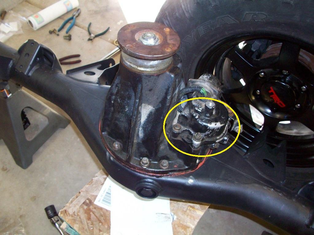

So if I see this piece (circled) on the 3rd member there will be a switch on the dash
For E lock?will there be a E locker on front and rear diff.? Doe’s this switch have any safety precautions to prevent it from accidentally turning on?

Actually no it has nothing to do with the hubs. It locks the differential. Just google a differential lock, its easier than trying to explain what one is.

Yes that object is the Locker actuator.

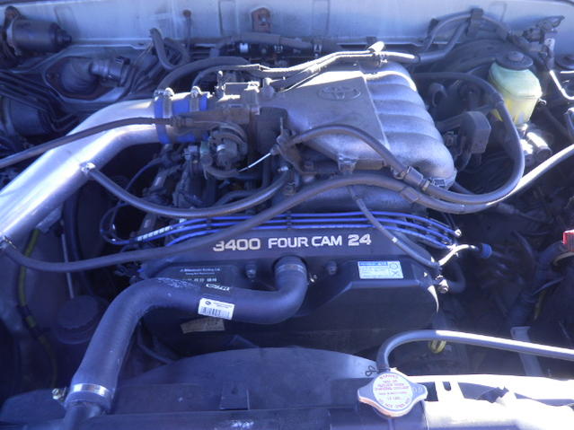

I just read that AC airconditioning is optionale w/ the 3rd gen so doe's this engine appear to have a AC compressor?

The air compressor is on the bottom of the passenger side of the engine below the power steering pump. That looks to be one of the metal AC hard lines behind the PS reservoir in the picture.
when you say that looks to be one of the metal AC lines should there normalley be two metal lines?
