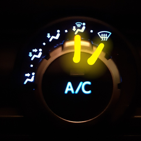

That's the way I have heard the defroster works....BUT you can find out for sure by opening the hood and checking if the AC compressor comes on when someone turns on the defroster and fan.
Tested this with a look under the hood.
It is exactly as tennen described. As soon as you turn the selector switch to one of the two positions with windshield, the air conditioning compressor engages and turns. In this case, the ac lamp is off. It comes only on when you turn the temperature knob to full cold or press the AC Button.
Because the foot-and-windshield position was my favorite position, i had condensation under the car all the time. Must be getting used to foot+head ventilation i think :thumb3:
