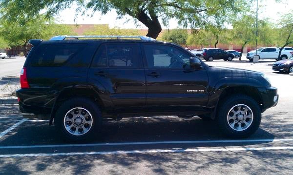

FJ Springs all around and 5100's front set at 1.75. No Spacers.:drummer:
