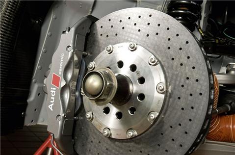

just cause you wanta look cool like this,
doesnt mean your gonna be able to stop like
there read this What Kind of Rotors Should I Get?
