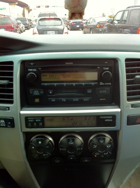

Is there any way to to connect my iphone to my 4R? I'm going on a holiday roadtrip and i would love to listen to Pandora through the 4R's speakers.

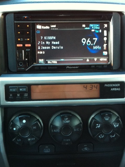

I love Pandora and i needed a way to hear it in my 4R so i recently went to Best Buy and bought a new touch screen stereo with blue tooth and a USB connector for my iPhone. I am very satisfied with the install and the performance. Blue tooth is a very nice thing to have but Pandora just rocks. Now i can use mapquest and listen to Pandora at the same time. The stereo also plays DVDs and will stream movies from my iphone as well. Its pretty nice.
