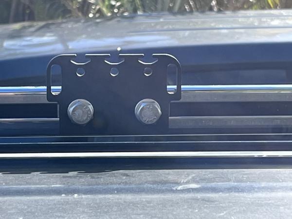

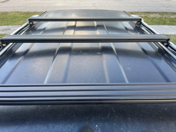

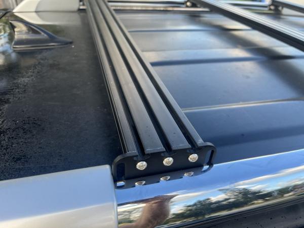

We have had a RoofNest Condor Overland for a couple of years.
It's an all aluminum shell and weighs 160 lbs and another 300 to 400 sleeping weight. No effect on the truck at all.
It's mounted on 3 bars similar to the Nise rack, but one I made up myself.
There is absolutely no issue with weight or mounting or driving with it. It may look intimidating but the twisties at speed are not an issue. Just drive as we normally would.
It has been mounted since last January since it is a pain to take on and off which we did for the first year.
Noise only heard at above 75mph and mileage dropped 1 mpg.
The only real downside, since this model is a foldout, is that once setup you cannot move. Setup and teardown with all the awnings etc is still only a few minutes.
Here is the modified rack
Can easily handle the weight.
Mounted to the factory rails with 13mm bolts

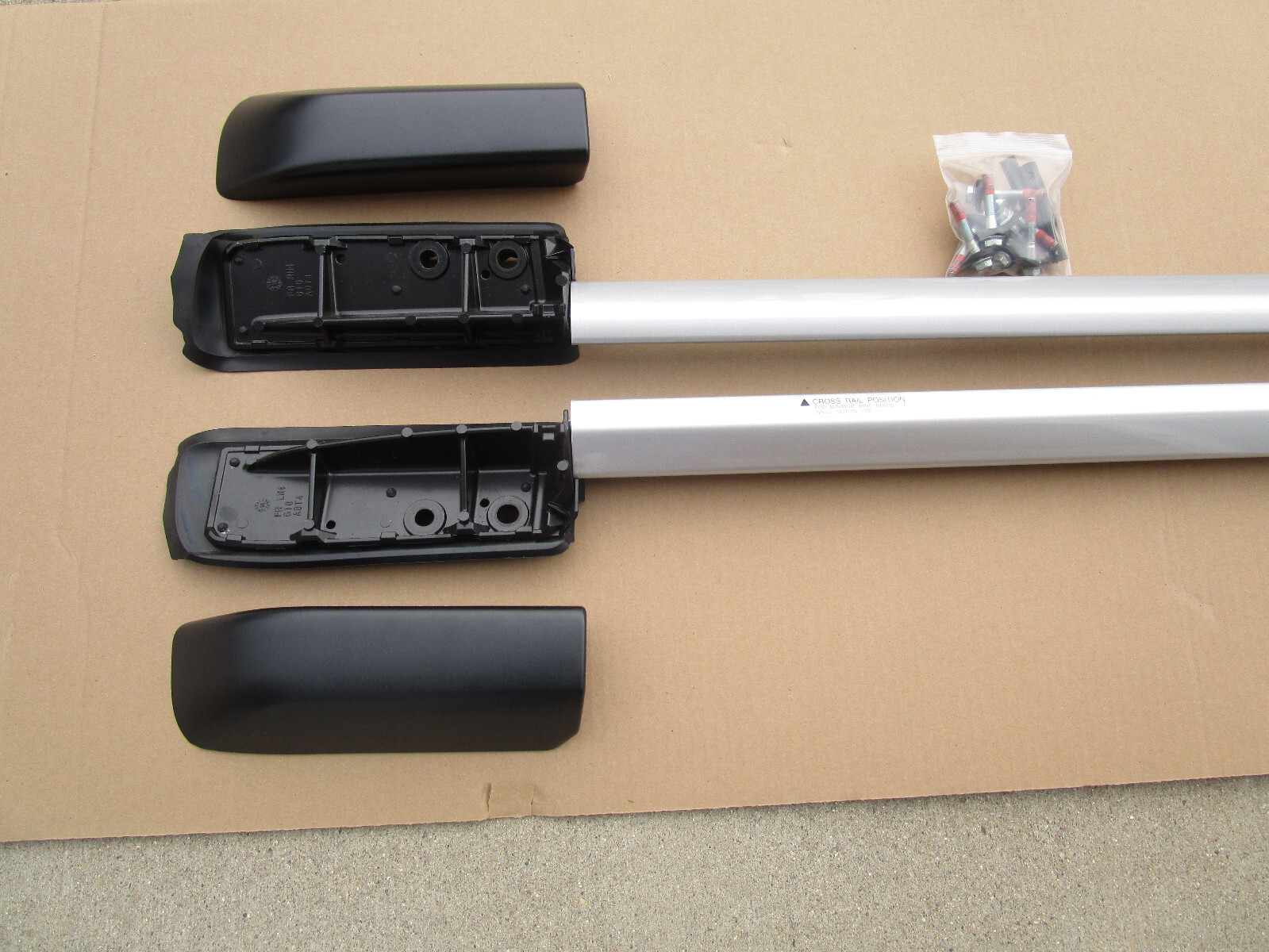

I know this is almost a year after the fact, but the factory roof rails aren't the strongest. The weak point is the plastic base, the part that actually bolts into the roof. If you upgrade to an all metal roof rack, they will be much stronger than the OEM rails.

The Oem rails are NOT mounted on plastic, those are just the trim covers.
The actual mounts are a strong metal.

The OEM rail bases are definitely just hard plastic bases with a plastic trim cover over them. I remember very well when I removed them to put my SSO rack on too.
https://i.ebayimg.com/images/g/we0AAOSwpD1kuZTu/s-l1600.jpg

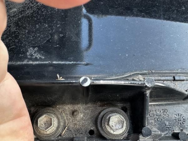

The OEM rail bases are without doubt metal, and from the looks of it, some sort of alum alloy casting.
Toyota has gone beyond to add a beautiful black finish which may be confusing to the untrained eye.
The purpose here on this forum, I presume, is to exchange as acurate information as possible, especially when readers are trying to make decisions, sometimes expensive ones.
Corrections should and need not be construed as insults. lol
Nonetheless, here is a pic of my rail base to which I took a file to the top removing the black paint exposing the aluminum material.
