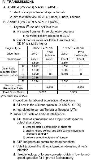

What is the first gear ratio difference between the 4 and 5 speed auto?
I don't see how drag racing is relevant to daily use. Roads aren't flat, last longer than a 1/4 mile, and most people drive with cargo frequently.
Maybe somone who has owned both transmission has something to offer?

The 5 speed won't accelerate faster, or get better MPG 100% of the time. Besides, there is no way to prove otherwise on the Internet.
Toyota said the 5 speed is a "good combination of acceleration & economy." I'm assuming their statement is in reference to the 4 speed, and not a rhetorical statement. Argue with Toyota is you don't like what they have to say.
I don't think Toyota/Lexus would choose the 5 speed as the future and only automatic truck transmission just for marketing purposes.
Clearly you can see that first gear is lower and the final gear ratio is higher. Which will give more torque from the start and will rev lower at highway speeds. It even has a lower reverse gear.
