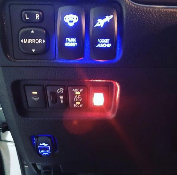

Just throwing this out there but, If I needed to relocate it I would consider using the USB I installed to the lower left of the steering wheel. I think it might have cost about $10 on Amazon IIRC?

In the center console under the radio is a knock out with the aux audio port. I pooped that out and just let it lay behind the console. I added a cable and a round audio jack and I drilled and mounted it next to the knock out.
Then I ran a wire from the battery (fused) through the firewall to to a dual usb socket that fits the knock out.
I can still use the aux audio if needed and I have an always on set of usb ports to keep my crap charged.

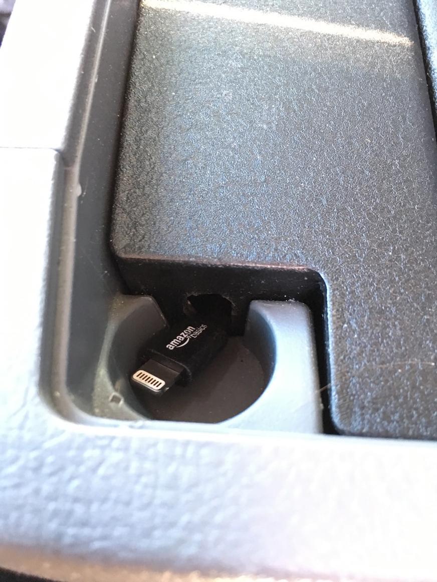

I ignore the ports in my console vault...... I'll try to snap a picture later today.
You can do something simple like this to keep functionality.
I cut a slot when the coin holder is.
