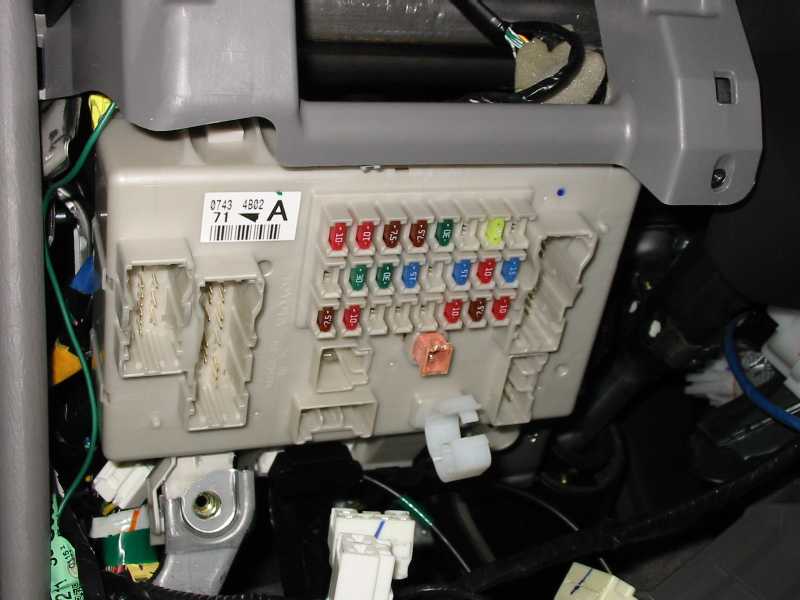

2) Remove the driver's side lower dash cover panel (2 bolts.)

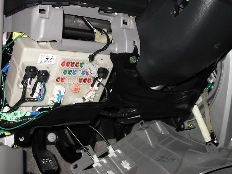

3) Remove black metal brace below steering column (2 bolts.)
4) Remove wiring harnesses from front of fuse junction block.

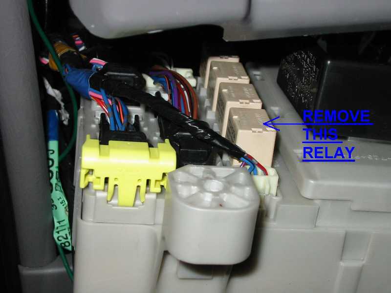

5) Remove 2 nuts and 1 bolt holding unit to framework.
6) Tilt and adjust forward to expose relays on back of junction block.
7) Remove other wiring harnesses to make room to work (optional.)

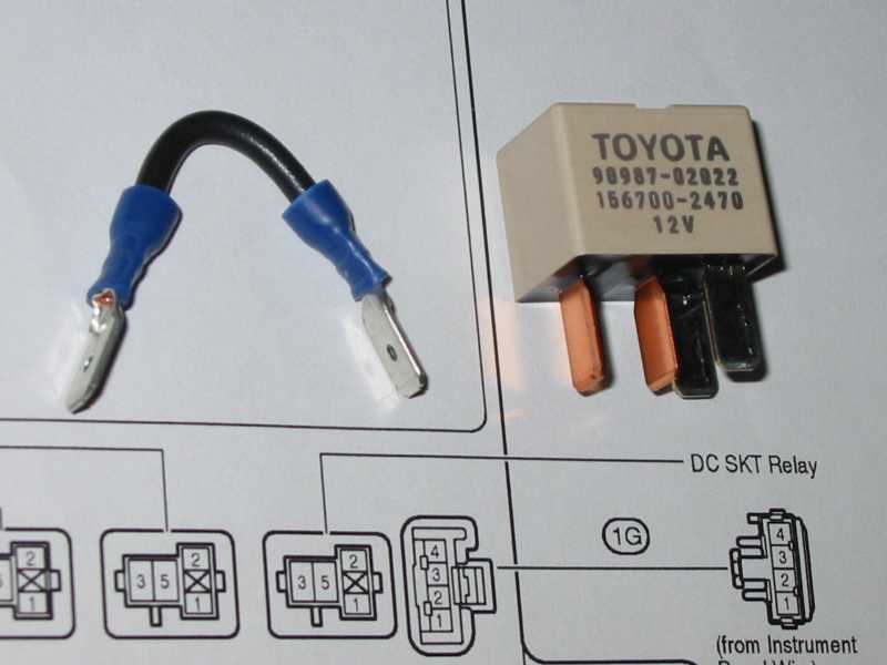

8) Remove DC SKT relay (closest to you.)
9) Construct jumper wire.

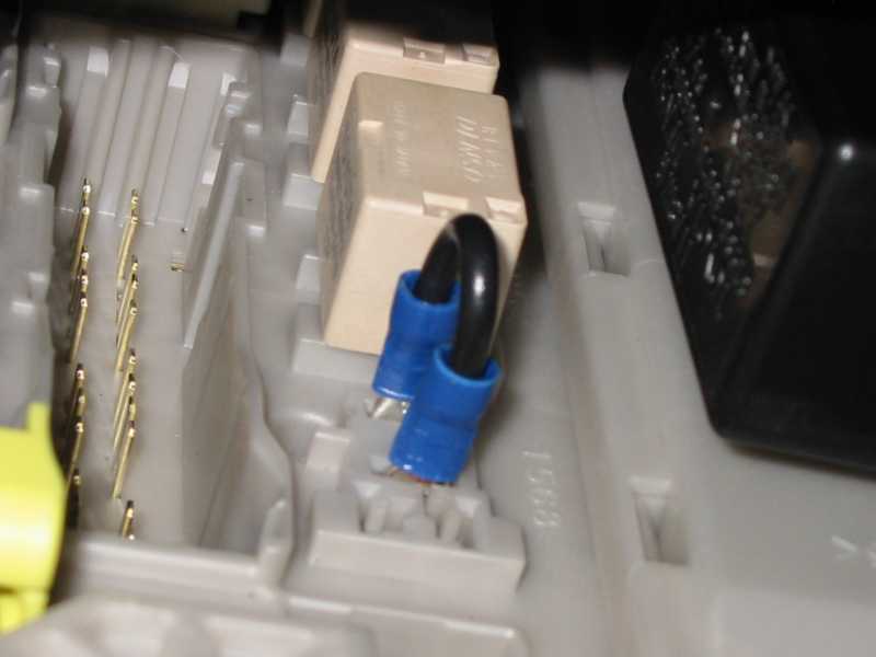

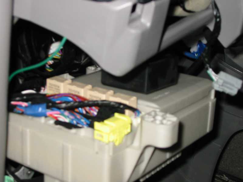

10) Insert jumper from pins #3 to #5 (same location as copper blades on relay.) This bypasses the ignition/accessory circuit.
Last but not least put everything back the way you found it. The result is 1 spare relay... Oh yeah, now I have constant power to keep the liquids cool!
