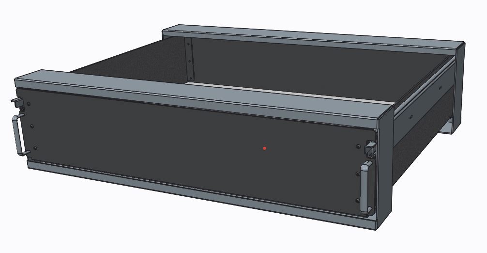

UPDATE: I took the advice of Trekboxx and modified my design to provide support to the plywood top. Can't have that sagging with gear on top. I also deleted the locks. I just don't see the point.
This re-design requires me to do a small amount of TIG welding, which isn't a big deal, but I will probably make the base frame from steel and the drawer from Aluminum now.

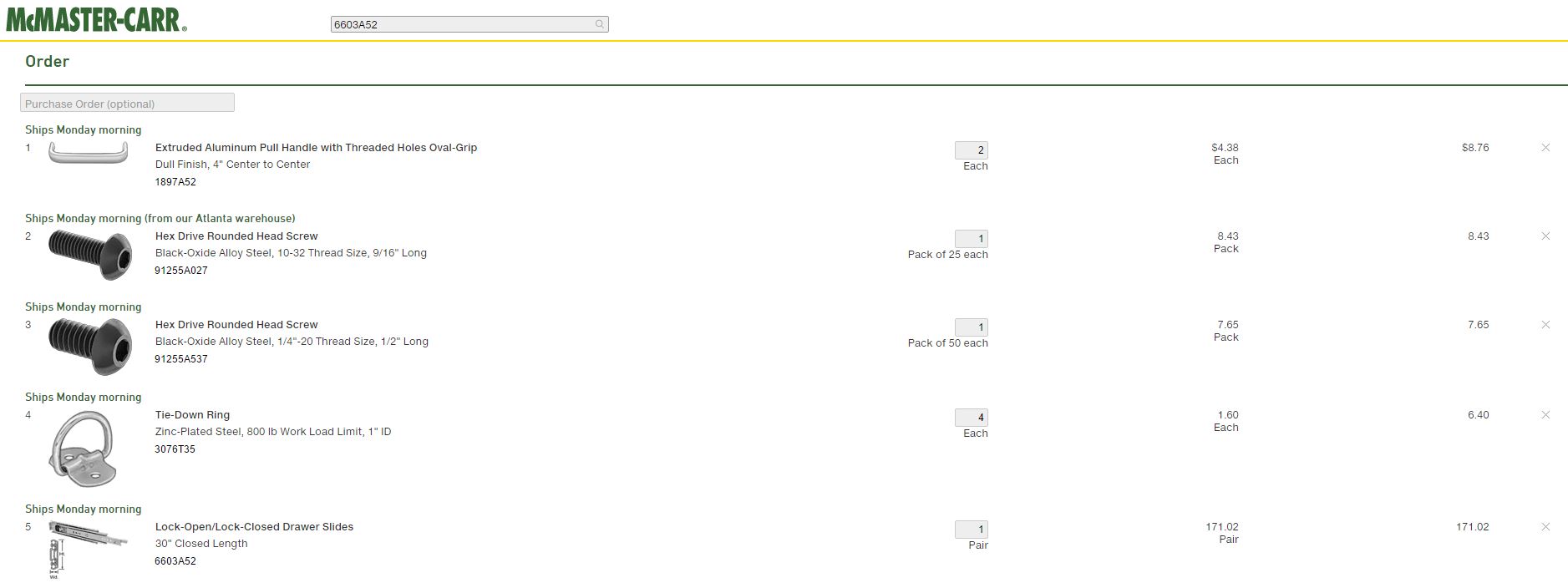

Right now the parts list stands at ~$200

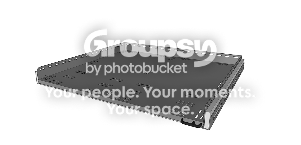

I have actually been working on a concept and was considering offering it for sale to people on this forum. Fact of the matter is, I am going to generate all of the CAD and detailed drawings to make my own anyways... this isn't going to be built "Free-Hand." So if I can turn a small $50 or so profit for the time it takes to order these from my shop, pack and ship... then it will give a lot of people a more economical option to building their own simple drawer setup. Of course it is nowhere near as feature laden as some of the other options out there, but I would argue that a simple drawer is more useful, and it should be able to be built for a 1/3 of the cost.
Anyhow,
The idea would be that I would produce the sheetmetal components and sell those along with a parts list for the slides, latches and hardware. In addition, I would provide large paper templates, printed on a plotter, for the pieces of plywood that would need to be cut. Someone could buy my kit, which ships in a small and relatively light weight package, and assemble it with the parts in my list and cut out the drawer bottom and top using a jig saw and some plywood from their local hardware store.
I would use 3/16" Aluminum Plate, PEM style insert nuts, 500lb capacity drawer slides and locking paddle latches. The drawer top would be cut to precisely fit the contour of the rear cargo area.
Still working on how I will secure it to the cargo area, my thoughts right now are provide holes for attaching D-rings that can be used to strap it down to the existing tie downs. I think asking people to pull up their trim and carpet and bolt it to the floor will be going too far for some.
What do ya'll think?

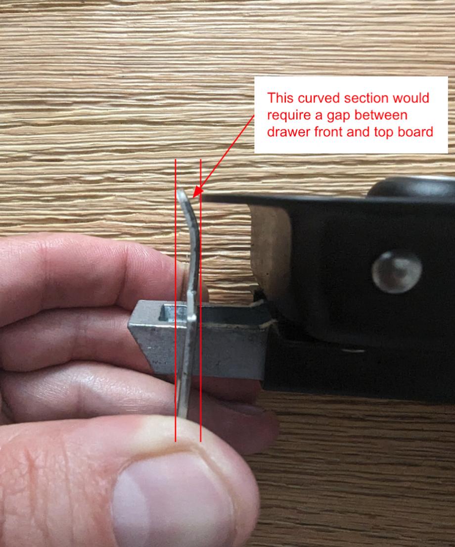

I like the idea. I’m curious though what you used for a catch for the paddle latch? From what I’ve seen online there appears to be two different approaches for this that most people use: (1.) using a 90-degree mending brace that hangs down from the top and catches the paddle latch, and (2.) cutting a notch into the top board where the paddle latch can live when it's not engaged (similar to the way a door lock fits into a door jam). Which approach did you take? Can you share some photos? Thanks.

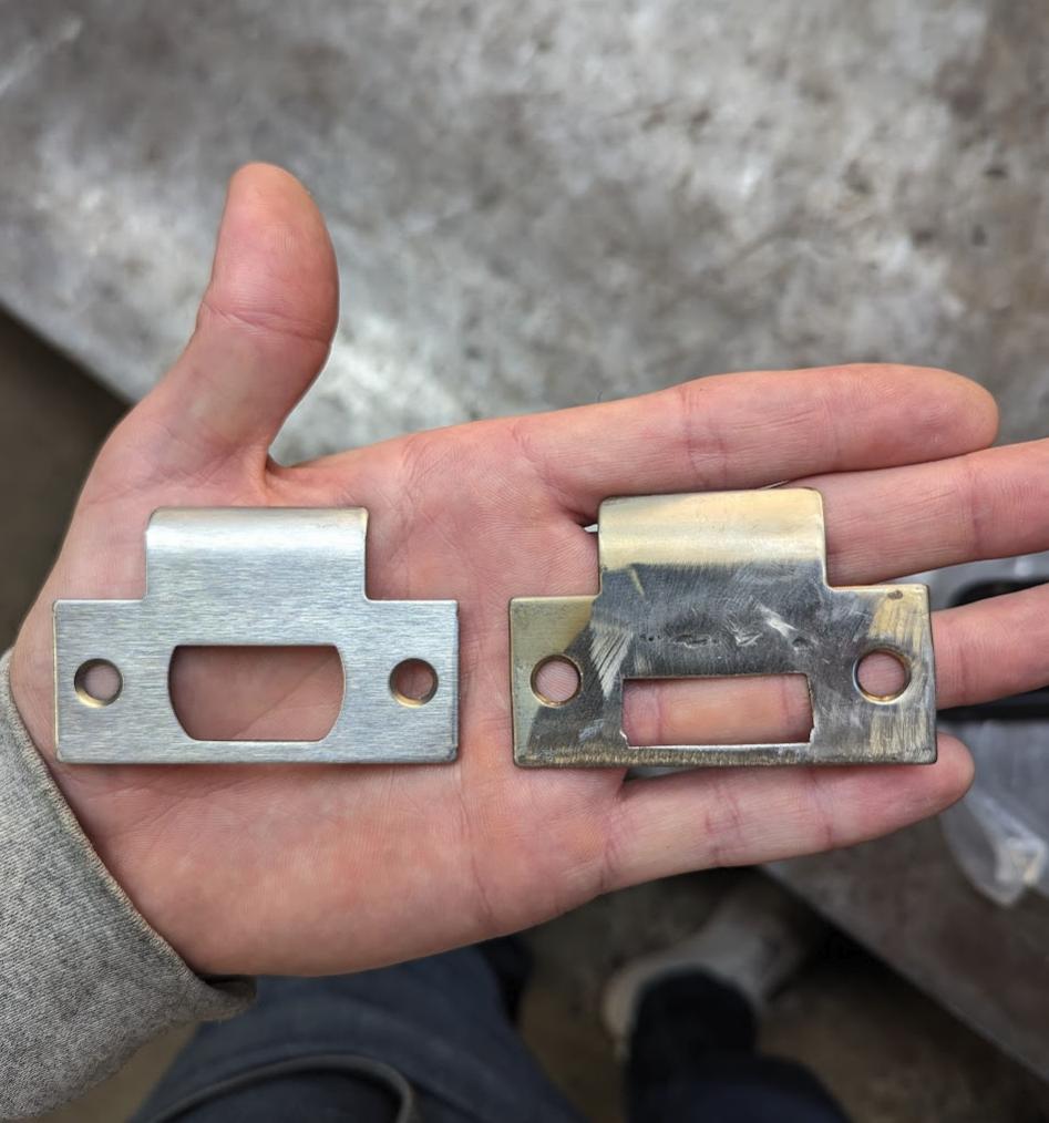

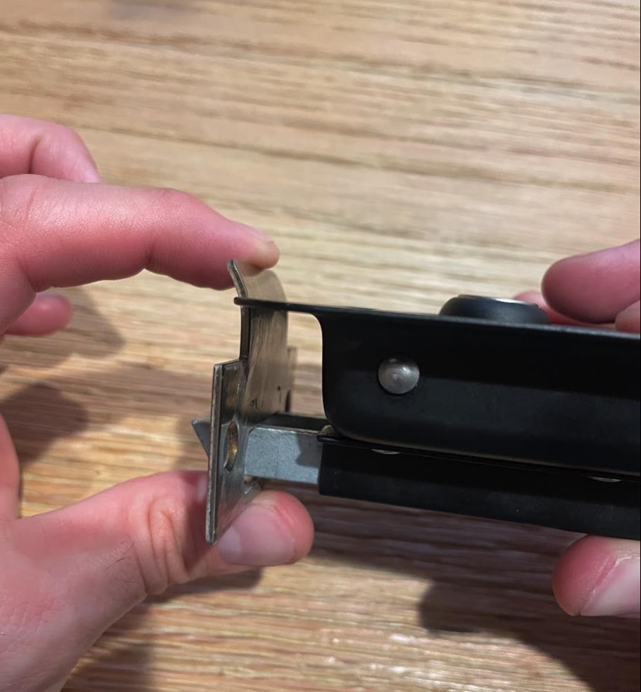

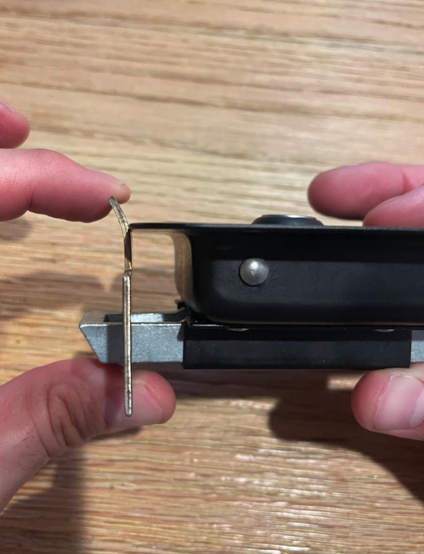

I decided to go with the second approach - cutting a notch into the top board where the paddle latch can live when the drawer is shut. For this, I bought latch striker plates [1]. However, when I used Southco Paddle Latch that others have used, it didn't align - the area where the latch lives is too far to the front of the striker plate so that the curved area of the striker plate would interfere with my top board and I'd have to account for the curved area by having a gap in between the top board and the drawer front [2]. To solve for this, I had a piece of metal welded to the front of where the striker plate's hole is so that it would fit better [3][4][5].

I'm surprised SouthCo doesn't manufacturer a strike plate that fits the latch (at least to my knowledge..). Curious what other folks have used.
