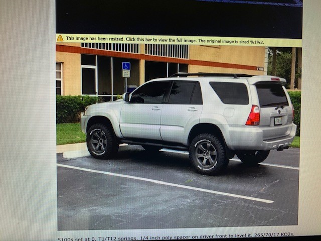

I have never done a change like this to any of the trucks or suv I have owned, so this is a first for me. After reading through a lot of pages of the suspension/tire sticky, I am still uncertain if I should install the 1" Daystar to get the look I'd like to have for my 4Runner. I included a photo from another owner, with much more of a suspension upgrade than a simple 1" front level, but it's the look of his 4runner and wheel/tire setup I'd like for mine.

The 4R in the pic looks taller than just a Daystar lift/level. I have the Daystar 2.5”F/1.5”R spacer kit on my 4WD 2004 4R, and I have been very happy with it. It’s 1.5” taller than the lift/level kit front and rear. There’s also room for 32” tires with just a little work. It’s also not too expensive at less than $150 and, if your 4R isn’t too rusty, relatively easy to install.
If you want the look of the 4R in the pic, you’ll want to lift the front and the rear.
It sounds like youve done some reading and are thoughtful about your approach and what your goals are - ie for looks, no plan on towing/ weight down back end
I think then the other question is what size tires do want (30.5, 31, 32, bigger etc)
I would guess the picture has 32s - 255 75 17 or 275 70 17s (though they may be 18s so 255 70 18, 275 65 18)
I think you could do a 1 inch front lift and 265 70 17s (31.5) and be happy and fairly cost conscious.

Syr4RinNC, thanks for the input. You're correct, appearance is my only goal.
I decided on the 1" DS front spacer and then read that I could also do the Bilstein 5100 shocks in front only with my stock suspension and produce the same result, which lead me to my post. The service history shows the PO replaced the front shocks and some suspension components at a dealer in November 2019, so I am certain the front shocks are in good condition. I do need to replace a rear leaking shock and purchased some KYB's to replace both.
265 70 17s (31.5), is the tire size I am looking to get as well with some oem wheels or aftermarket. Still not sure on the wheels yet.

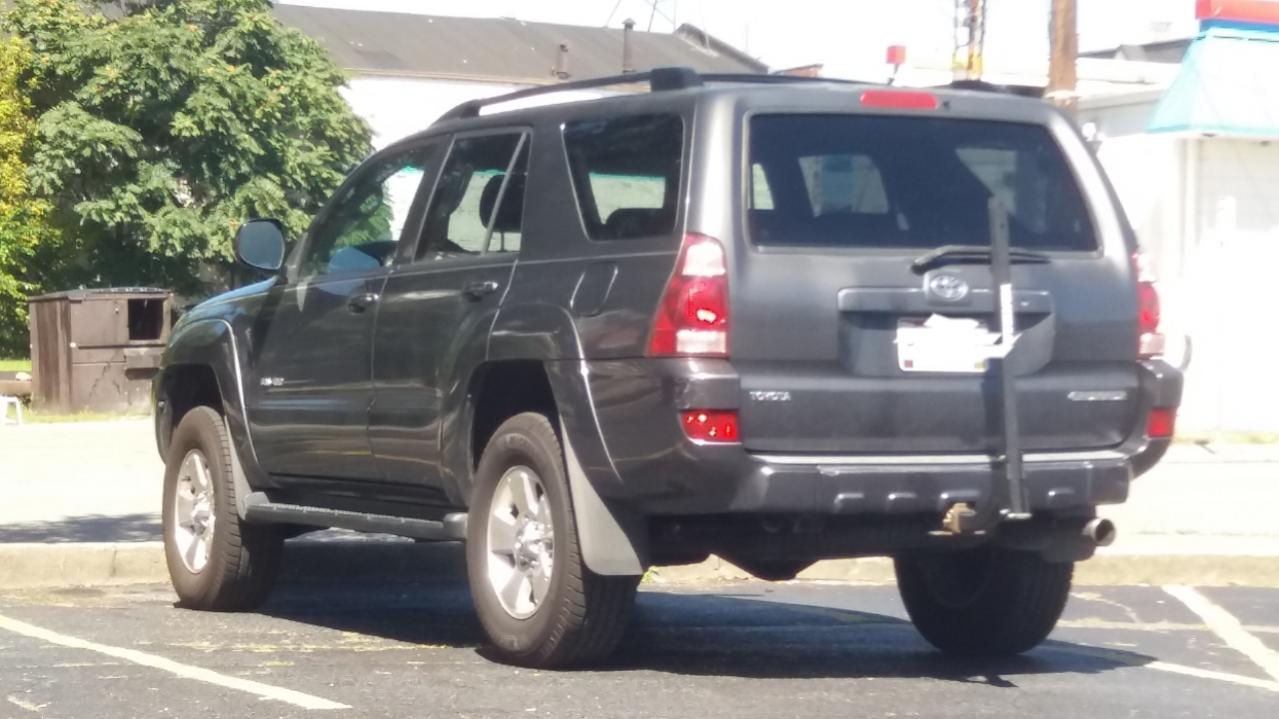

This is a 2 year old Daystar 2.5/1.5 lift with kyb complete struts in front and cheap shocks in rear, to be replaced by heavier duty cheap shocks soon.
Tires are 265/70/17.
I like the look of the lift and the soft ride when the shocks were new, but you will see more suspension wear even with this little lift.
I'm taking it out and going back to stock height only to get a firmer ride on the highway and less stress on front parts. This is a highway car mostly for me.
