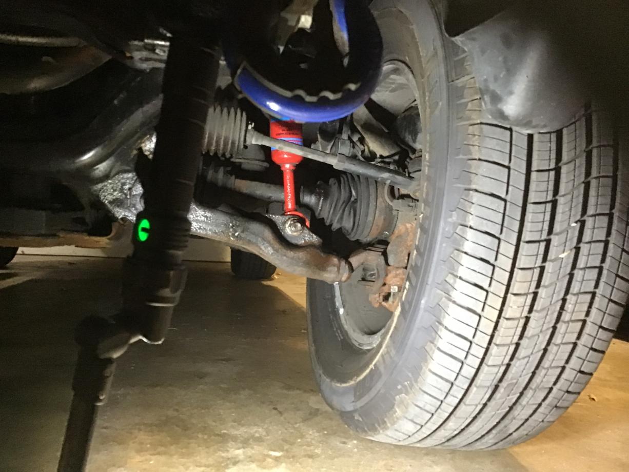

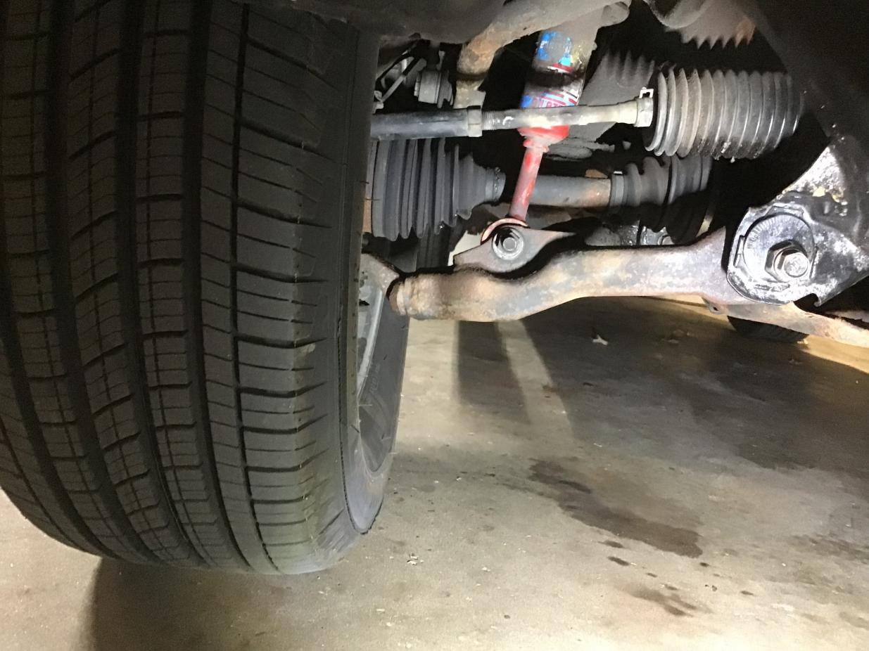

I was able to free the lower control arm bushings fused by rust. I hope it can be aligned. I also installed the diff lowering parts too. At $250 per lower arm, the Lower control arms were not in the budget for this project. The truck now sits at 35 1/2” front and back.
My question is this. With the front wheels off the ground, the CV axles bind when I try to rotate the front wheels. I hope I dont get air while driving. The axles are horizontal while parked. but has anyone else had this problem? Is there a solution? Better cv axles? Which ones?

When I used to run a large amount of lift, I had binding issues whenever I had the top spacer on the front suspension. I had done a differential drop kit to help correct it, and it did.
It seems that any lift over 3", especially with older CV's, binding is more than likely to happen! My technical recommendation is to lower the vehicle a little bit. My fun and cheap reocmmendation is to run a differential drop kit. :)
