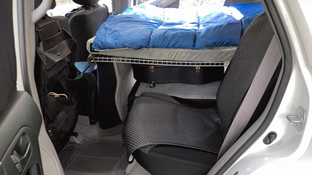

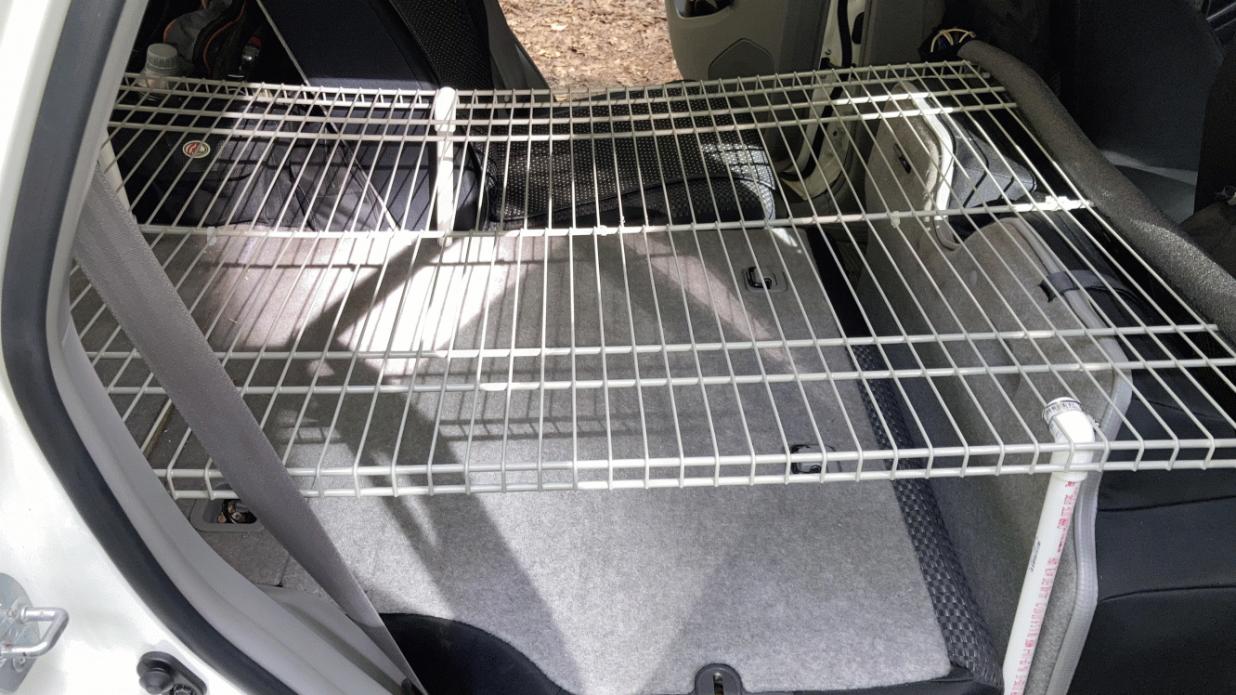

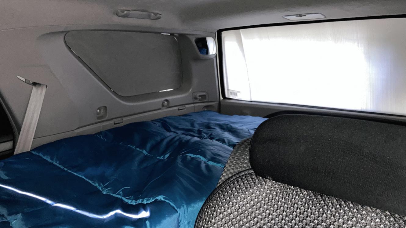

I decided to build the bunk space the same width as the larger of the two fold down rear seats, which is about 32” wide in my 2008 4th Gen. This promised a comfortably wide sleeping area, and I could use the folded seat to support the head of the bunk. I could also leave the other rear seat in place where it acts as a “living room” and entry point for the bunk.

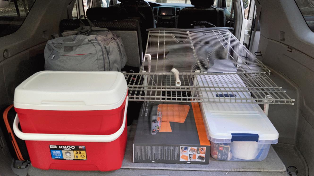

Sleeping Platform

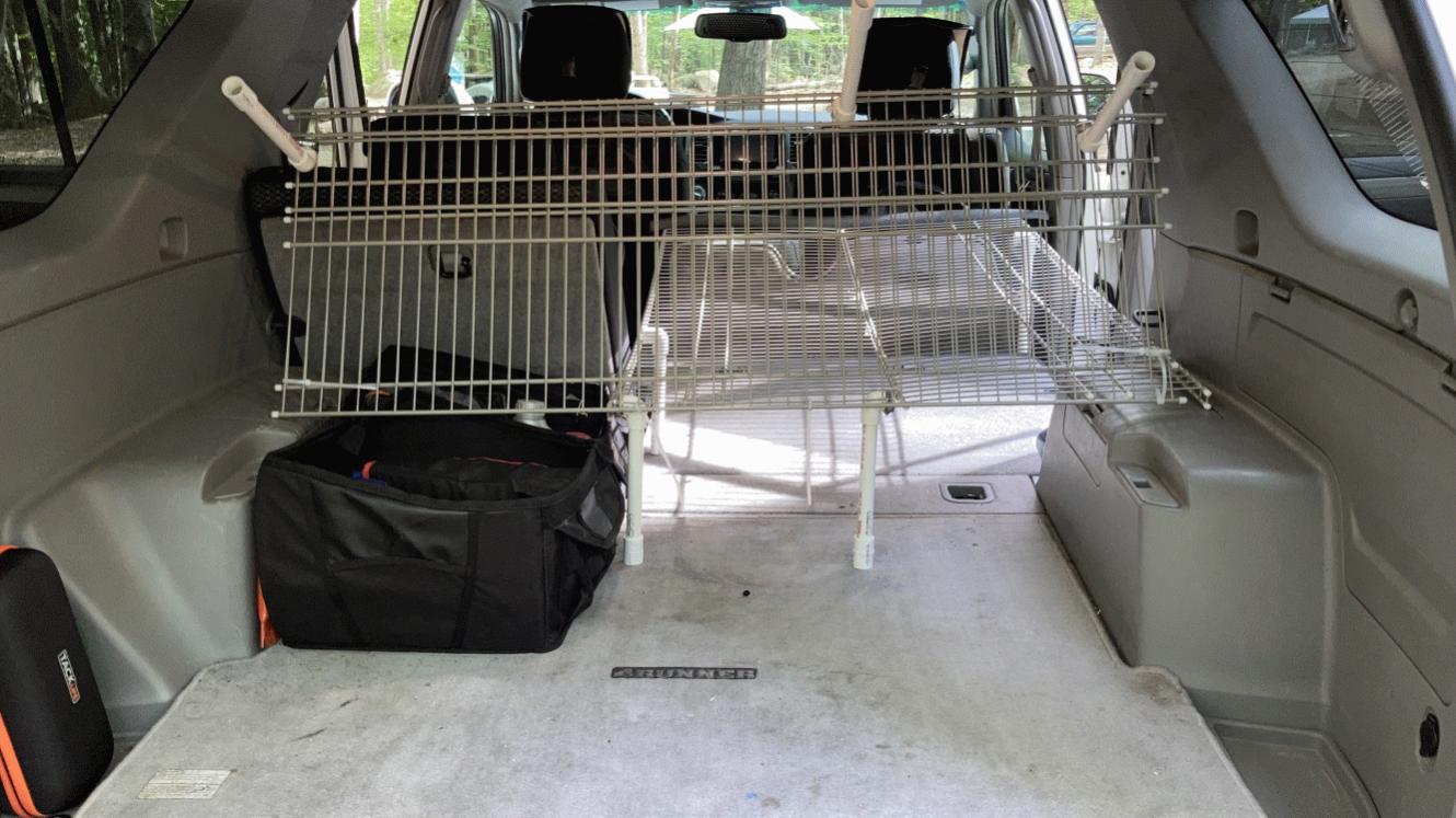

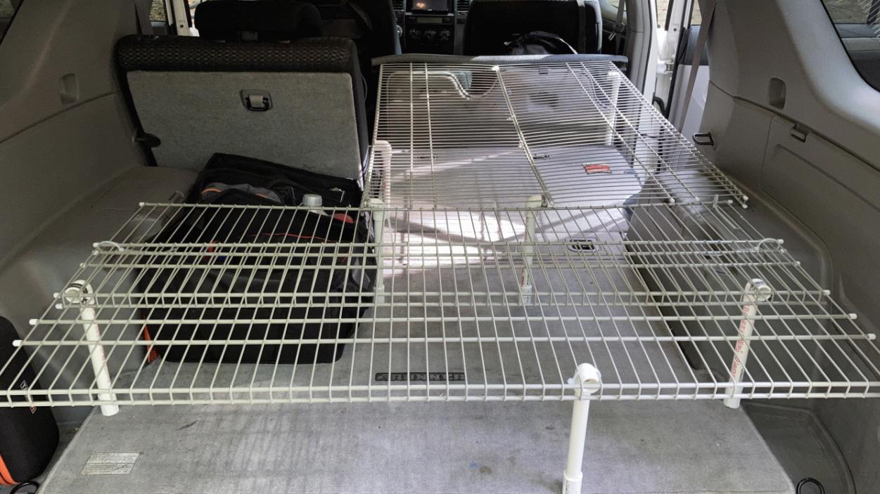

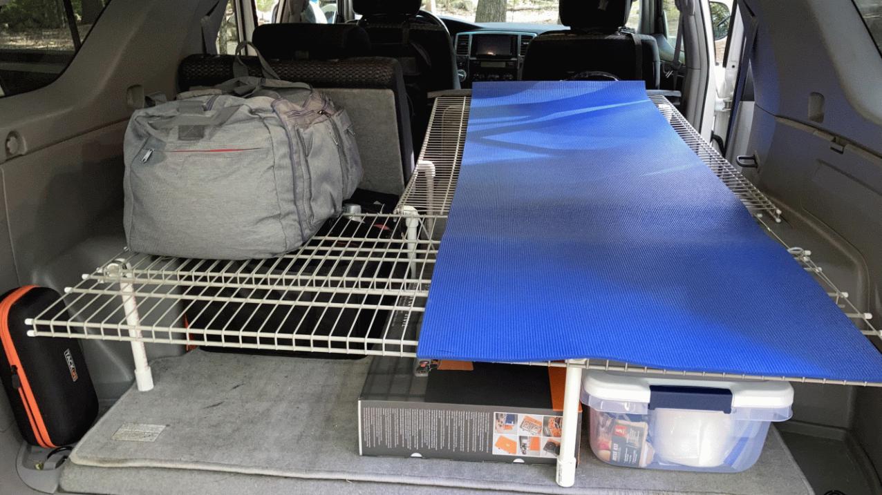

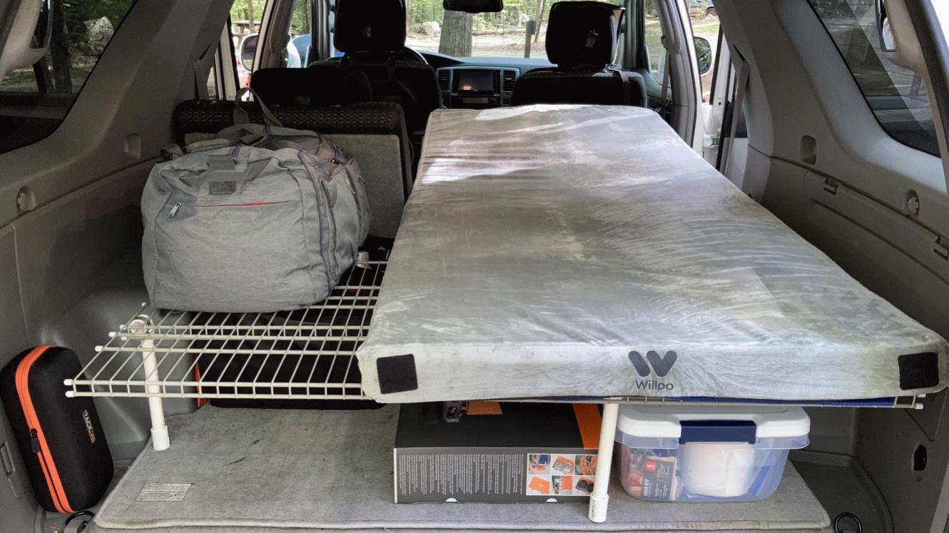

For this, I used standard ClosetMaid 48” x 16” wire shelf sections. When zip-tied together, and properly supported using 8” lengths of ½” PVC pipe, elbows and #12 hose clamps, they can form a remarkably strong and lightweight platform. I didn’t plan it this way, but I found that wire shelving sections have enough “give” to feel like a box spring, making the sleeping surface very comfortable.

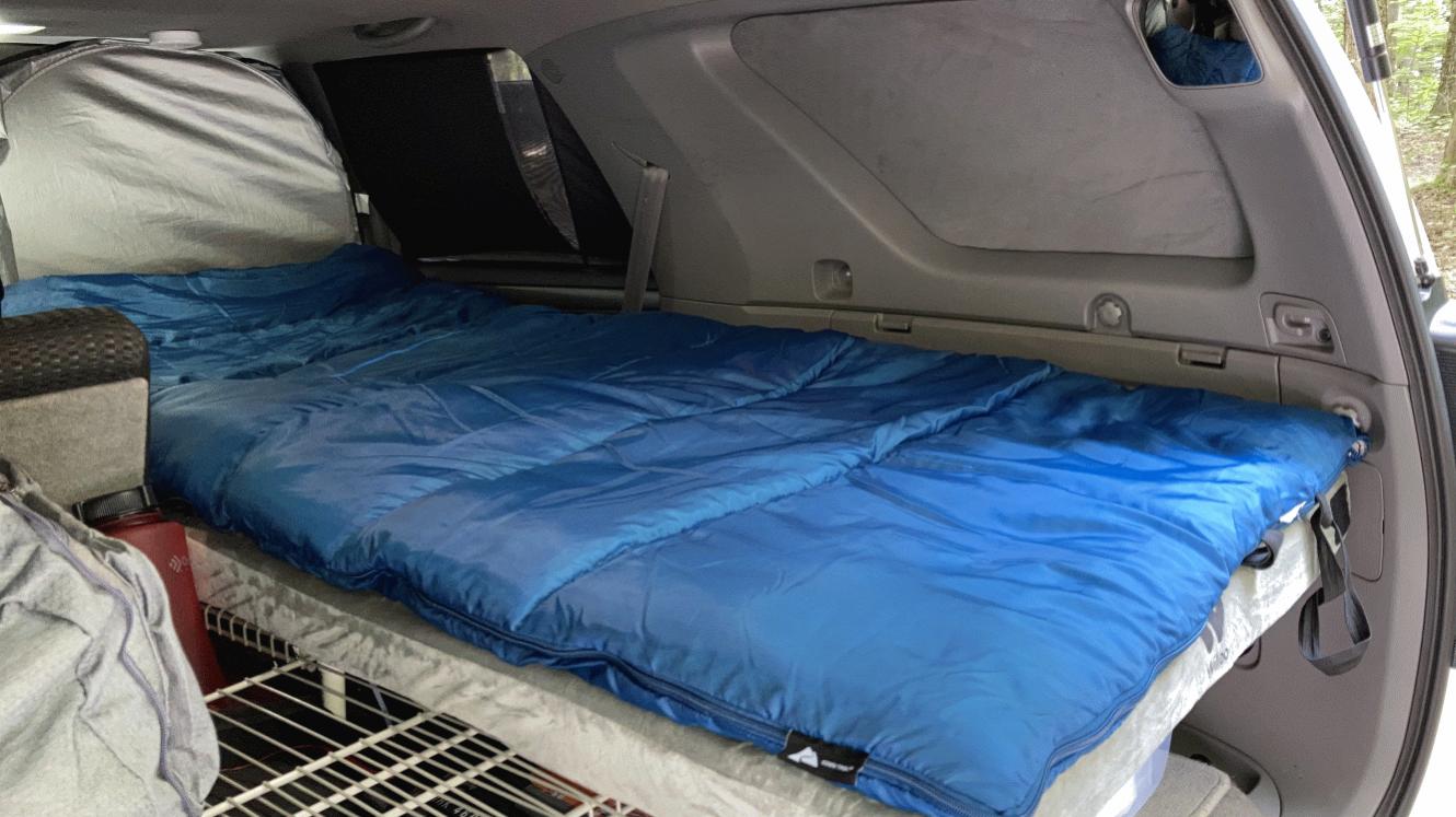

Two 4’ sections zip-tied back to back form the upper end of the bunk. Another 4’ section is attached crosswise to them spanning the cargo area to support the legs. One last section is added at the rear and loosely zip-tied to the spanning section to support the feet. This also allows the rear-most section to slide forward, and both spanning sections can be tipped up for access to the storage area underneath.
I placed a cheap 6’ yoga pad on the shelving section to protect a sleeping pad/air mattress from any sharp points. This would also be important as insulation under an air mattress. I opted for a more expensive 3” memory foam mattress, and I’m very glad I did.
This results in quite a lot of storage space under the platform.
The left rear seat becomes a useful and fairly spacious area with the drivers seat moved forward.
Adding a privacy screen up front, stick-up AAA lights and a rechargeable fan makes it comfy.

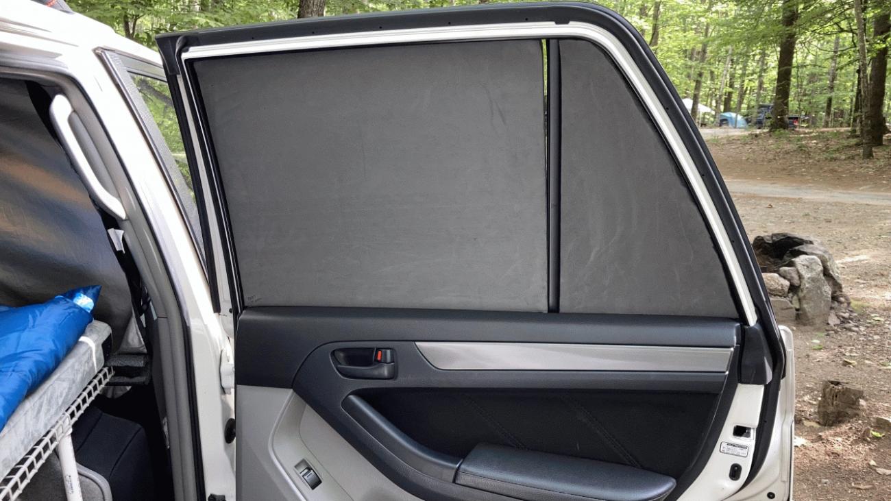

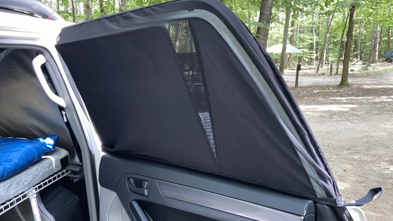

Privacy

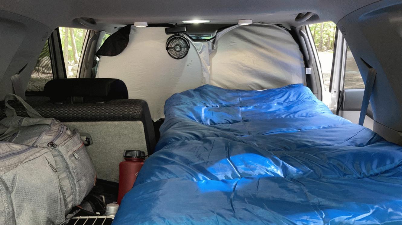

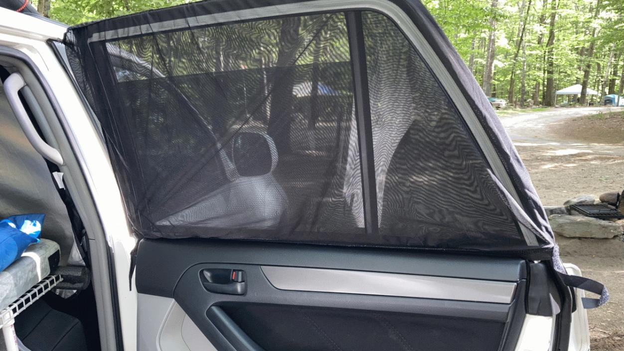

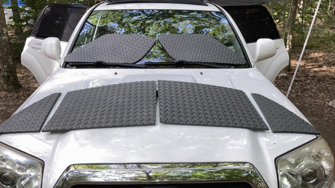

Finding a simple way to temporarily “black-out” the windows in the sleeping area was a challenge. For the side windows, I settled on using those EVS foam interlocking exercise mats and cutting them to fit snugly in the window frames. The result works beautifully- not only for privacy and keeping it dark, but also for thermal and sound insulation.
However this aspect took me the most time of the whole project. My advice is to find someone in your life who knows how to trace a pattern from the window shapes and transfer it to the foam mats. I can’t sew, upholster or make sails, so this was a challenge. The best tool I found was a rotary razor knife used to cut fabric or paper for scrap-booking. At least the windows are bilaterally symmetrical, so if you get one to fit nicely, you can just trace it out for the other side.
For the back window, I decided not to use the EVS foam but opted for corrugated white plastic signage material. This can be popped into the window frame in three segments. It provides some insulation, but also makes it seem less cave-like inside. It does get bright in the morning, though, so be conscious of where the sun will rise when you park.

Nicely done! Very useful and temporary, can obviously be installed removed in a reasonable amount of time for the daily driver/occasional camper type.

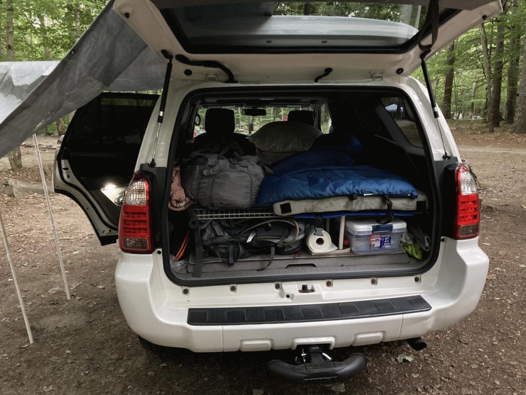

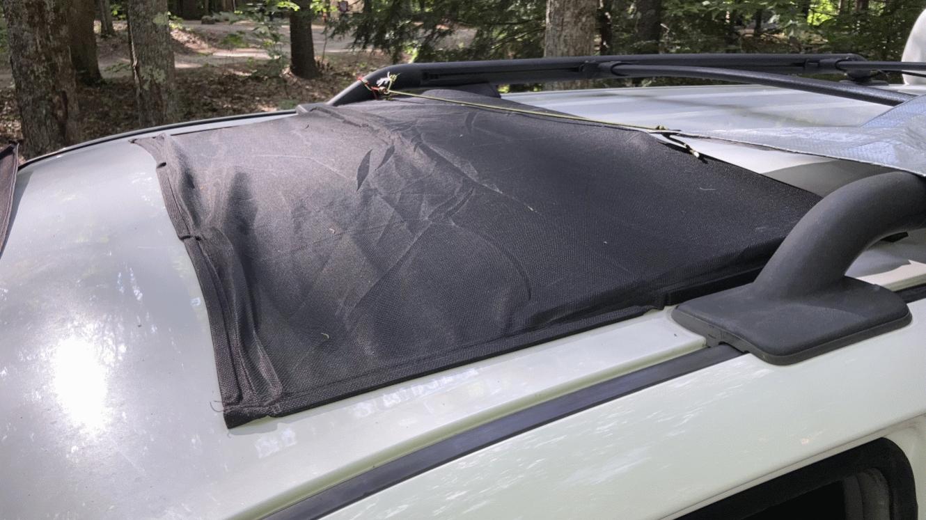

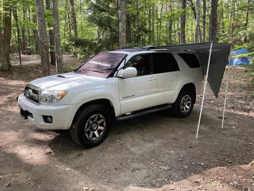

I learned here from other people’s experiences that good ventilation is extremely important. My approach used simple off-the-shelf products that worked great. The rear door windows can be opened 3-4 inches under the screening, but the foam window inserts can tip back to allow airflow while maintaining privacy.
I also found a 40” x 26” magnetic sunroof screen that is a smidge too small but still usable. The small camping fan works wonders.

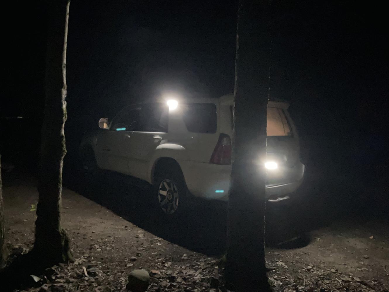

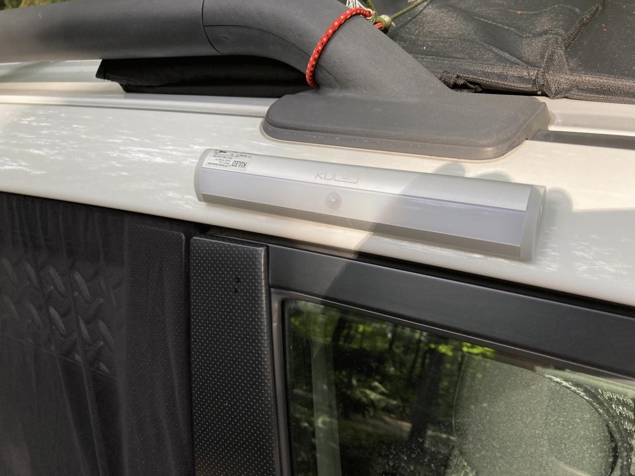

For a bit of added security, I added three battery powered motion sensing lights on the sides and rear. They attach magnetically and work great to illuminate the area around the truck. (If I’m ever locked inside at night and things look sketchy outside, I can climb into the driver seat from inside and bug out.)

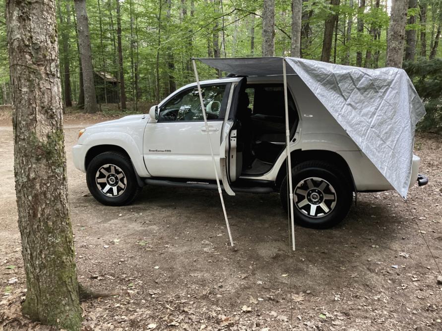

For a some exterior coverage from rain and sun, I used a 6’ x 8’ tarp bungied to the opposite roof rail and supported by six more 2’ x ½” PVC sections with couplers and hose barbs on top. (I plan to replace this with a white 6’ x 10’ or 12’ for more covered outside space and to keep the sun off the roof.) The windshield cover can keep some heat out, if need be, but I haven’t used it much.

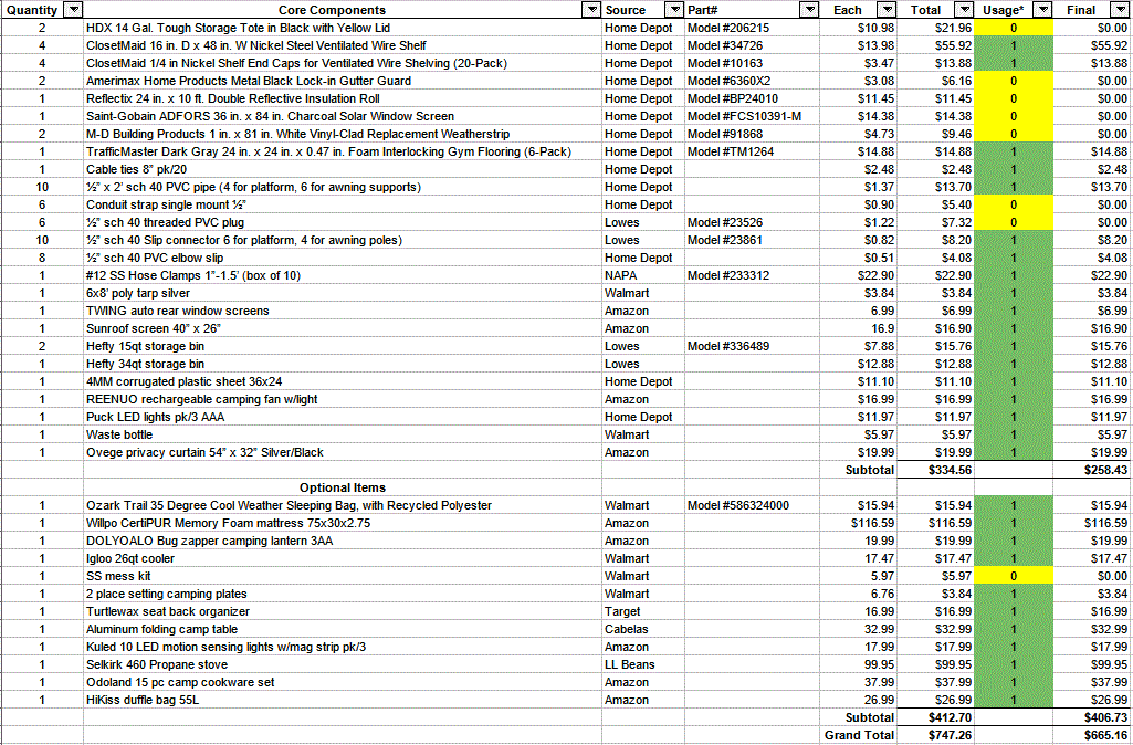

Below is my parts list, so far. (Items with a yellow “0” in the Usage column were things I bought, but ended up not using.) As you can see, I spent quite a bit prototyping, and I had to reacquire most of my camping gear, but overall this has turned out to be an inexpensive way to do some safe and comfortable weekend solo camping in my daily driver.

Just realized I forgot an important detail:
The support leg directly below the front passenger seat goes all the way to the floor. I don't have the exact length of the 1/2" PVC section handy, but I think it was about 22".
It's the one on the lower right in this pic:

Yes, the foam inserts are working perfectly, and the amount of thermal insulation they provide is remarkable. I had difficulty in tracing and cutting them to fit well, but I'm sure others with different experience won't have a problem.

I also switched to a 9' x 12' tarp for more exterior workspace, and found that Nite-Ize gear ties work great for securing it to my roof rack.
The foam window insert are brilliant. Thanks for the idea! I could see folks buying these as a finished product.
Thanks! If someone comes up with a better way to size and cut them, let us know.
Funny- selling these as an aftermarket item crossed my mind, too. I suppose if there are CAD drawings of all the variations of manufacture/model so that they could be cut on demand for many different vehicles, that might work.
I learned from another project that cutting PVC and similar materials using a laser isn't really feasible. It tends to destroy the laser for some reason. So they would need to be hand cut or shaped using some sort of die. Major machinery.
Maybe 3D printed? Can that even be done with flexible, foam-like materials?

Could you use close cell foam? Slightly oversized so it friction fits in place.
