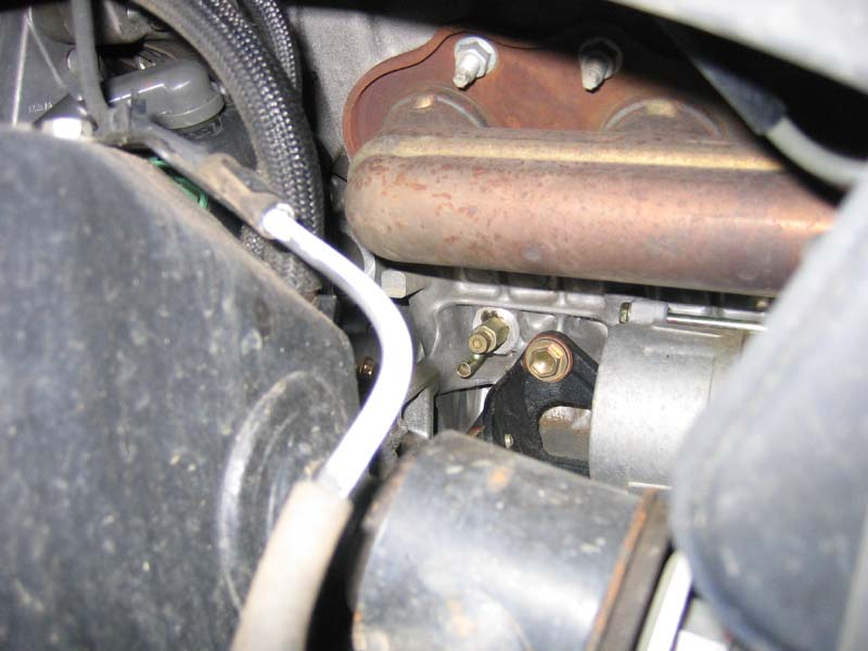

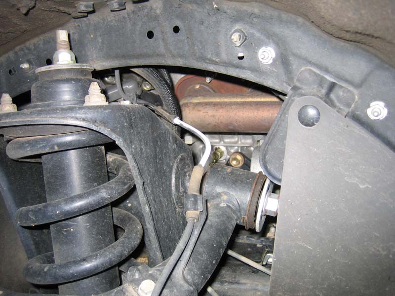

Picture of the Draincock
Here is a good picture of the driver's side engine block coolant draincock. I have the drivers side wheel removed, so I could reach into the engine area to attatch a vinyl hose and get a wrench on the drain valve bolt.
It is in the near center of the picture.
The passenger side draincock is near the back of the block, but easier to reach, less clutter.

Thanks for the shots. Just goes to prove that the engineers should have to work on the engine with normal tools before they are allowed to release the design to the market. What were they thinking when they put it so you had to remove the wheel??
:bash:
My short arms
:bash:
If I was over 6 feet, with a big reach, it could be possible to reach down inside and feel for the barb end to connect the hose, and also feel for the bolt to loosen. But I would have been inside the engine to do this. Even from directly beneath, the clutter is awkward, the half shafts for the 4wd are in the way.
I suppose they had to put them somewhere.
