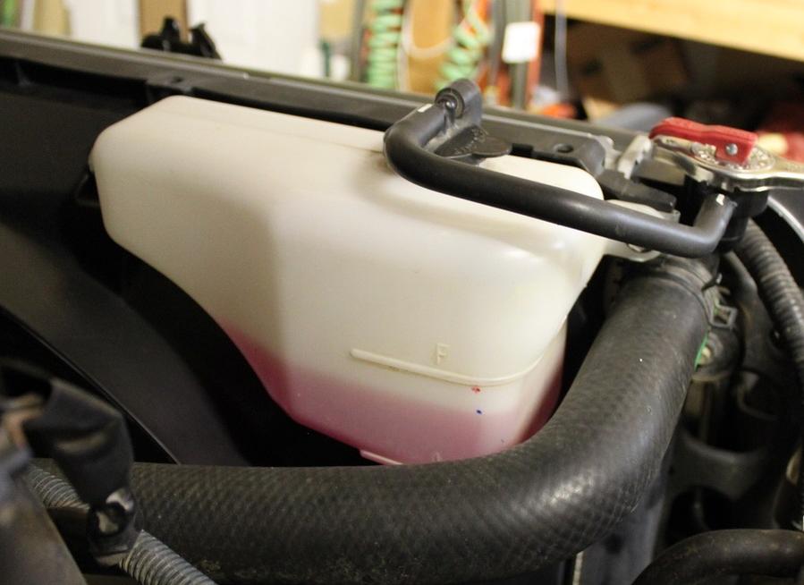

That reservoir has high and low marks on it. Should have fluid in the overflow tank.
It will expand with thermal increase...blue and red marks.
