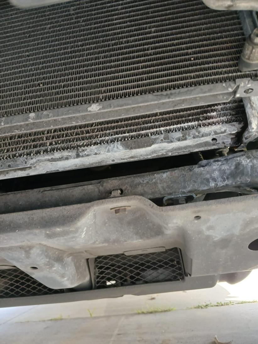

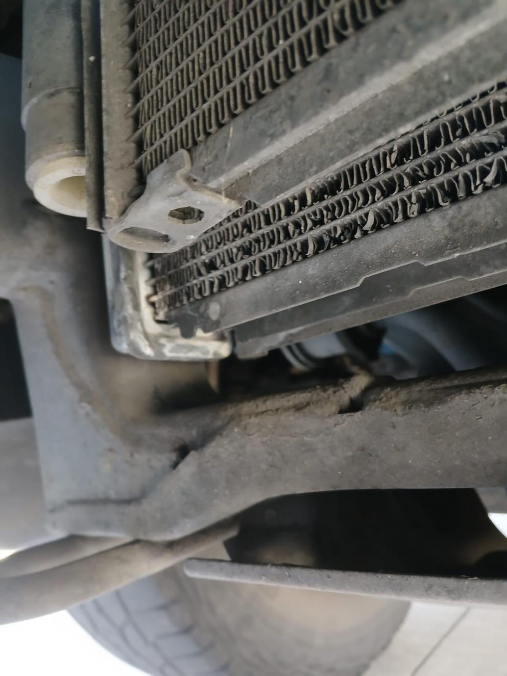

4.0 V6 1GR FE motor. So about 4-5 months ago, I noticed that it SEEMED like my coolant level in the reservoir went down a tad. I took a sharpie and drew a line where it was, while hot, and decided I'd check back periodically. I did so about a week later and it seemed just slightly lower. I wasn't too concerned yet, as it was slight. Well, I forgot all about it for maybe 4-5 months now. Probably 5. I went out just now to take a look, and it's right at the bottom of the reservoir, just barely even a little puddle of pink coolant down there. UH OH! :wow::wow:
I don't see, nor have I seen a leak or pooling of coolant on the driveway, but the bottom of the radiator and a little the evaporator they both have a white corrosion on them. I'm HOPING TO GOD the water pump is leaking slightly and that's all it is. Not he dreaded head gasket!
Details: 280,000 miles. Original water pump. Runs and idles fine. Now misfire codes. No white smoke that I can discern out the pipe. Oil looks fine.
Any thoughts??
Just normal road corrosion or evidence of leaking pump ?

Mine was the radiator where the plastic meets the top metal on it. There's seals in there that, as the rad gets older, can weep. You would need to remove the plastic top cover that is over the rad to see this area, it is held on with push clips. Mine had dried pink foamy looking stuff in the area on one side. I got a Denso rad off of RA for a good price and no leaks now.
The lower part of your rad looks like road grime.

How old is the radiator? They're know to start weeping in the lower corners when they get older.
