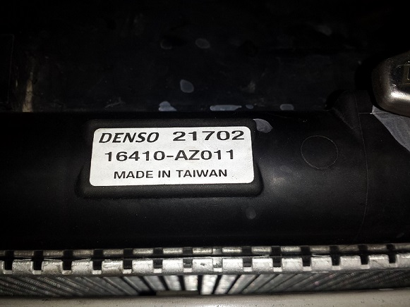

1) new radiator (16410-AZ011, OEM but says Denso?)

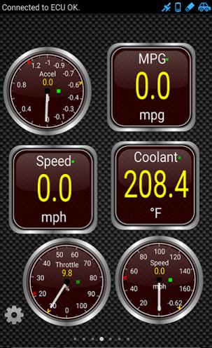

Back on road, turn on Torque app and while driving at night, no A/C, temp is hovering around 205°, and idlng in driveway it reaches 208°.
That seems too high. When it was overheating on drive down, it was getting into 225°+. Research on here says most of you see temps around 190°, maybe closer to 200° on hot days with the A/C blasting.

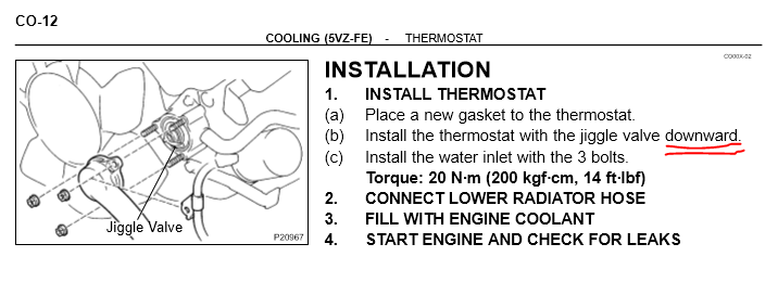

I've also read a bunch about Thermostat jiggle valve placement. Consensus says to clock it at 6, or downward. My copy of the FSM confirms this. I check with Alamo and they tell me the new thermostat was installed at 12 and is supposed to be at 12. WTH!?
Please somebody help me out. Our Thermostats are supposed to be set at 6, right? Do diff years have different specs? (Mine is a 1999). Should I take it back in and make sure they flip the Thermostat around before I head back to Oklahoma, which I was planning on doing tomorrow, or say F-it and just do it myself when I get back home?
T-stat installed in the 6 o'clock position is the general consensus around here. My OEM t-stat was installed at the 12 o'clock position, and my truck did just fine for 17 years before I swapped it this winter and put it in the 6 position per feedback here. My coolant temps dropped initially a few degrees but now hover in the General area of when my T-stat was at he 12 position. Splitting hairs with 1-2 degree differences here.
Folks here swear by the 6 o'clock position and some have provided tangible proof this results in lower cooling temps, but in my experience the notable difference in temps pre/post jiggle valve relocation is negligible. I'm almost willing to bet that my paper copy of the fam for my 2000 days jiggle valve at the 12 o'clock position.
I'm guessing your jiggle valve position isn't the culprit here. I'm guessing there's still air in your coolant system and it could use a good burping.
Many members are obsessed with this jiggle valve, 205-208 is not bad, especially in the summer with A/C running. I personally don't remember which way I placed my jiggle valve and have absolutely no problems. As longs as your gauge doesn't hang around in the upper section it's fine, my gauge is always a bit below half, heat, cold, a/c on or off. Besides it's not the thermostats job to cool the engine, the temp listed indicates at what temp it will be fully open. the placement of the jiggle valve would have no effect on that. Now here come the arguments.
When I bought my truck Feb 2016 and went to replace the thermostat, the jiggle valve was in 6pm position. When I put the new thermostat in, I placed it in 12pm position. Shortly after this, I bought a Scangauge and noticed temps were ~207F. I then re-positioned the new thermostat with jiggle valve down at 6pm position, now @ 188-191F. Unfortunately I don't know what the temps were BEFORE i replaced the original thermostat but I can confirm the jiggle valve WAS at 6pm.
Your fine. Denso is OEM supplier. If you start breaking 210* and keeps climbing than you have an issue. But 210* in the summer with AC on in traffic is normal.
Yes you could drop about 10* flipping the thermostat but in the winter I like the warmer air.
Thanks for all the replies. I'll probably switch it to 6 just for peace of mind but interesting to hear multiple experiences. I deal with hot days way more than cold days so ac is on a lot. A 10deg drop would be nice
I've had two trucks with the 3.4L engine. A tacoma that I bought new in 04 and now an 02 4Runner. My old tacoma always ran temps in the low 190's. When I bought my 4Runner I noticed that the temps were consistently around 207. Checked the thermostat (which was replaced by a Toyota dealership during a timing belt replacement) and found the jiggle valve in the 12 o'clock position. I flipped it over to the 6 o'clock position and now I see temps around the 190 mark again. Moral of the story, the engine should be operating around 190 from my experience and dealers suck.
I'd take it back, ask them where the jiggle valve is supposed to be placed, and upon their answer, I would show them the FSM and ask if they always perform repairs improperly and kindly request that they fix your ride correctly.

Haynes manual says jiggle valve at 12 o'clock, Toyota FSM say 6 o'clock. I would go with the FSM. Btw mine was installed at 12 then i switched it to 6 and now runs 10 degress cooler.

Update: went to dealership, had them top it off with coolant (reservoir was empty @ cold) and burp the system. Said fan clutch was good, but swore the thermostat was supposed to be at 12, according to their master mechanic (aka older, set in ways imo). Didn't have an answer when i showed them the FSM print out that clearly says "place jiggle valve downward", and didn't want to spend all day there so I hit the road. 9 hours straight to Tulsa, coolant stayed around 203° with low a/c, only rising (208-210) in Austin and Dallas stop/go traffic. Going to track temps in typical city driving here, and then switch the thermostat around and make note of any changes. Thanks for indulging my rants!:thanks:

Right on, I've seen posts where it made no difference and for others (and me personally) it did, so really the only way to find out is to actually try it and see. One thing going for the 6pm cult is the FSM which specifies the correct jiggle valve position as being "downward."
