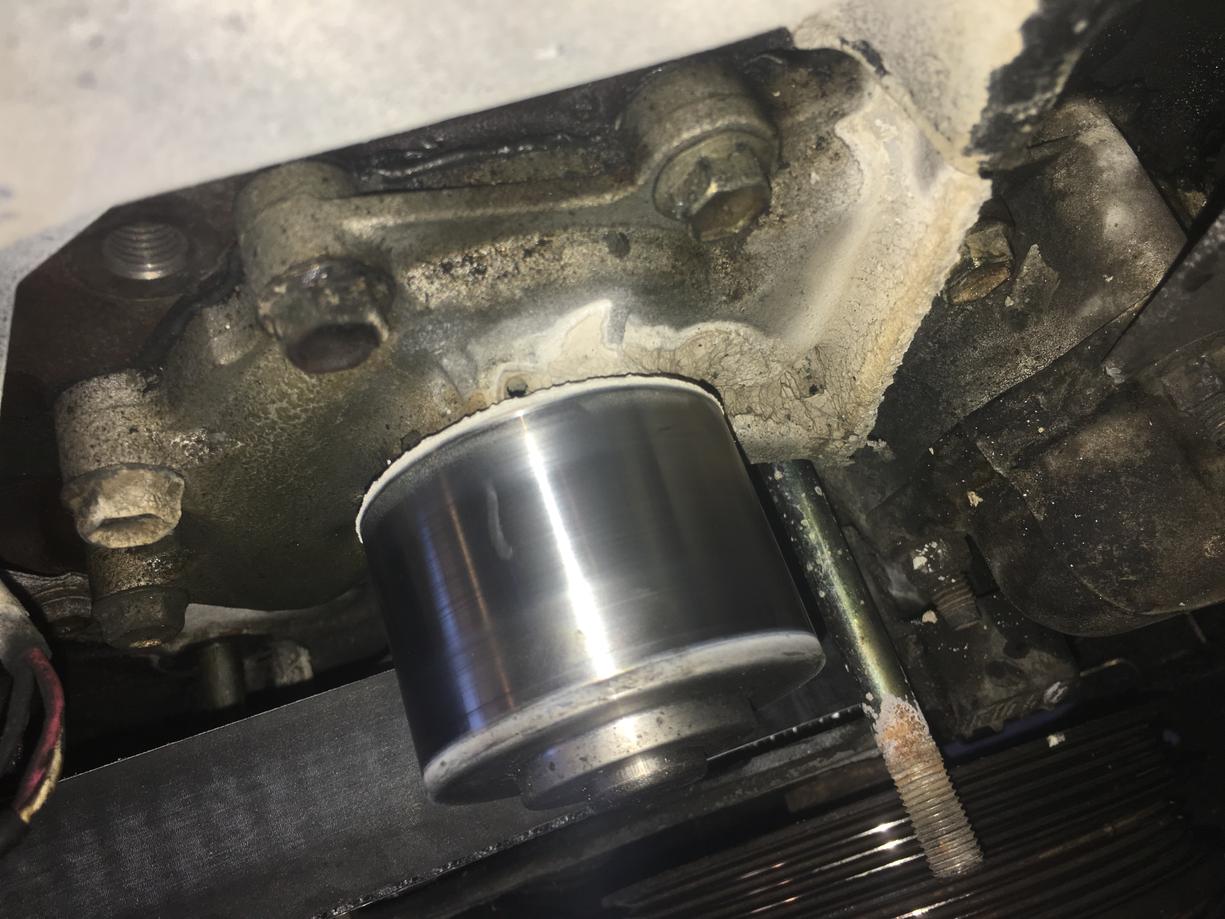

Can anyone assist in identifying the source of my coolant leak and the possible fix?
Currntky, I have to add 1/2 gallon of coolant every week...

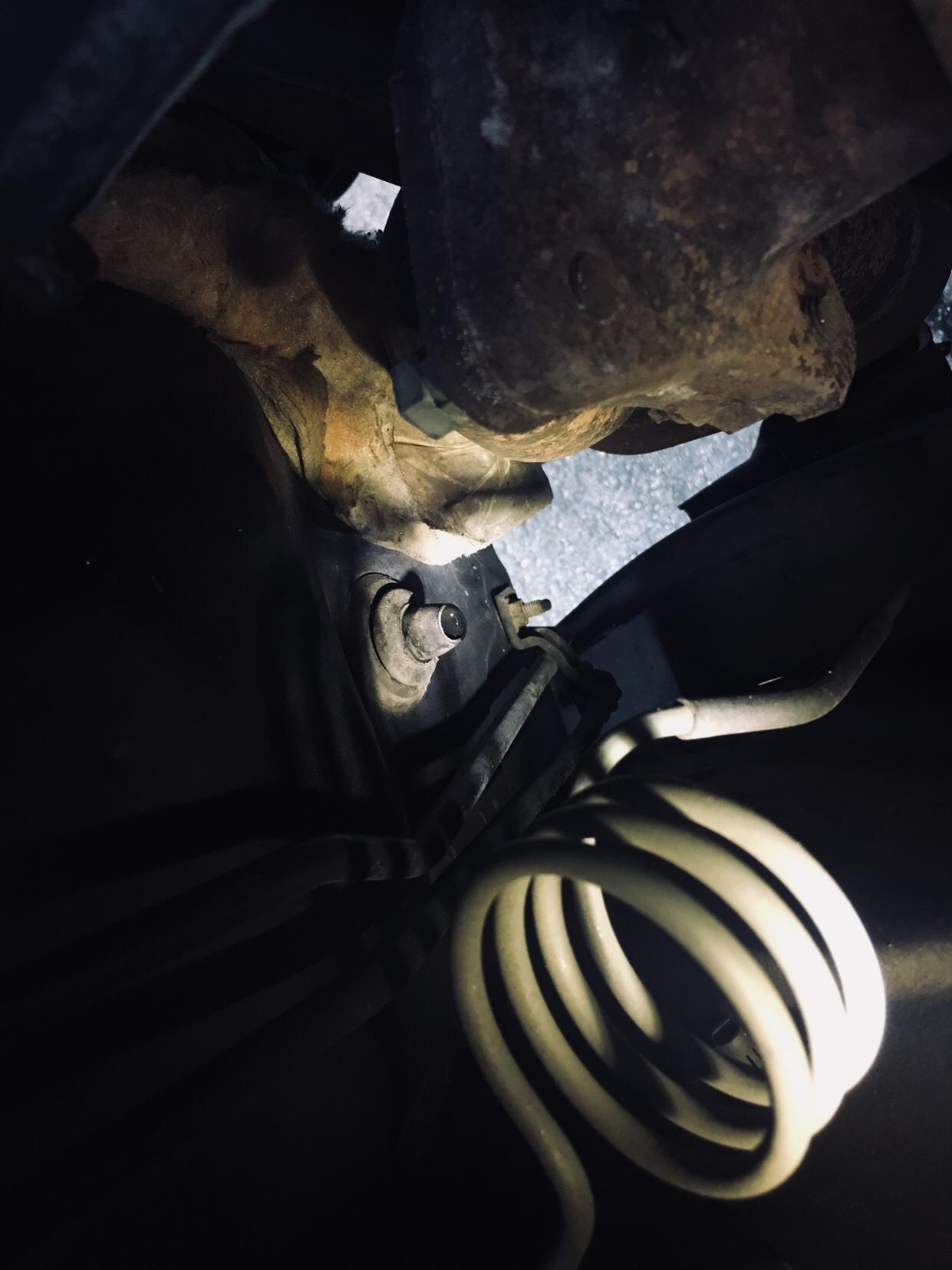

I don't really know what I'm looking at, give us some more details. Is it leaking coolant or burning it?
Need more info for us to help.
What is pictured is a rubber spout protruding out of the firewall, passenger side, that constantly drips even when the truck is not running.
This sounds like your a/c condensate drain. It’s supposed to drip moisture to the ground. Anytime you have your a/c or defroster on, it may start dripping.
Your coolant loss is somewhere else.

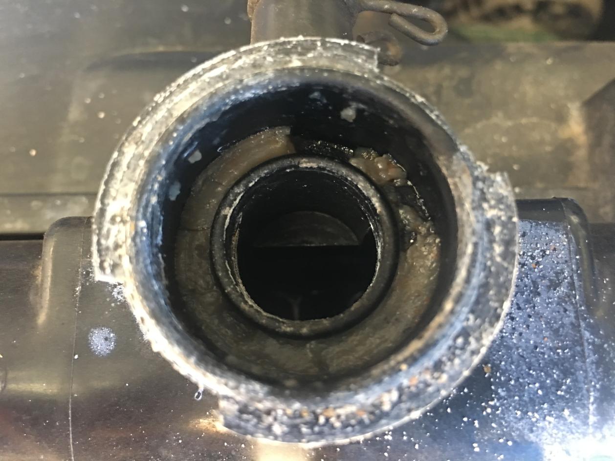

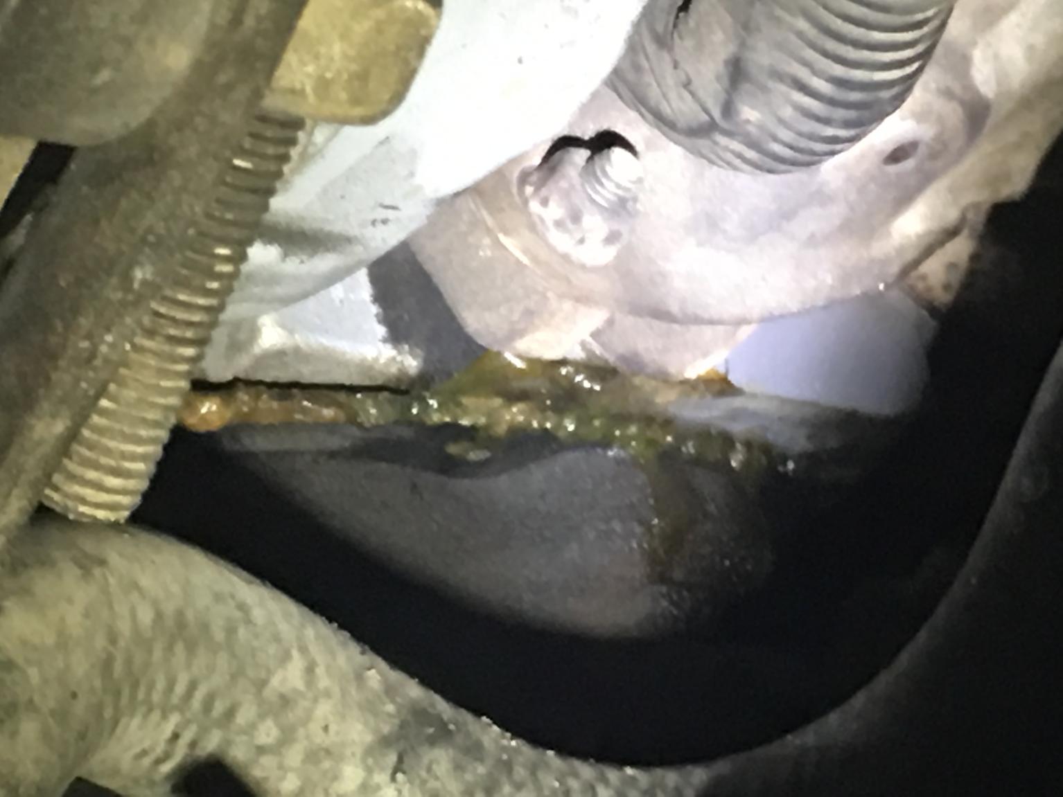

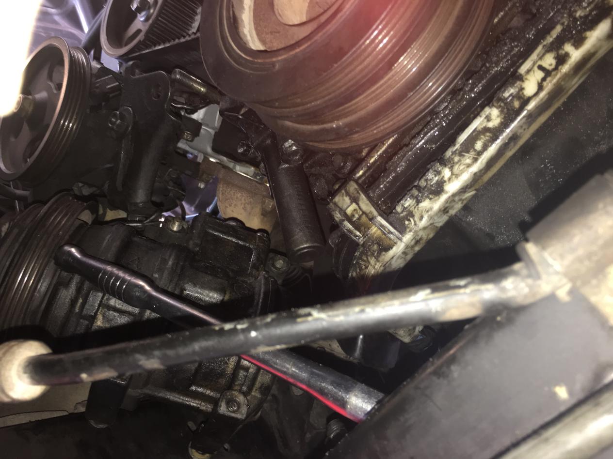

Here are additional pictures that might help:
The one picture shows some leakage between block and head on the driver’s side of the engine.
Then there is a picture of the radiator top that shows some grayish residue...

It's not looking good for your head gasket given the picture of the sludge between your head and block. There also seems to be some gunk around the inside of the radiator cap area.
Is it blowing white smoke from the tail pipe? Can you see bubbles in the coolant overflow tank with the engine running? How does the under side of the radiator cap look?

Unfortunately, it looks like at a minimum, you have a HG repair in your future.
All that sludgy stuff at the radiator cap is probably radiator stop leak stuff. They were probably trying to slow the leak down a little. Apparently, it didn't work very well.
I'd double check what's coming out of your A/C drain - it's probably condensate - water. But it's faintly possible that the heater core could be leaking and (not sure how the HVAC is arranged inside) it could end up draining there. So if it's coolant - heater core.
You might also try cleaning the area around that leak on the head really well, and then driving it briefly, and looking again. Sometimes coolant can trickle along edges and crevices for a distance from the source, and make it look like something is leaking that isn't.
HG failures can have all sorts of different symptoms, depending on where it's leaking. There's compression, oil, crankcase interior, and coolant all right next to each other. What gets mixed with what it shouldn't get mixed with is random.

Isssue: Defective Waterpump!
It was a defective waterpump!
The previous owner did a top end rebuild but NEVER replaced the waterpump or thermostat :(
He did replace the timing belt though, and NOT the other belts :/

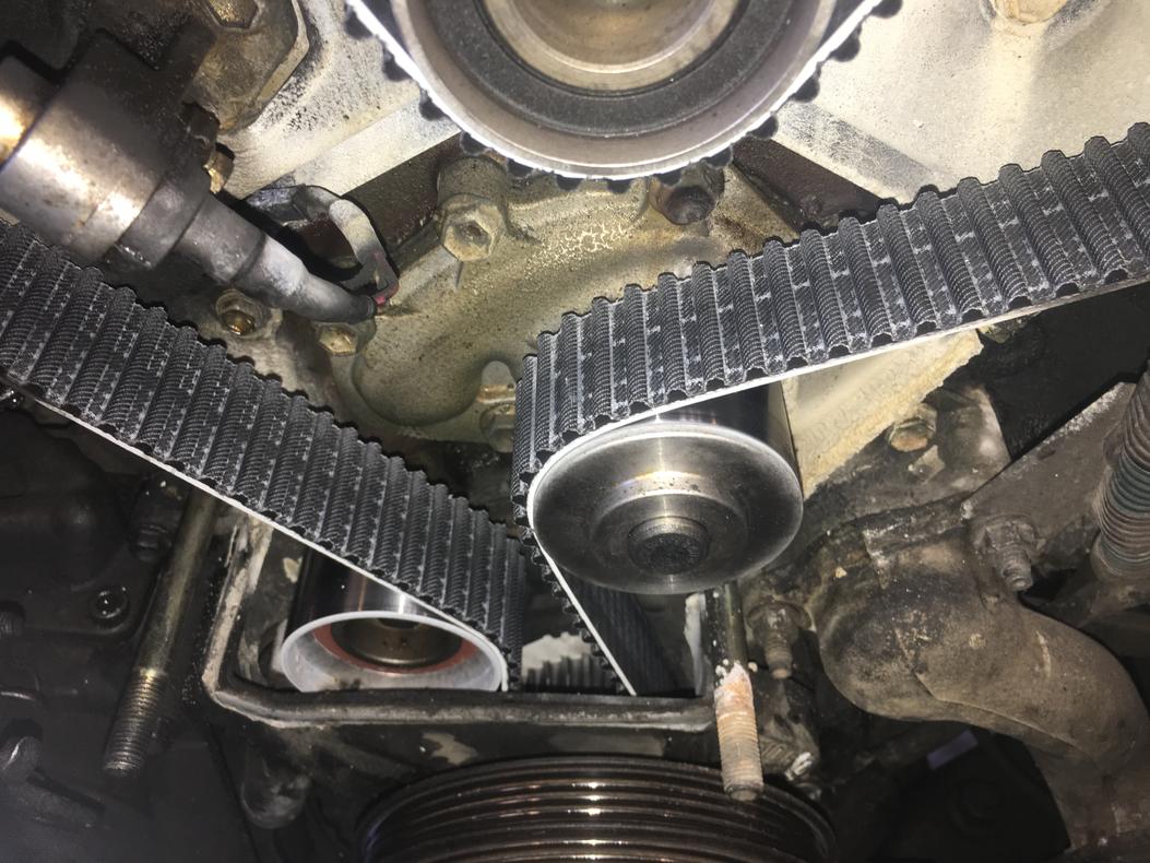

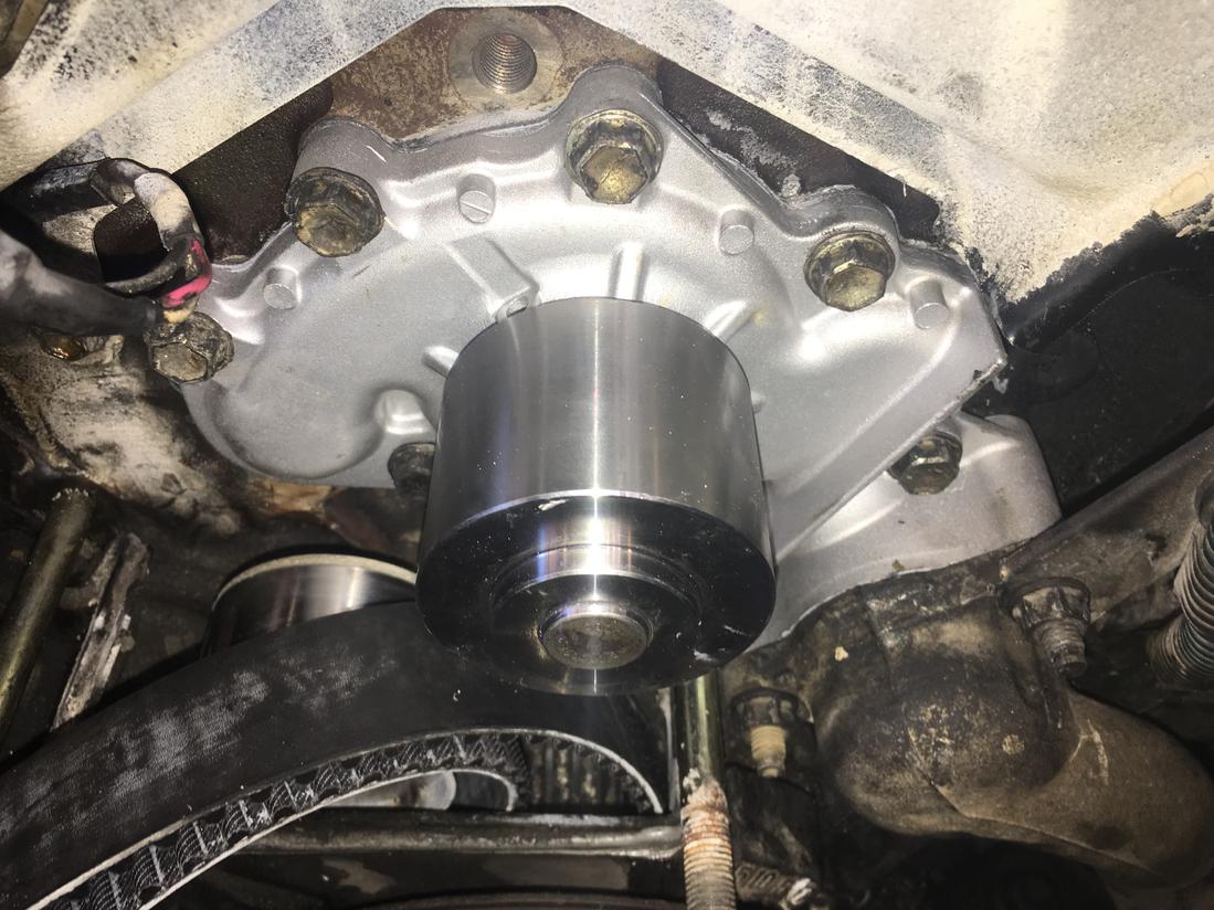

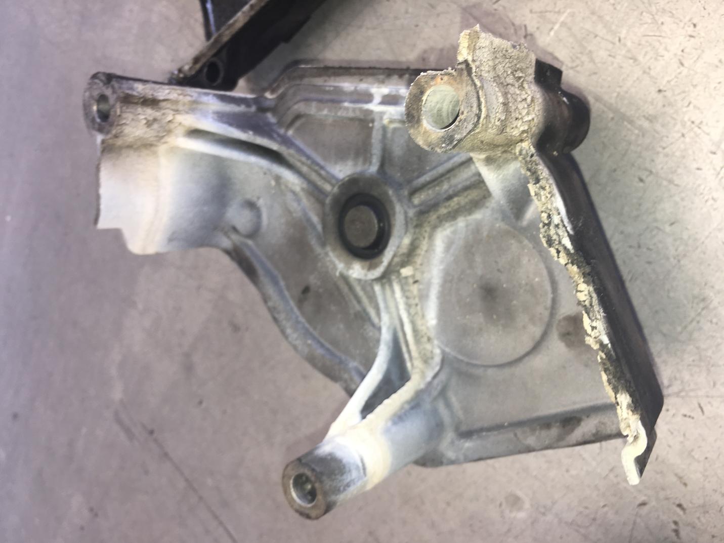

In short, it took me awhile to replace, but I could not have done so without the help of so many of you in this forum and YouTube - A big thank you!
The hardest part was taking that damn AC bracket off just to access the bolts on the hydrolic tensioner (pictured) - wow!
