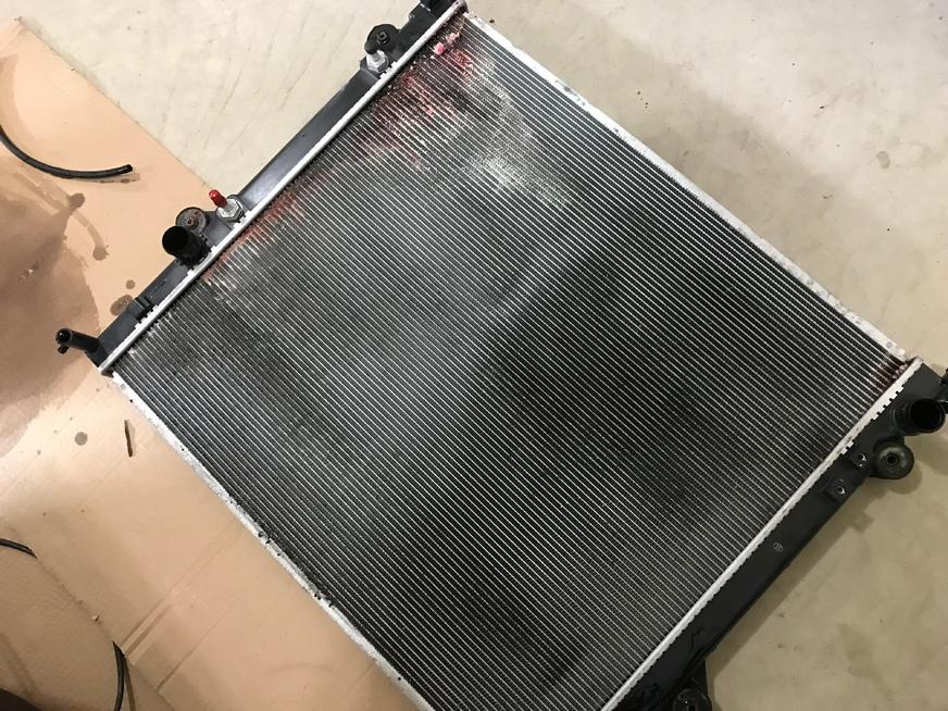

Got it all broken down today, waiting for the parts to arrive tomorrow. Amazon don't let me down!

Job done. Amazon came through.
New radiator, new belt, new hoses, fresh coolant. Drained the block too so it ended up being nearly a full coolant change.
Used existing hose clamps which were a bear to access from up above. I had always heard the Toyota spring clamps were the way to go, so I kept them.
Only other snag was I snapped the lower tab (for the fan shroud) from the new radiator. It isn't rattling, but I will epoxy it back as soon as I get a chance.

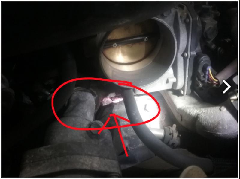

Update for anyone that might find this later on:
I've determined the leak is indeed from under the intake. So I will not be replacing the radiator and hoses, etc... I've found my specific leak talked about in another thread here: V8 Engine Leak
I've attached a pic of where my leak seems to be showing
