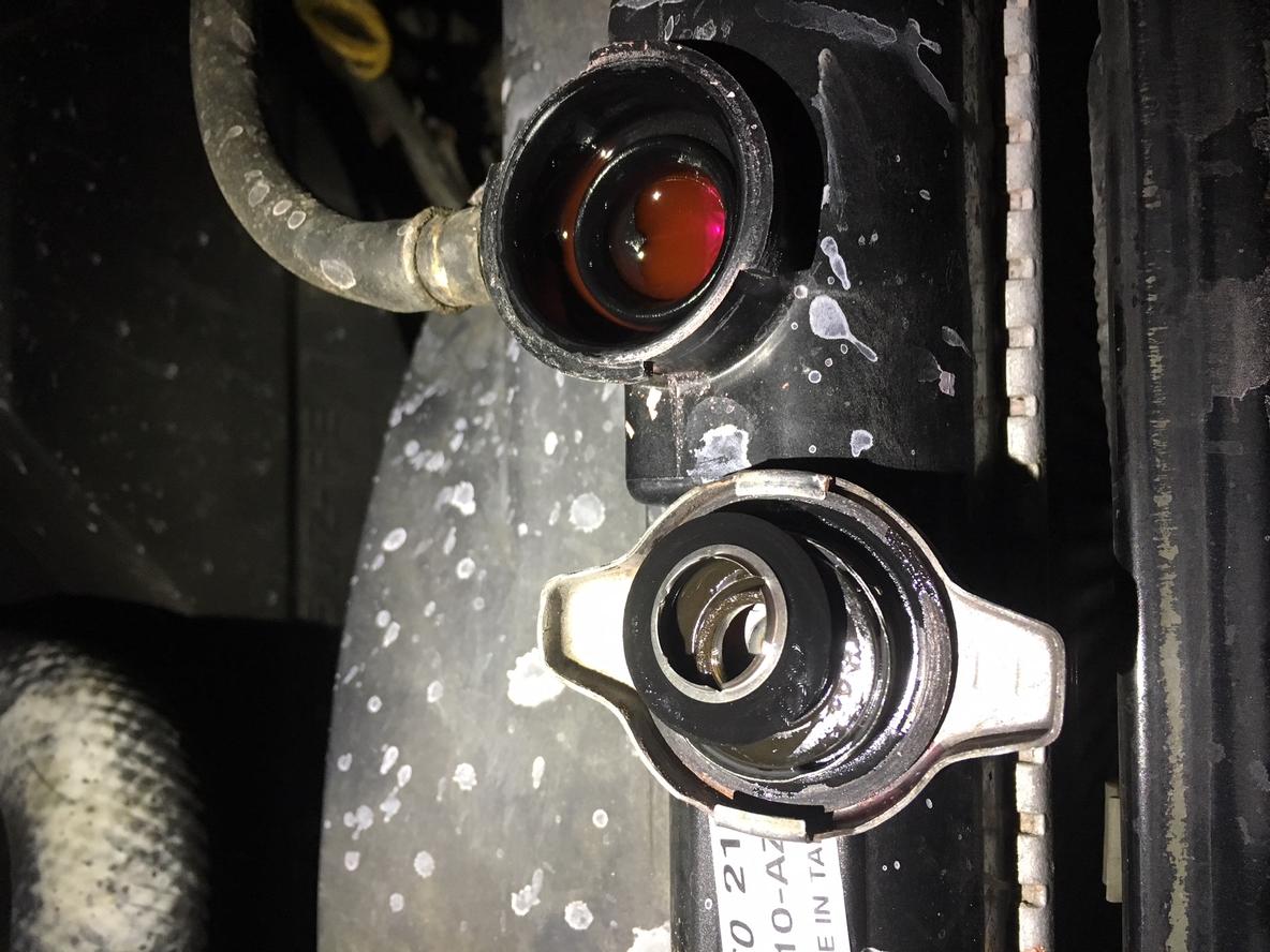

Big shout out to hopeless diamond and Tim for the advice to check my radiator cap. Just took it off to inspect and found it broken. See pic attached. My only question is, what could have happened to the spring? Hope it's not rattling around in there...
The spring and a plastic cap are inside your radiator. You could pull the radiator, turn it upside down and shake it around to get them out.
I guess they would have to be right... Sounds like I have a new weekend job coming up. Assume worst case is they bind up the water pump in the meantime?
