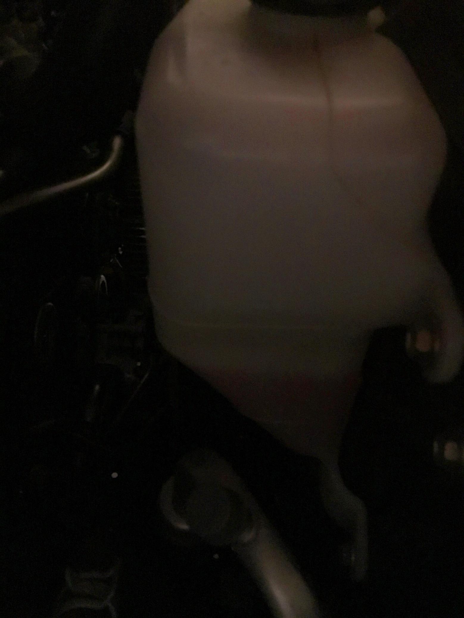

What level is the coolant in your reservoir? We would occasionally smell coolant in our RAV4. It turns out it correlated to the dealer topping off the reservoir. Once it pushed out a pint or so no more coolant smell. Normal seems to be right at or slightly below the low mark.
I would say normal, just based on my experiences driving in extreme heat, and / or off roading in mild to extreme heat. Even with new vehicles.
With that said...good on you for having it checked and even better that there were no issues!
Just checked on my 4Runner and it’s slightly below halfway between the marks. You can see there’s s huge amount of headspace above the full mark.
