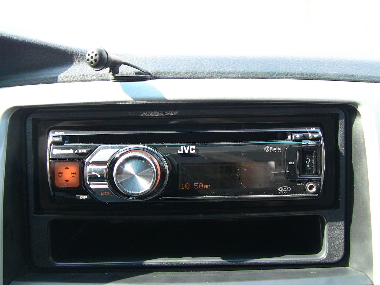

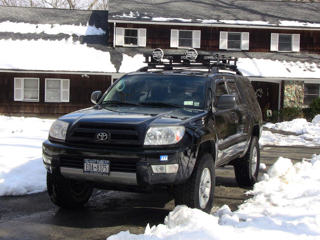

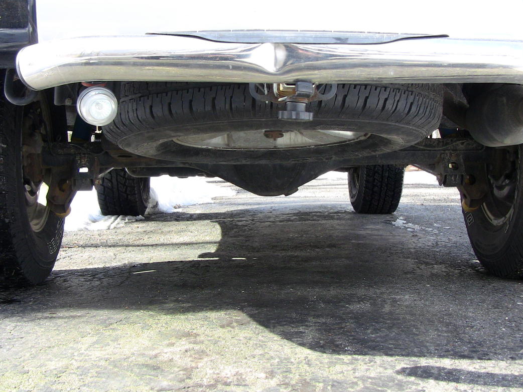

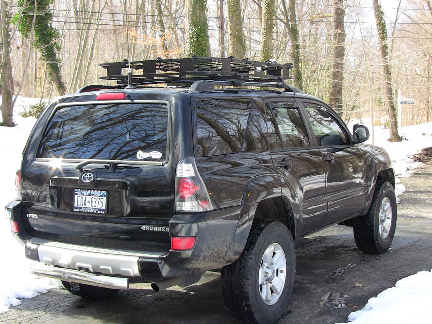

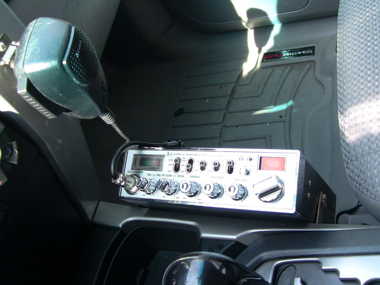

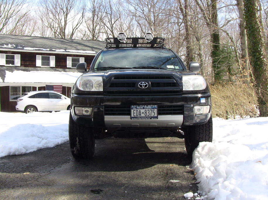

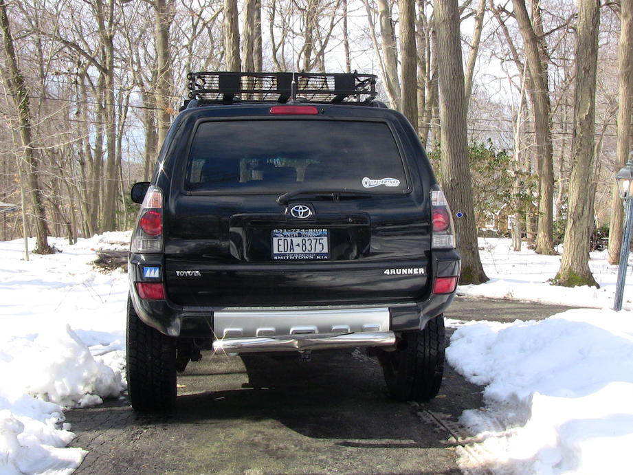

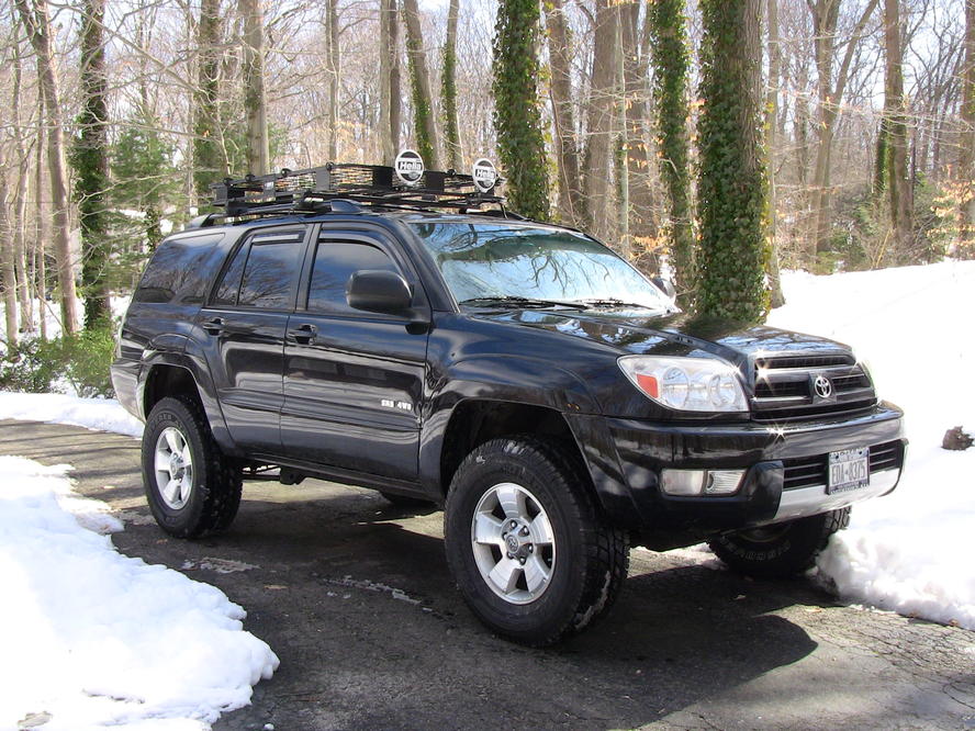

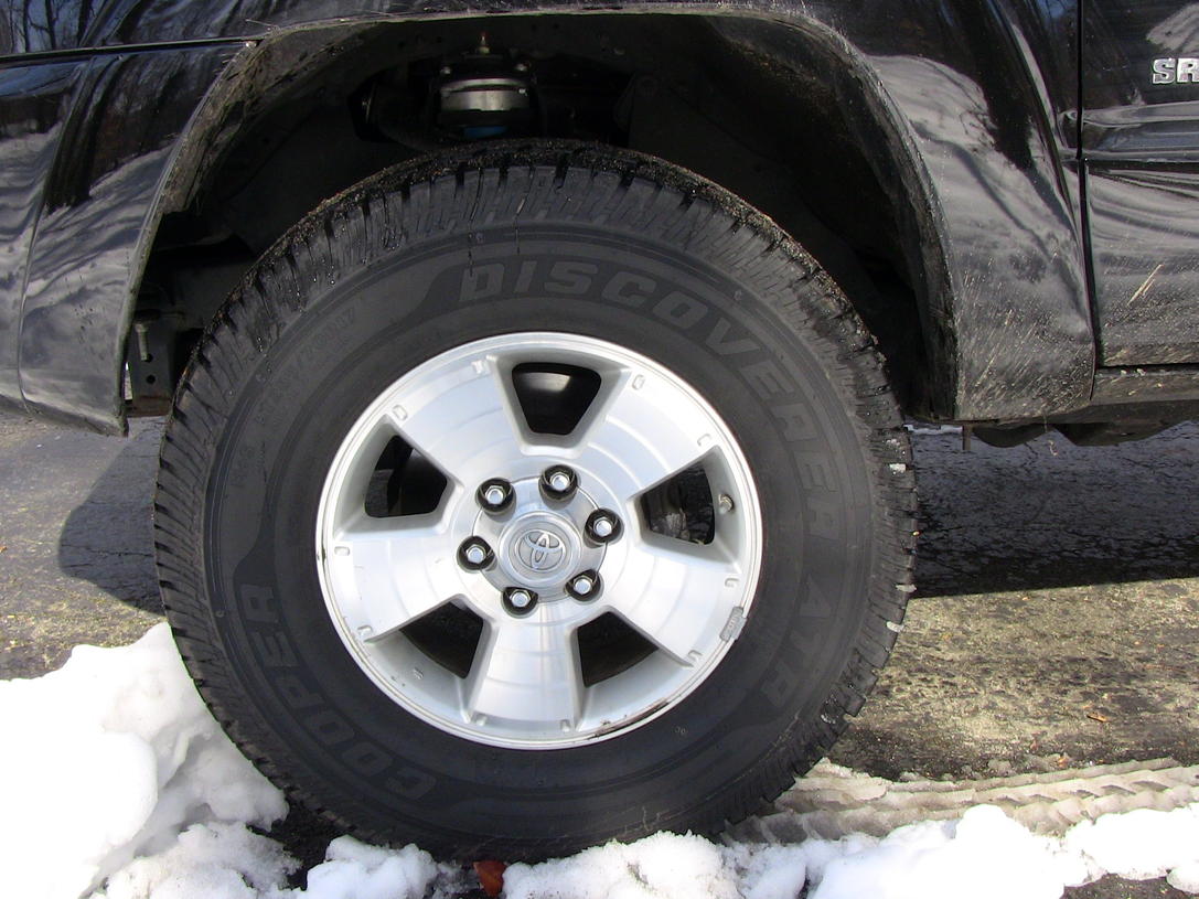

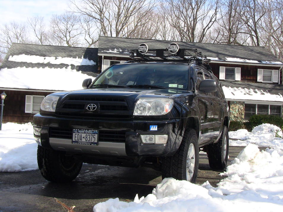

finally got everything installed last week im so happy with the lift and the mods i have done so far thanks to all the info on this forum and jason burtman for hooking me up with my lift and wheel spacers. it took me and a buddy with air tools, a lift and some excessive cursing about 2 hours floor to door for the lift. looks much worse then it really is i also installed a cobra CB and a JVC R800 deck. anyone enough talking heres some pics!!!

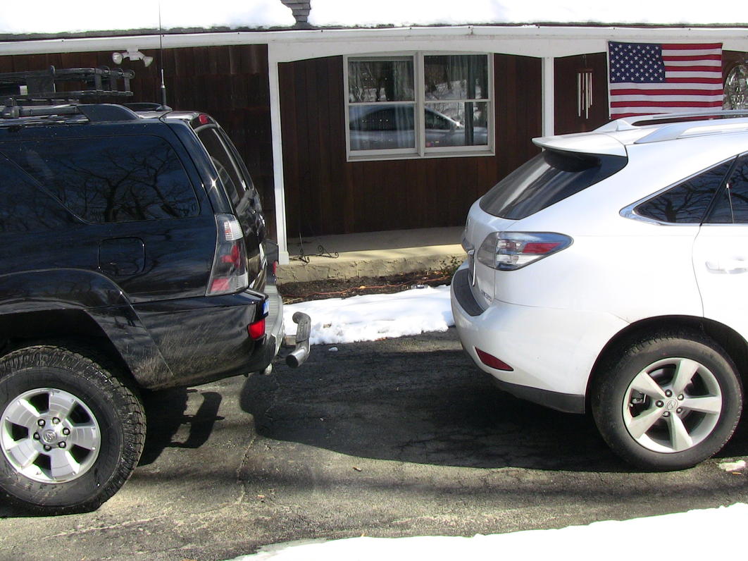

little comparision my trucks height to mom's new '10 RX350

It looks awesome! I have similar setup... Cornfed 3/2, Spidertrax, and 275/70/18's. Did you have any rubbing? What brand of safari rack is that?

I feel your pain about the lift, before I realized I needed to remove the rear shock I really was ready to kill someone to get that spacer in.

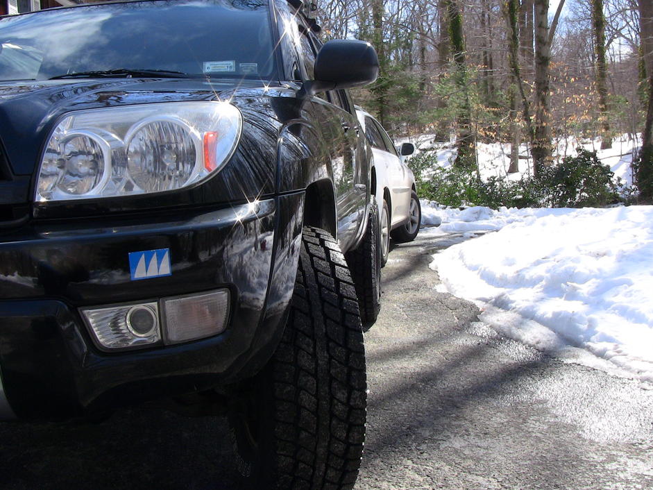

Looks good. Thats exactly where I mounted my CB, good choice. Are those 285s or 75s? Any rubbing issues?

its the surco safari rack with a sportrack net got it off amazon i cut the inner fender wells up front so i have almost no rubbing i have the slightest rubbing at full lock in reverse. but its no big deal at all. i replaced all the shocks/struts when i did the lift to get the rear spacers in all i did was take the 4 bolts out for the sway bar and they slipped right in. i went for the 285/70/17 im so happy i went with this size they fit the truck perfect!!
