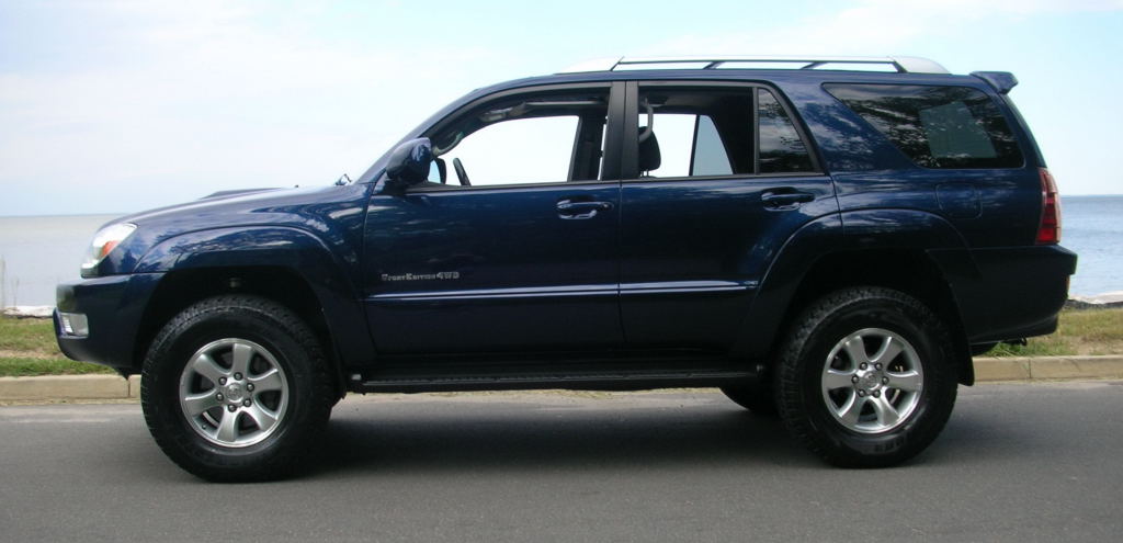

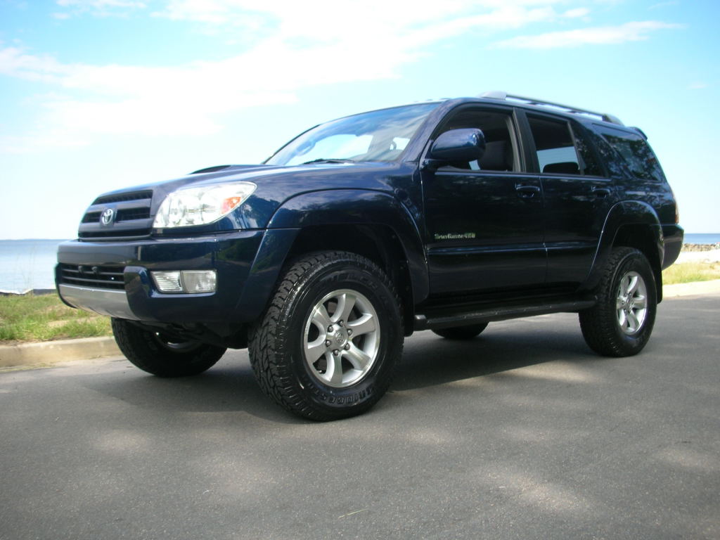

Just installed my Cornfed lift this weekend and it's a great fit! I was able to cram in some P285/70TR-17 Bridgestone Dueler tires with the help of 1/4" wheel spacers and a little bit of cutting the trim pieces in the wheel well and mud flap. The ride is not rough at all, and it handles fine. Hope everyone likes it!

If anyone can tell me how to attach more than one pic per post, I would appreciate it :confused: Thanks!
Looks awesome with the lift and tires man!!!

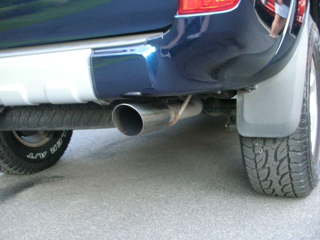

Here's the picture of the exhaust you asked for. I didn't know what you wanted to see so I just got a rear section picture.

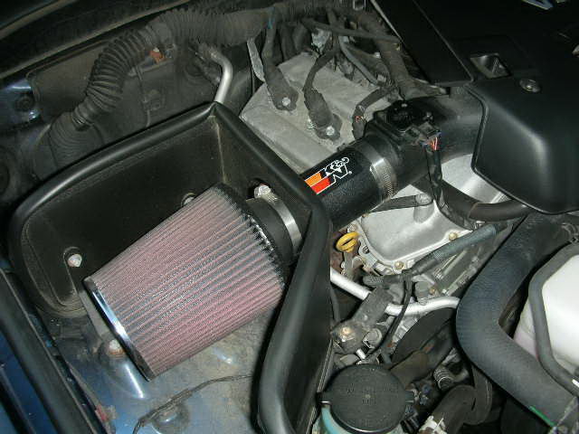

And here's a picture of the K&N Intake. I've had these both installed for almost a year and they are worth the money.
I could have sworn the Gibsons exited to the side like the Magnaflow! Oh well, proved me wrong :)
Yeah, it's supposed to. Gibson lists it as a side swept exhaust, so it should come out behind the rear tire at an angle (similar to the MF). Every picture of the Gibson system I've seen has it exiting the rear, though. I may try to contact Gibson and see what the deal is.
