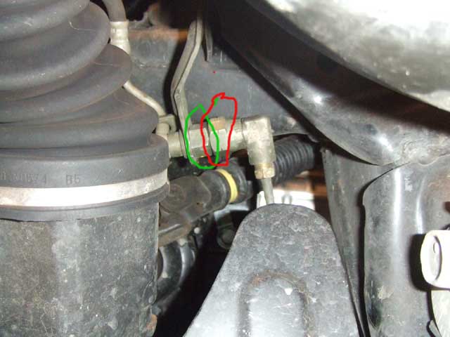

here they are:
this is where to diconnect the x-reas line.
looking up from the bottom. use the CV boot as a guide on how to locate the line. you need to use 2 wrenches to securely loosen the 2.

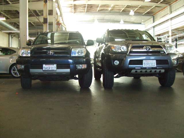

side by side a stockie 4 runner.
i was parked such that i was in a parallel with the other 4 runner by the outside mirror.
i went with typical 265/70 revo... combined with the wheel spacer from a while back makes the rubber flush with the fender.
i get some rubbing in reverse and near full cock, so i guess i should of gotten 285 since i'll be needing a trim anyway...
i might try to use a heat gun and re-mold the spash guard... see if that might work.
Is using the spacer what makes it rub ?
I would think with that much of a lift it would not even come close. My 265/70/17 never rub off or on road with my suspension stock.
Awesome truck!
265/70/R17 that equals to a 32" tire?
So would a 285/70/R17 give a higher stance still?
the spacer moves the wheel out...as it is now, my 265/70 BFG's are close to fender plastic when turned...I'm thinkin even with a 2/1 lift then adding spacers I'll still get rubbing....I guess I can try...lift first though!
My Revos are close too , but honestly never rubbed. The BFG has a much more square shoulder and that night add to it too. If you dont do spacers you should have loads of clearance. The spacers do look good though.
mole177 said:
here they are:
So hold the red and turn the green nut right?
Nope. The opposite. Turn the red. If the bracket is still attached, you don't really need to hold the green either. It's not that tight. I used a large crescent wench. My biggest open ended wrench is a 20mm and this must be 21mm.
