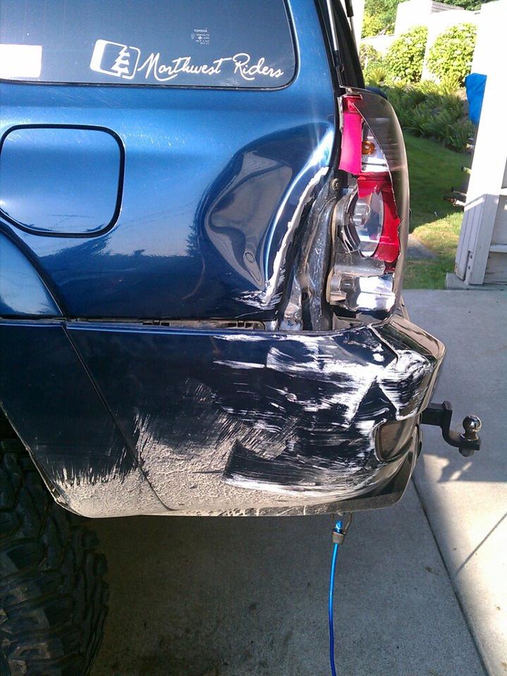

Here is a pic of what I dealt with last week LOL :ybrick:, a crisp 1500 bones!
