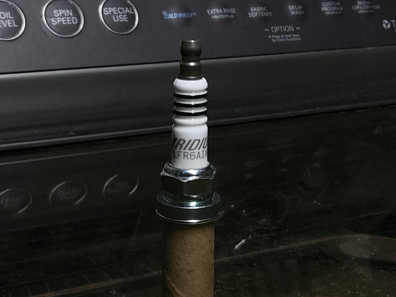

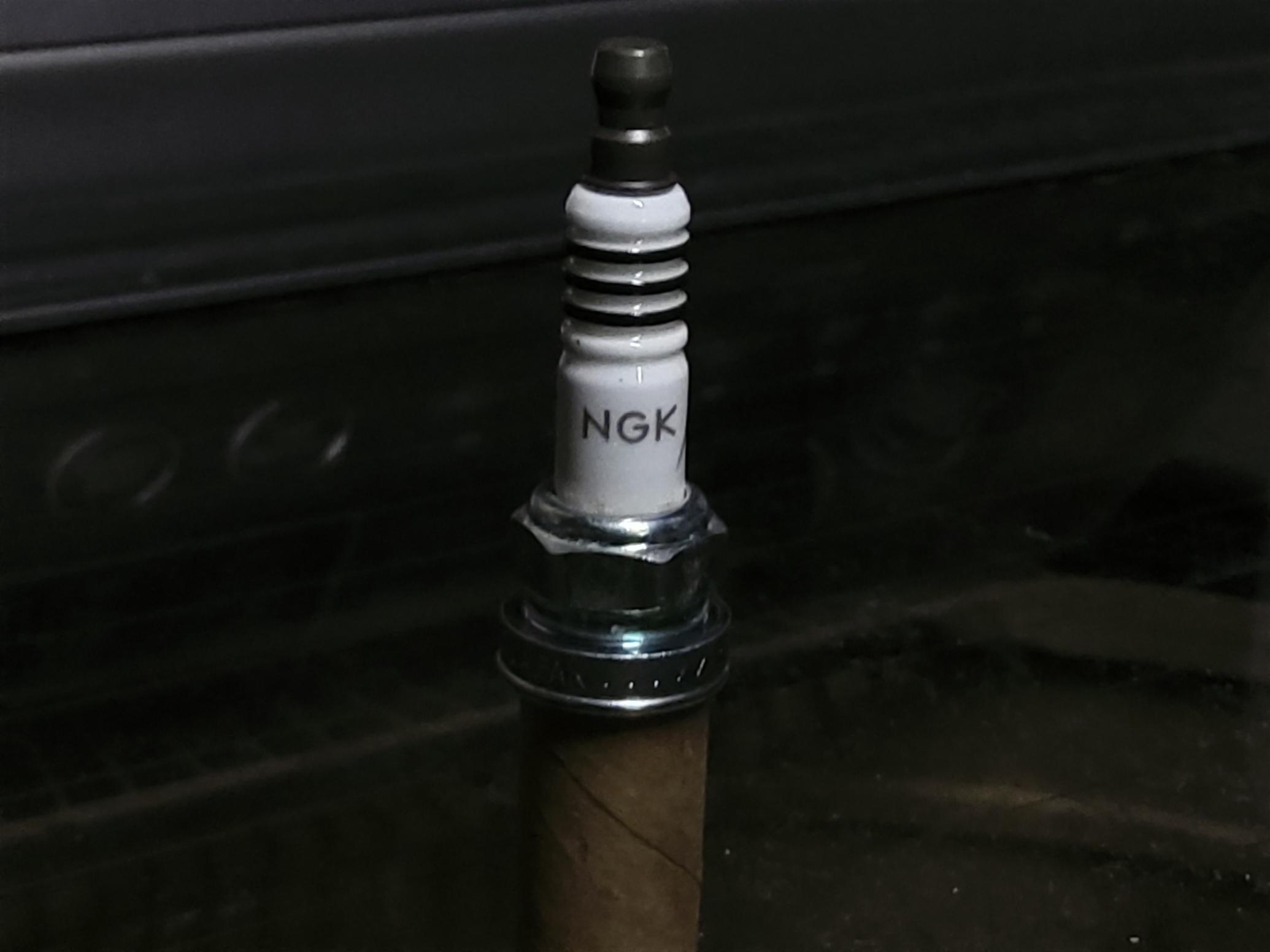

I just pulled these today. Orilleys bought, about 3yrs ago.

Here's a topic about fake Denso Iridium plugs with photos of both the real and fake plugs side by side, also observations of the differences, the fakes were bought off eBay, the real ones came from Rockauto.

Based on that PSA post, I am not sure what I have.
I recently changed my plugs on the 96K mile V8. It was idling a hair rough compared to my other one. After the plugs it still doesn't seem as smooth as the higher mileage one.
The plugs I pulled out look a lot like the "fake" ones based on the text style. I bought it @94K miles and there was no record of plug changes. The clean one is from Rock Auto from around Octoberish. The ceramic looks more like the fake one than the "real" one. The font matches the "real" one though.
