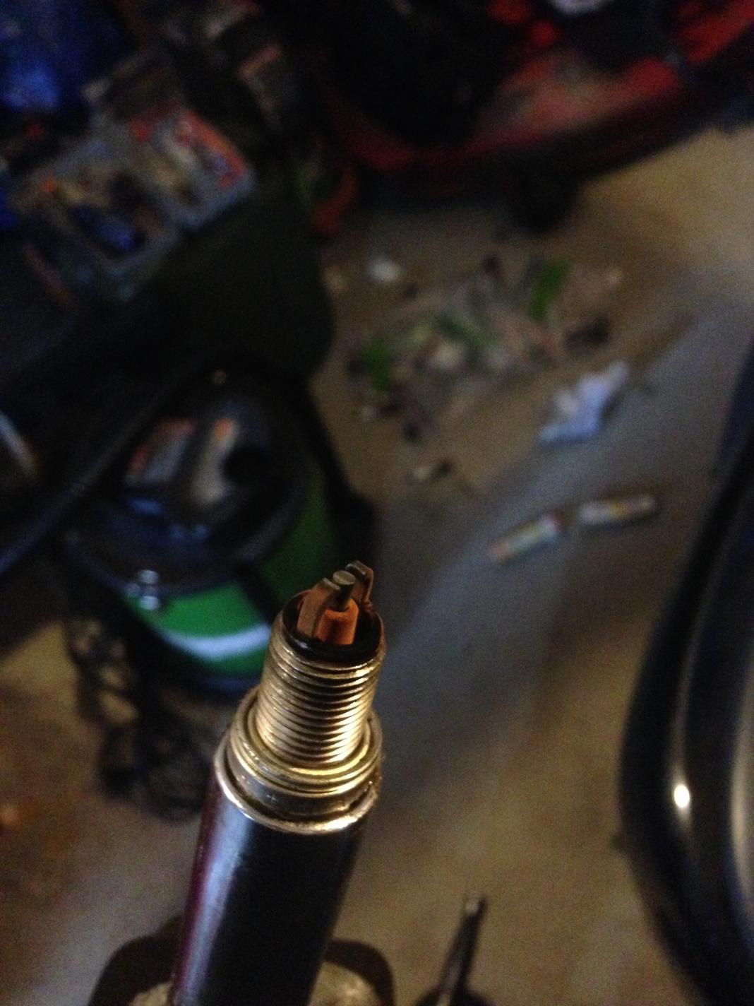

So, I've done bunch of research... and I'm just looking to see what you guys think... Here's the deal:
I installed a gen 1 super charger in great condition off a forum member about a month ago. I'm running no fuel mods, just the "free fmu". I had already done the ISR and deckplate mods. It runs great from 0-65,70... then seems to need more fuel...acceleration after that can be described as sluggish at best. On the highway I keep getting the p0171 code. Ive done my homework, and I've checked the usual culprits yesterday. Throttle body trd gasket installed correctly (really only one way you can put it in). Checked my vacuum connections... all seem correct. Cleaned the maf. I also changed to the IK22 plugs... when I did, I was a little concerned with what I saw on the old plugs (see pic) keep in mind these plugs only have about 1500 miles on them! Should I be concerned, and are my highway symptoms normal for running no fuel mods?? I started the truck yesterday, and no codes or pending codes popped up, but I don't want to drive it today as their is too much salt on the roads.... Let me know what you guys think... thanks in advance.

Hey, the P0171 code is the same one i get on occasion. It is a lean code from fuel starvation. I did the same as you and checked all my lines and connections and gaskets and smoke tested my rig three times. There is no leak. Mine did it a BUNCH when i first installed the supercharger and as the computer adjusted--as much as it could--it started coming up less and less. Now i get it only once or twice every few months...Along with my STUPID charcoal canister codes. :violin::bash::frusty: You're fine to drive it and not stress as long as you have verified that you have no air/fuel leaks.

Try removing the EFI fuse and relay to allow the computer to reset. Then drive it around for a week and see how it does. Mine took about 2 tanks to level out. Also, the surge you are talking about...Is it when you go from hard or medium acceleration to no throttle? If so, then again...thats the lean condition. Im betting what you're noticing is the surge after throttle input where the rpm's dips then bounces back up a bit. If so, thats normal and thats where the "Part throttle boost enrichment" compensates and rids you of that. The 7th injector is built to compensate for many things , that being one of them. This is straight from URD's website.

Trd got rid of the fmu (not the Feild monitoring unit... The Trd fuel thing) on the second gen as it wasn't with out flaws, and the later model 3rd gen ecu' are supposed to "learn" better than the earlier years. (In terms of adding fuel when needed)That said I spoke to a toyota mechanic who has had the same sc on three different vehicles and he swears by the Trd fmu. He told me to find one on eBay... So if you have it, install it, and see if you can save some money... Worst case your back to your original plan of buying the 7th.
So as an update to my initial post.... After cleaning the MAF and throttle body, tightening some vac connections, and changing to the ik22's the truck runs so much better... Knock on wood... My acceleration at highways speeds is linear and the surging and hesitation seems to have disappeared! So pumped! So far, no p0171. Again, knock on wood!

Looks like you've got your problem taken care of. But if you still want to take a peak at your AFRs, you can look at your front O2 sensor readings. You've got Cali emissions, so you have a wideband O2 sensor up front, and you can look at the voltage it reports to see what your AFR is. Check out the write up in my signature for more info. If you don't have an iPhone you can do something very similar with Torque on an Android phone.
