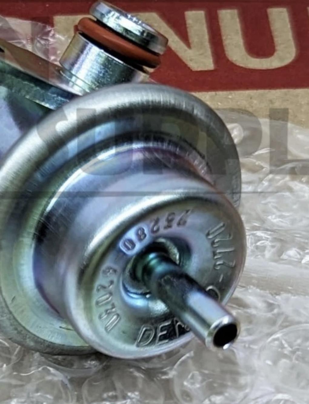

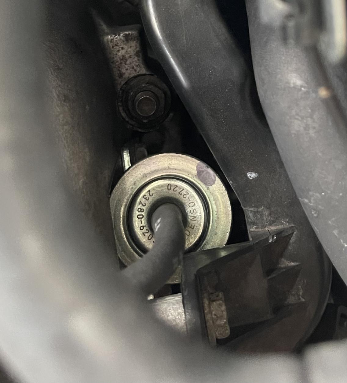

I apologize, it runs into a hardline under the manifold then to the intake tube. Does this look like an OEM denso? Something about the font looks off… maybe im running a shanghai special…..

Compare the font to this one…. Can anyone take a pic of one off of their truck to see if I am crazy?

Did the box the FPR came in look like the one pictured here? It isn't a 100% indicator but would definitely raise suspicions if yours didn't, or if the font on the packaging looks a little different.

It definitely did NOT come in that kind of box. It came in a red and white “paper” box. Not that thicker cardboard. I still have the box it came in. What is the consensus here? Assuming this is a chinese part, could that be enough to jack up my fuel trims? I am not sure just how sensitive or critical that component is

China can make good stuff, usually not when they are making counterfeits though. Yeah, I found more pics of some FPRs on sale that ship from Dubai. They have the more traditional Denso font. I think you have a fake.
I agree… that partsouq one looks legit. Might just go with that one. I appreciate the insight. Something about the denso logo just looked….. off. Welp get to have another fun go at getting the manifold off. Ill let yall know if that fixes it

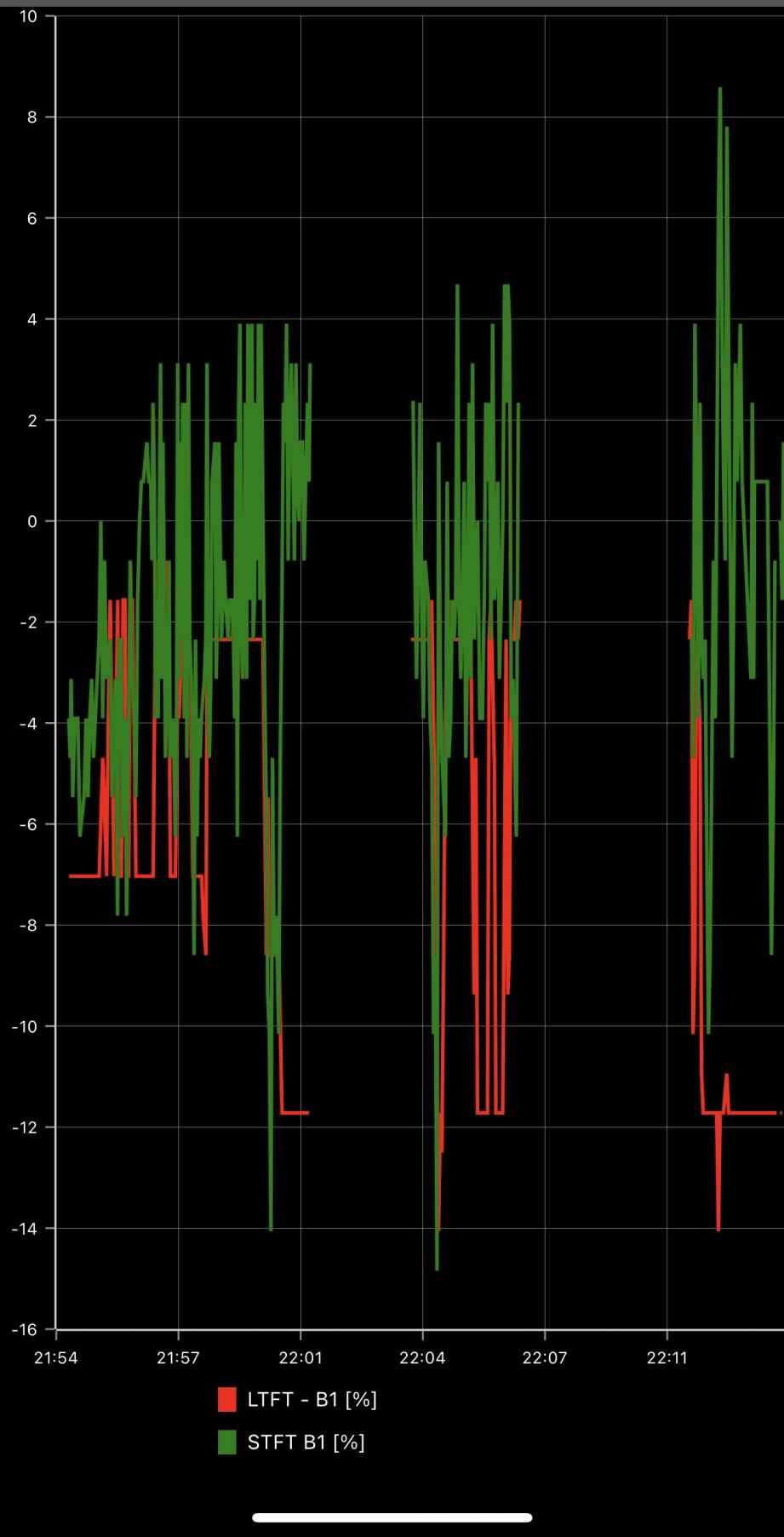

New FPR is in…. and while I definitely had a fake one installed before, the new one isnt performing much better. Data showing still around -11 LTFT, I will put a picture of the data from my drive today. I am just stumped and tired of firing the parts cannon. Calling on all of the gurus in here for help….. she does drive just fine, I just want to know what the heck is going on.

Hmm. I'd still call it progress. Funnily enough I just had Motorwest Injectors installed on my 1998 Limited. And it just threw a P0420 code. Gonna check my fuel trims.
As luck may have it, my LTFT was at -10.9%. I've got a recently installed JDM engine and I had Motorwest injectors put in. Now, I might have fouled O2 sensors from the previous engine's coolant consumption, and I also do have a bit of an exhaust leak, so I wouldn't let my situation completely throw you off That said, I did come across this thread.

I am pretty sure I have a small exhaust leak too, either at the headers or crossover pipe. It definitely could be throwing off the O2 sensor but -11 is pretty dang rich. Mine is running rich as can be at idle and deaccelerating and braking. Under a load trims are great. I might take one for the team and rebuild the old injectors. Before that im gonna hook up the shop vac to the exhaust and spray the headers and crossover pipe for leaks….
