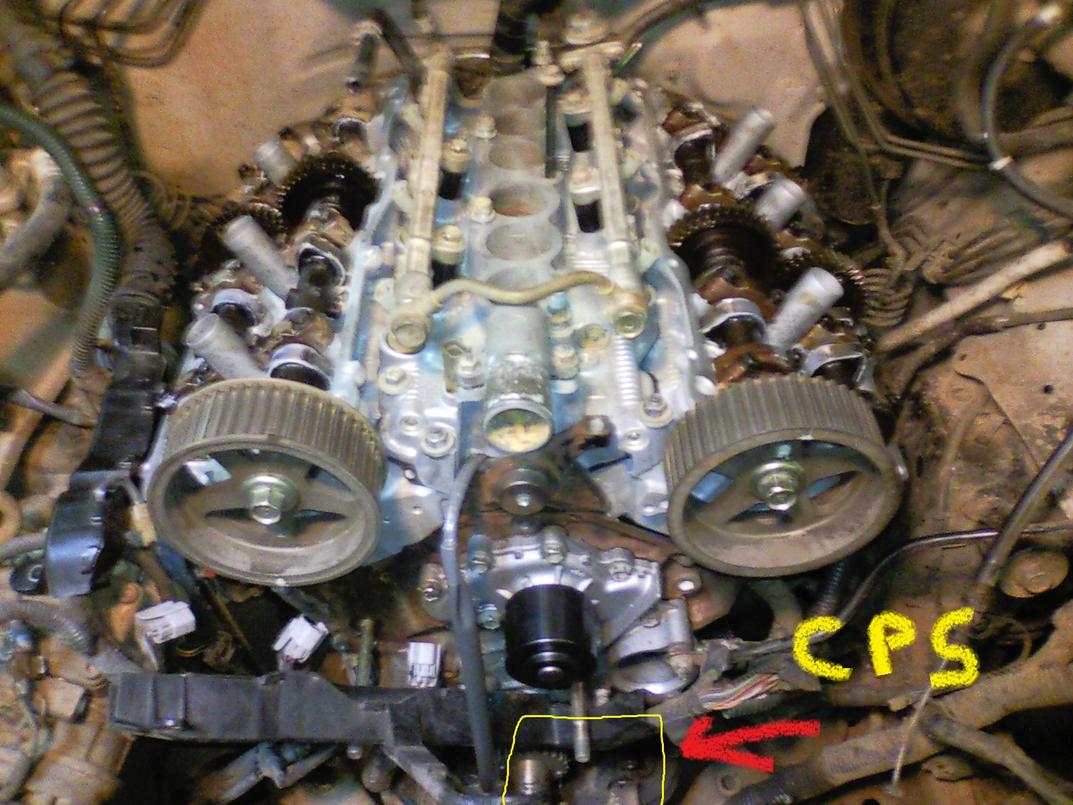

Im going CPS hunting at the yard. Is there a quick n easy way to get to the crank position sensor?
My vehicle isnt here.
my FSM doesnt really show its relation to fully assembled
couldnt find it in this search here or google
had a yard tell me they had them if it wasnt the one under the intake?
what does he mean by this.
It is technically under the intake
CPS is on bottom in front of oil filter next to lower alternator bracket. Don't confuse it with the oil pressure switch they are close together. CPS is located right next to the harmonic balancer on the driver's side bottom.
here you go!
