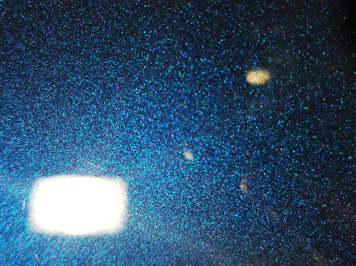

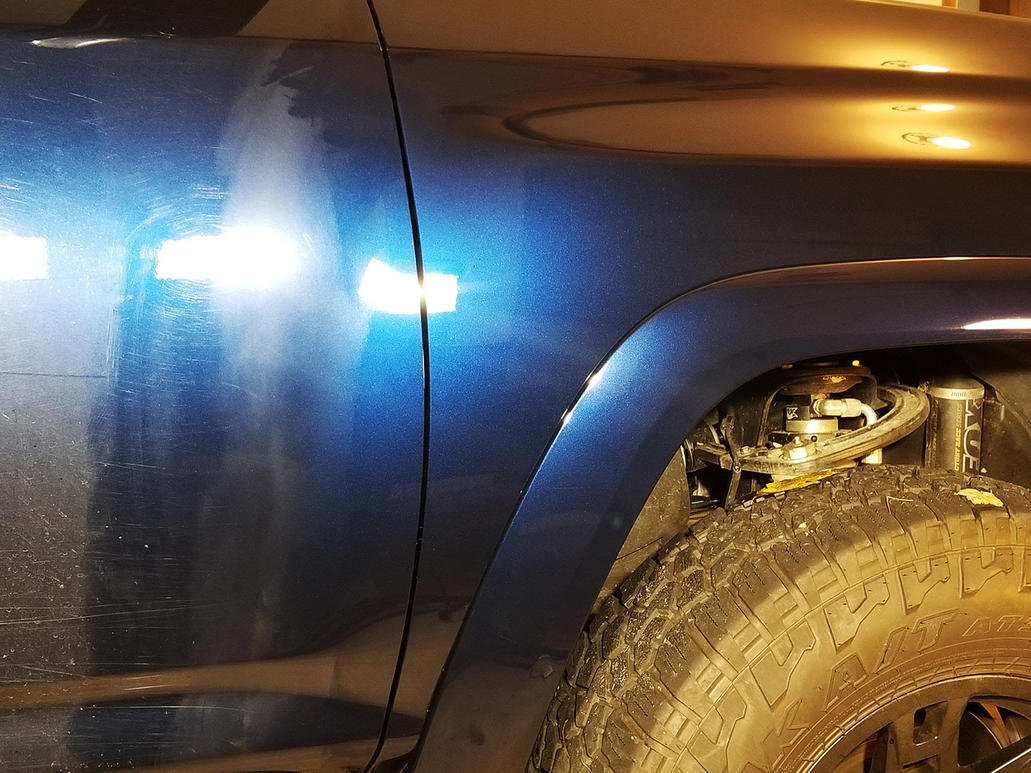

7. Applied CQuartz UK 3.0. Total materials $70. I've done the entire front and have used about 1/8th of the bottle. I had watched a few youtube videos and assumed they made it look easy but I have to say, it is easy. Humidity is very high right now due to the rain but temps are in the high 40s in my garage. I just applied it in criss cross pattern in big 2x2, sometimes 3x3 chunks and waited about 2 minutes and then buffed it with the supplied cloth. I then moved onto the next section. Once applied I revisited the previous section and gave it a final buff. At times it looked very streaky but as you level it out with the buffing it all goes away.
It has been curing now for a few hours and I'm honestly shocked at how beautiful the results are. I'm seeing colors in the paint that I never saw before like jade green. Here are some shots. I was able to clear all of the deep scratches and swirls with the VSS. We drive through all kinds of $hit. After the VSS it looked good but that dang menzerna final polish REALLY set it off. Applying the CQuartz was almost like laying down a coat of luscious gel. It filled in very slight spider webs that I didn't catch with the polish rounds and made it look dripping wet. I was waiting for that effect to dissipate but it hasn't, it just stays wet looking.
