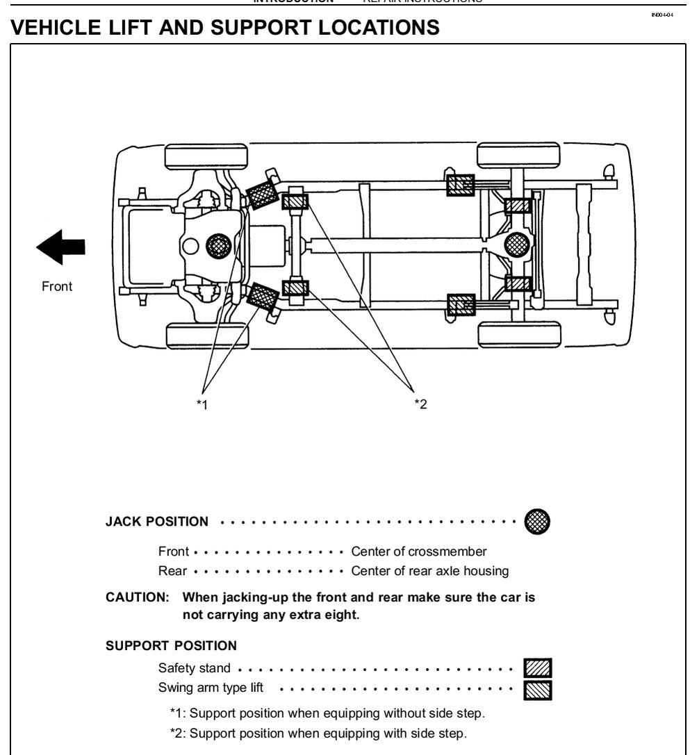

You can jack it up in the center. You were just to far forward.
