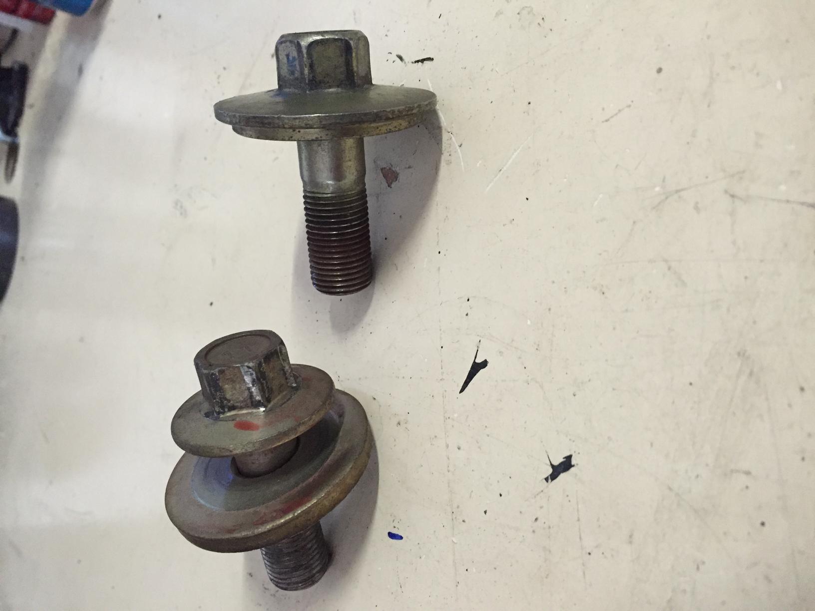

I know this is an old thread but my crank pulley bolt just came loose so I thought I'd add my 2 cents. Cost me a pulley from a wrecking yard for $200 and a new S/C belt and bolt. My research has shown that the bolts are physically different as well. The 217 torque bolt, new style, has a thick floating washer. The 184 torque bolt or older style has the flange actually PART of the head. One piece.
(217 on the bottom, 184 on the top)
Hope this helps somebody some day.
