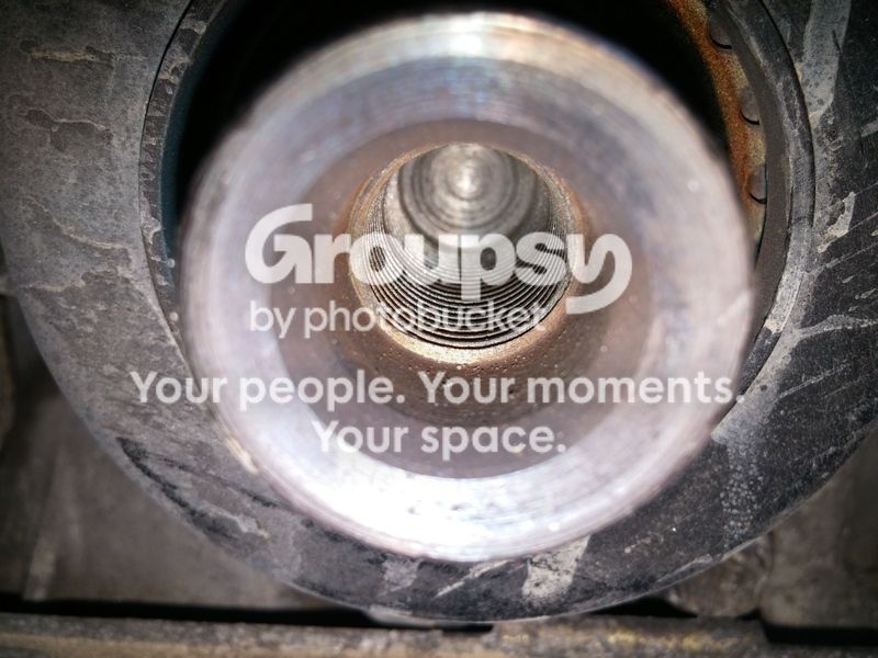

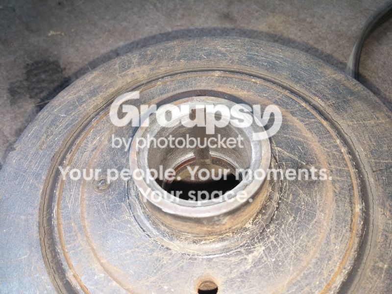

Here are some pics.
Im starting to think its not as bad as Belle Tire made it sound. Im thoroughly convinced that its just the woodruff key. can that be replaced w/o having to remove the engine???
Yep, and a new crank bolt from the dealer. How do the drive belts and timing belt look? The crack in the harmonic dampener (balancer) is less than inspiring but should work OK.

Crank snout looks good. Need a pic where we can see the key slot--be sure it's not wallowed out. If not, you should be good with bolt and key, although a new Harmonic Balancer would be ideal. The slot almost certainly is OK, since the key only engages the pulley for like 1/4". Most of it is buried under the sprocket which appears to have stayed in place, since the engine kept running. The key likely sheared off at the sprocket. I would think you would have to pull the timing belt to get the sprocket off so as to be able to put a new key in under there.
