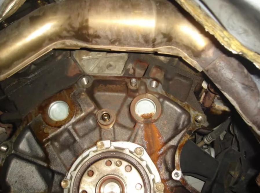

I believe you've got it. I had a chance to get way up underneath and watched as it leaked, and the leak is coming from a hole (looks like it's designed to be there) in the lower bell housing flex plate cover, passenger side.
As you say, I think the culprit is the passenger side rear freeze plug in the block (point A) because where it's leaking is just off center underneath it (point B). See below. Unless it's the block itself, but I hope not.

Parts like those rust from the INSIDE of the motor if coolant gets old...

I put my 4 runner on the lift and pin pointed two freeze plugs with leaks but there was another trickle quite possibly coming from freeze plugs that cant be seen.
