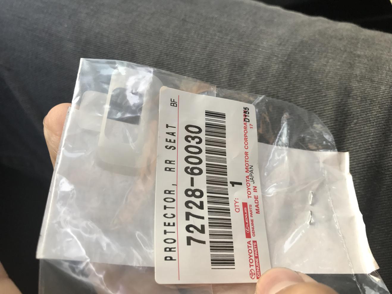

Just picked this up gonna have fun this weekend
