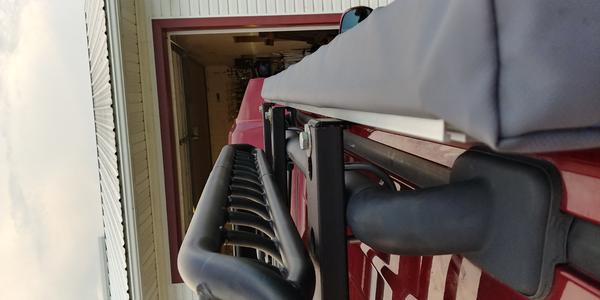

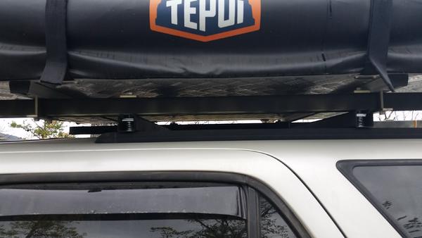

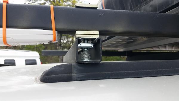

Some uni-strut plus some appropriate pipe-holding clamps may make some very beefy DIY crossbars. The photos are to give you ideas. This was a guy parked near the trailhead at Linville Gorge a few weeks ago.

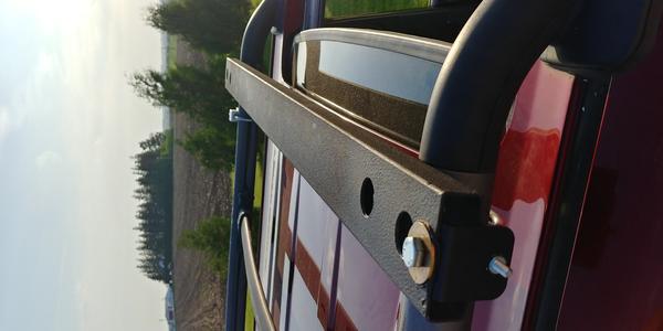

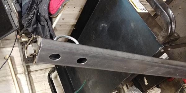

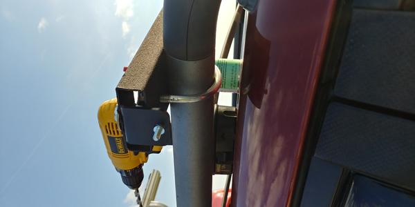

Decided to go the DIY route. Picked up 6 ubolts and 3 4' long rectangle steel and did some measuring and cutting. Here's what I have planned. I'll post up finished product when l get them done.
