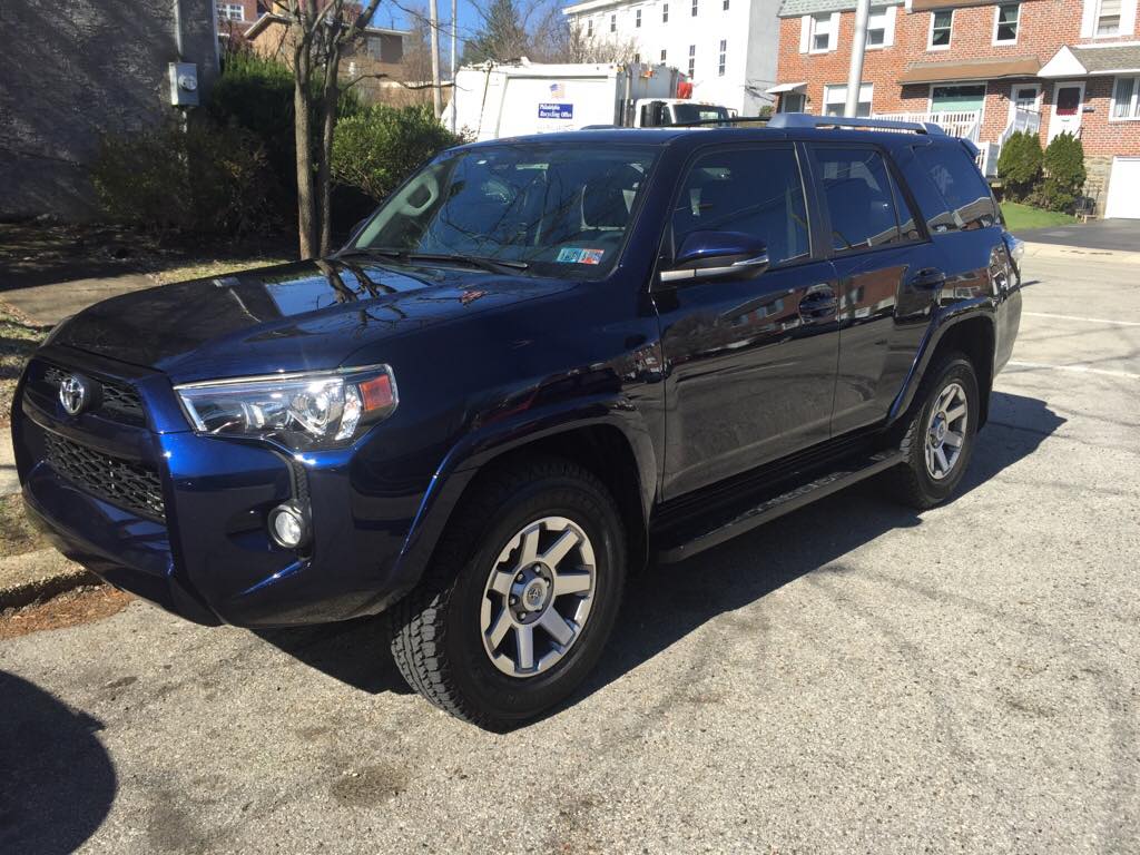

Is this a new ride for you? Looks great. I am really liking the color too as it looks different in different light conditions.
I bought it July '15. Bought my wife a white SR5P in March '15 and liked it so much I traded my Yukon Denali in on this a few months later. I owned a bunch of 3rd Gens previously.

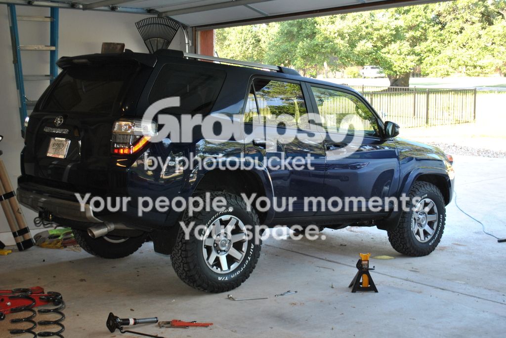

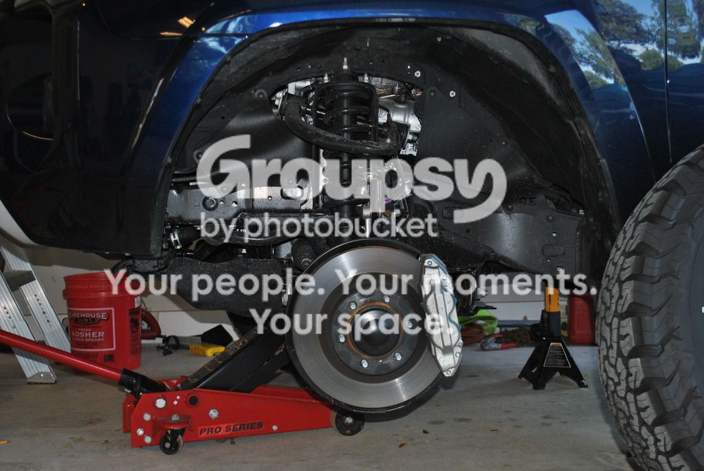

Well I decided to go ahead and pull the trigger on a introductory lift. I didn't necessarily want to go all in at this time and spend tons of money right up front as I wanted to take this build slow and steady and enjoy a semi close to stock ride for a while.

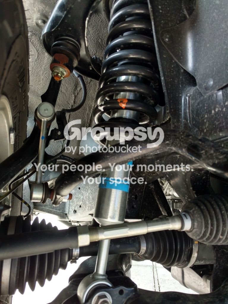

Front: Bilsteins 5100 adjustable shocks set at 1.75" with my stock springs.

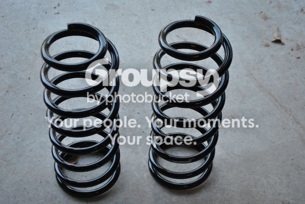

Rear: Toytec SuperFlex 2" Coils with stock shocks. RCC2.0 - ToyTec "Superflex" Rear Coils (FJ & 03+ 4Runner) I probably will need to go to a longer shock to really utilize the flexiness of these

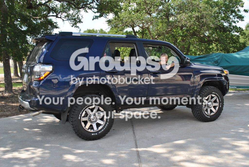

The rear will sit a bit higher obviously but with pulling a boat and loading it with gear on trips I like the idea it can compress a little without sagging. The front change was not as dramatic as I thought it would be set at the ~1.75" notch. I am certain the rear will settle a bit and it will look pretty decent within a couple weeks.

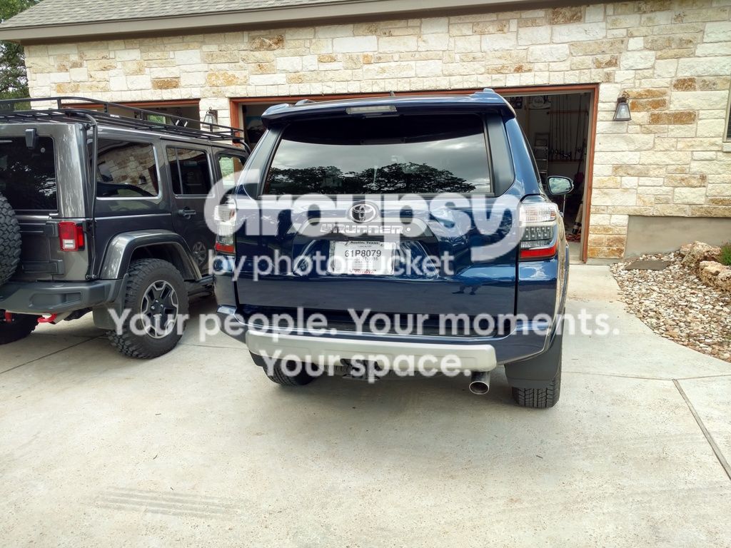

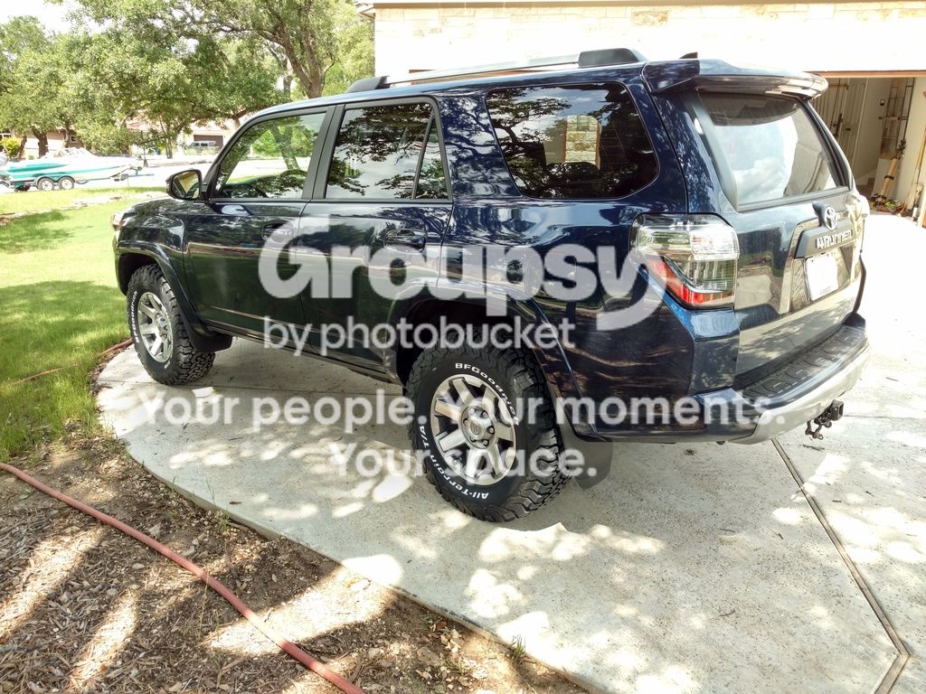

New SuperFlex 2" coils
Rear Installed

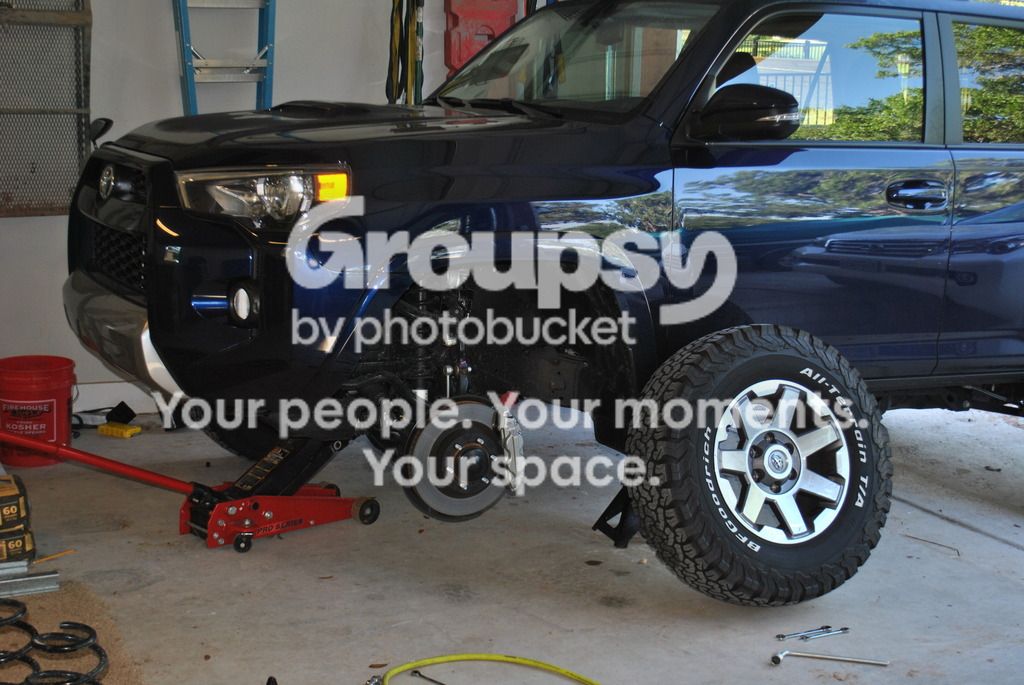

The 5th Gen is a little more of a chore to lift the front than my old 3rd Gen. The sway bar and the Tie Rods are pretty much in the way and I had to disconnect them both. Simple removal but just one more step.

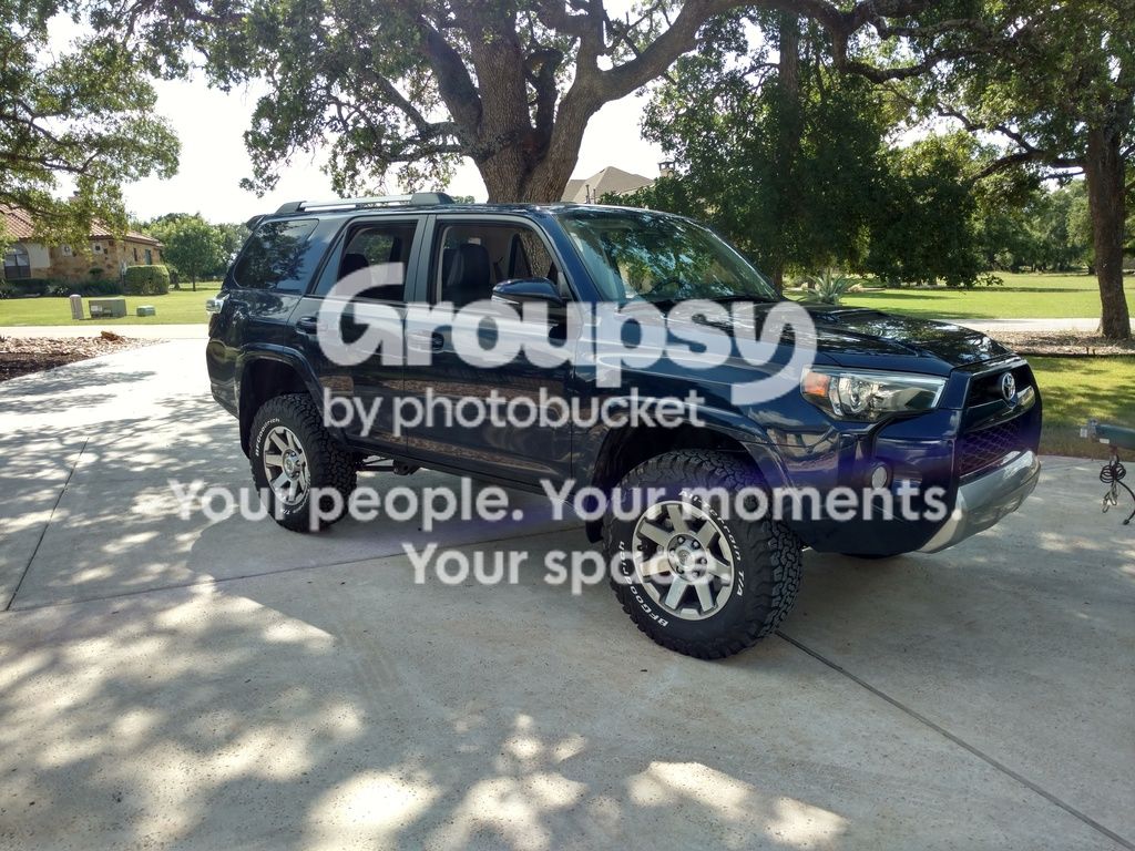

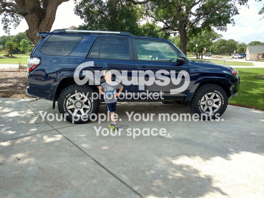

All done with an ecstatic son!
I feel like this is a great lift height for the tire size I have on (275/70) and am pretty happy that it is subtle yet functional.
Looks really good, man. Did you measure to see how much actual lift you got? I've always been a fan of a little bit of rake so i think it looks really sweet. And the tires are a great size.
How do the Billy's feel compared to the stock shocks?

Thanks Camp. I didn't measure a before and after unfortunately! I can go measure the front and rear later though. I think the rake looks pretty decent too.

My ride is almost exactly the same after installing the lift. REALLY pleased with it as I felt guilty doing anything to it being so new. The nose doesn't dive as bad as it did stock and I have a tad bit more feed back from the road on the front end. The rear feels plush and smooth.
how much of a chore were those rear springs? I am installing some SAW 1.5" coils this weekend. Rig looks great, I dig the 3rd gen!
Thanks Simpleman! I will miss the 3rd gen.
The rear was really straight forward. With putting it on jackstands and taking the wheels off it took a little over an hour.
Place rear of truck on stands on the frame.
Undo the shocks top nut and sway bar end links with the axle supported with a jack and then let the rear down. I used another small jack to offset the axle angle and the old spring fell out and then squeezed the new one in there.
