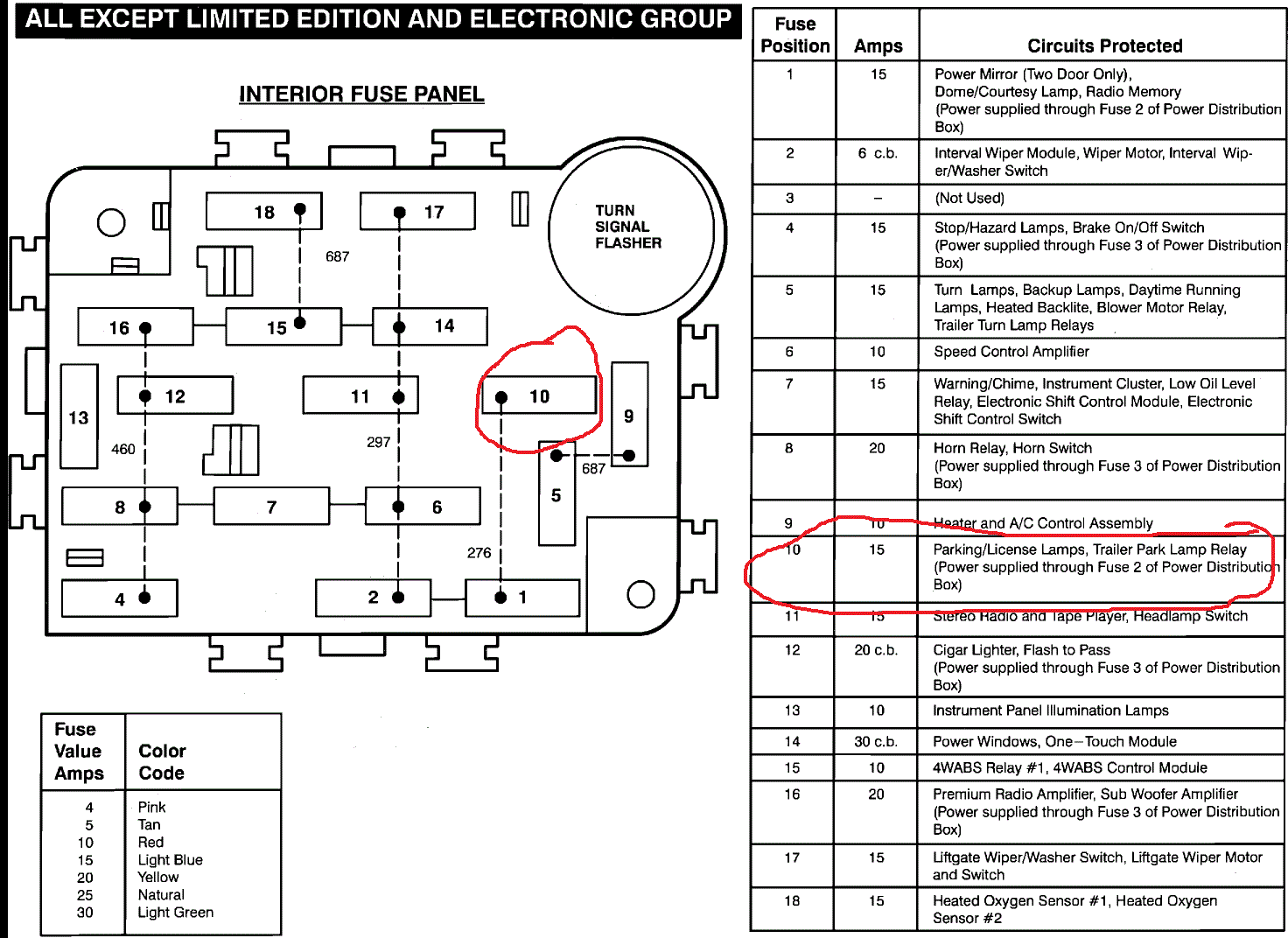

Hello all, I have a 2012 SR5 4x4 and ever since I got the truck (~6 months ago) the cruise control has not worked. When I hit the stock to turn on CC the dash light doesn't even illuminate, my first thought was maybe the bulb burned out but even after trying to turn it on and initiate CC as if the light did turn on it still does not work. I checked for fuse diagrams and nothing that i've been able to find says anything about any fuses that have to do with CC. I'm wondering if maybe the stock itself is bad or if it is something else. Everything else on the truck seems to work perfectly fine so it doesnt seem to be linked to another problem.
Would appreciate any insight.
Thanks.
Fuse 6, interior panel (speed control amplifier) maybe? Ignore red lines.
Make sure you dont have traction control off. Cruise wont work with it off. Also if you have a broken abs sensor or other peice that setects wheel slip it, the cruise will nit work
