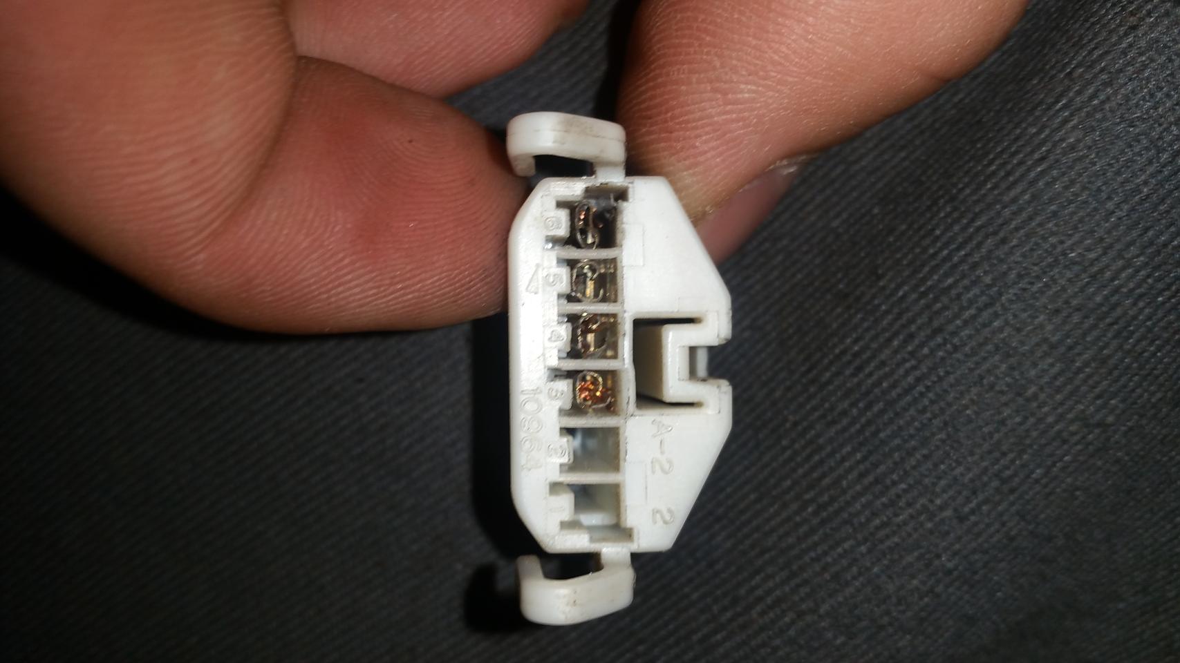

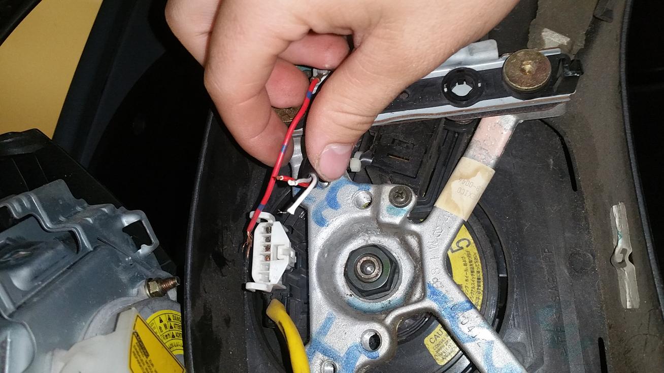

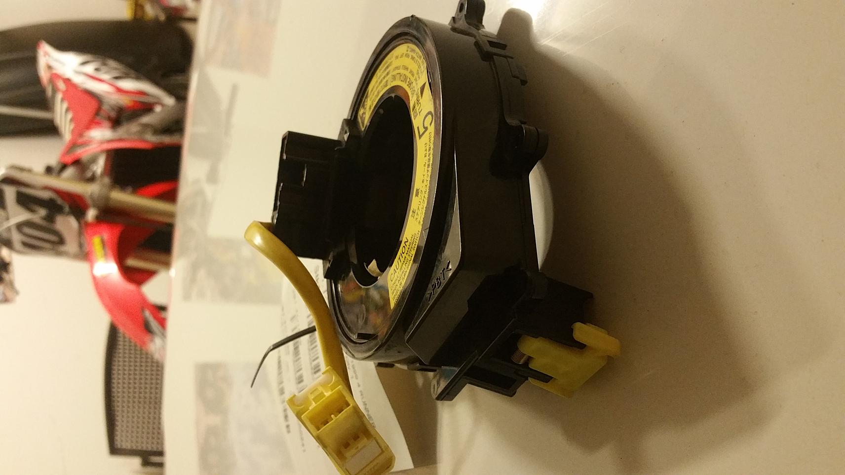

Cruise Control issue some peoole...
So some A hole previous to me or before the guy I bought it from decided It was a good idea to rip out the wires to the plug on the clock spring so my cruise and horn don't work and being dumb I just thought I was the clock spring wires ripped inside so bought a used one on ebay for 30 bucks, so I take the airbag off and find the wires are ripped lol instead of just unplugging it,
where can I find a new/used cruise control thing with the wiring and whatever else I need and can just recrimp the one wire on the wheel to the new plug? Any help would be great thanks!!
